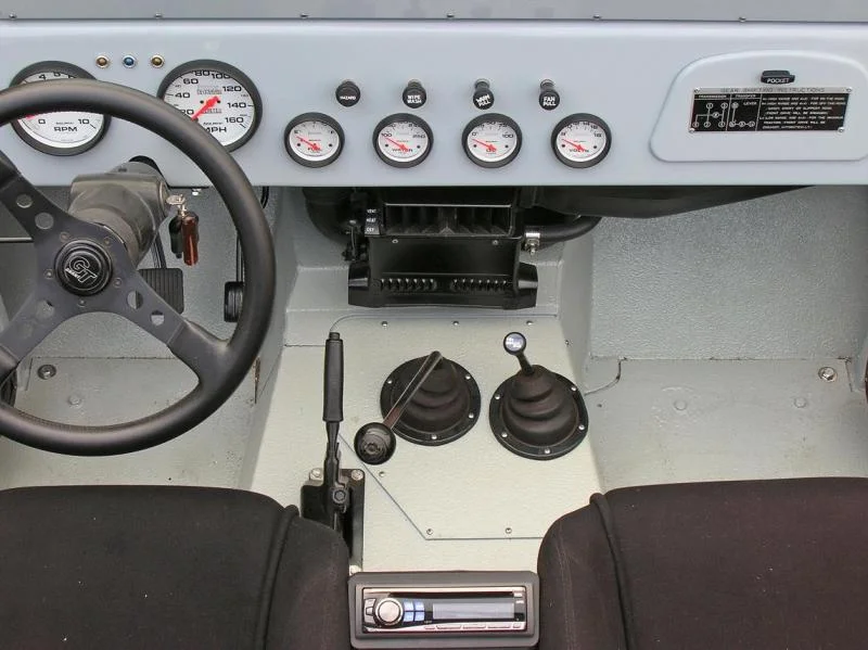

Very nice Dom. Similar product, same great results. Really improves the look of the dash. Picked these up at a local craft/hobby store (Michael's).
