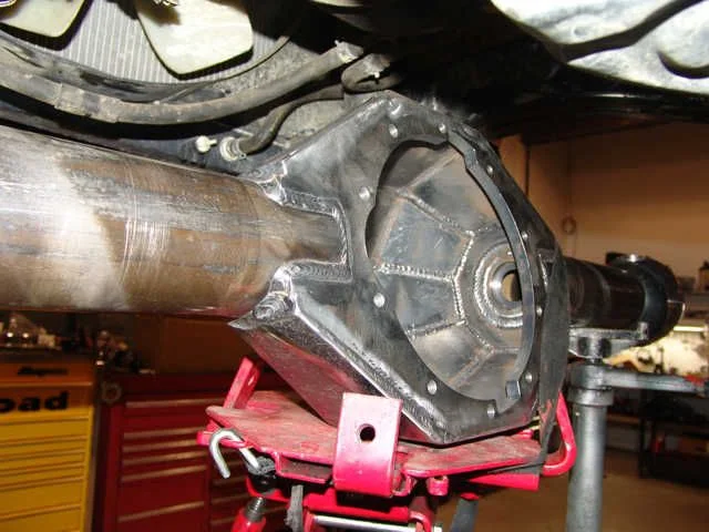

Another one.

Coil springs?

Yes,

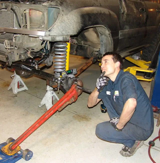

Today Joe set the caster Big Wheels, Big Monkey Wrench, or otherwise known as a baboon spanner in South Africa.

holy god...that is...huge!

Quote:
Originally Posted by Greg B View Post
Looking good Christo! Did that 100 get rolled or in an accident? Both front fenders and the DS door are trashed.
It wasn't rolled, but it was in a minor fender bender with a tree and a ditch. Trashed the front IFS parts, so it made sense to cut it all off.
Quote:
Also, what steering box is that attached to the drag link? C'mon, give us more!
80 Series box and we also replaced the power steering pump with a high capacity PSC pump. Planning to do hydro assist on it later. Uses our new hi-steer arms and put the drag link and tie rod in front of the axle.
