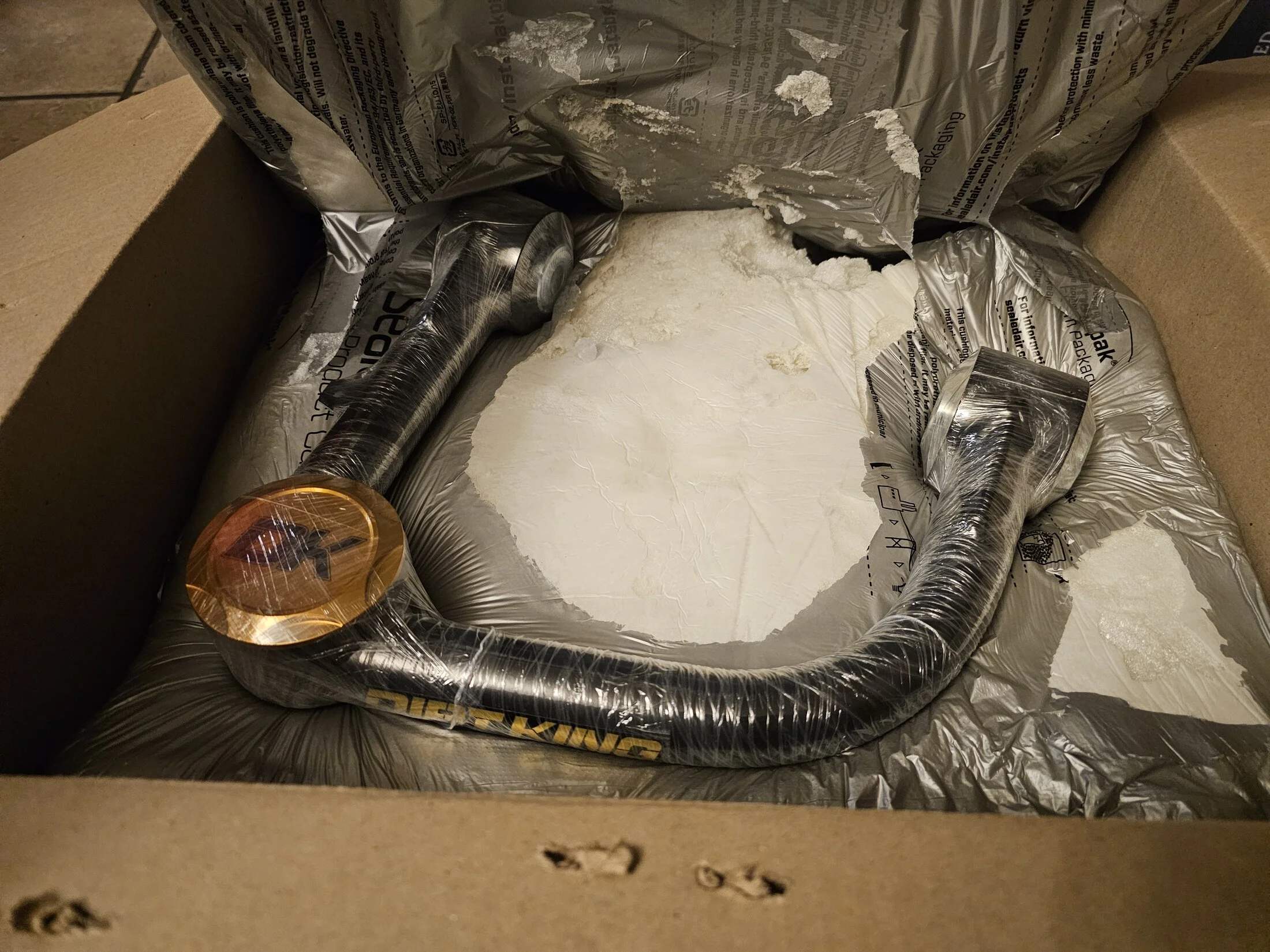

I scored a set of Dirt King UCAs on sale around 7/4. They come with no maintenance bushings. Good luck.
nice! i just saw that DK released the "maintenance-free" UCAs. Really tempted between those and JBA, which are still less expensive.
I'll definitely keep an eye out for sales in the coming weeks.

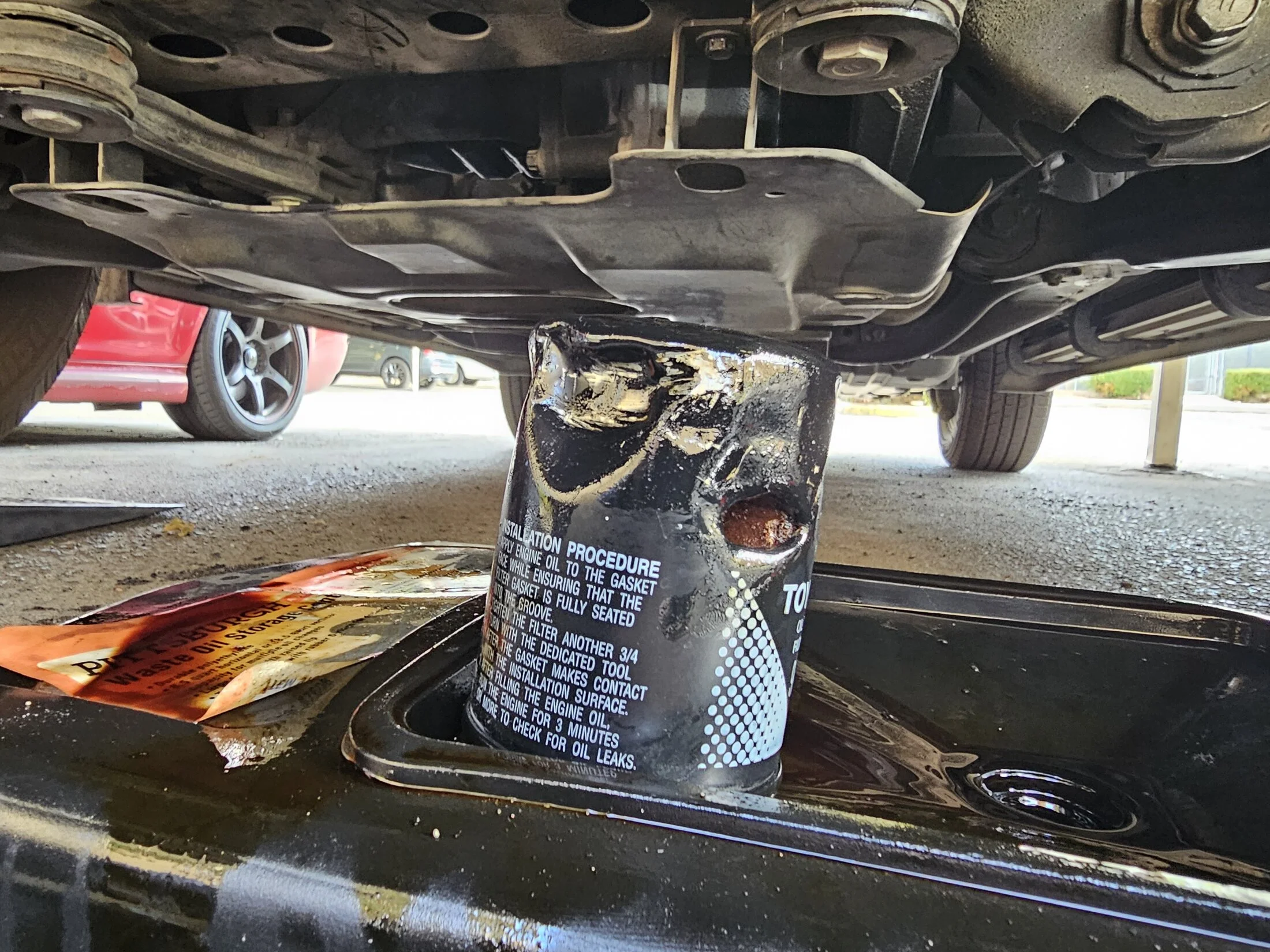

1st oil change at 155xxx miles.
:censor: whoever installed the last oil filter. It definitely wasn't hand-tightened on. I'm glad I found the filter pliers and even those were having a hard time loosening it.

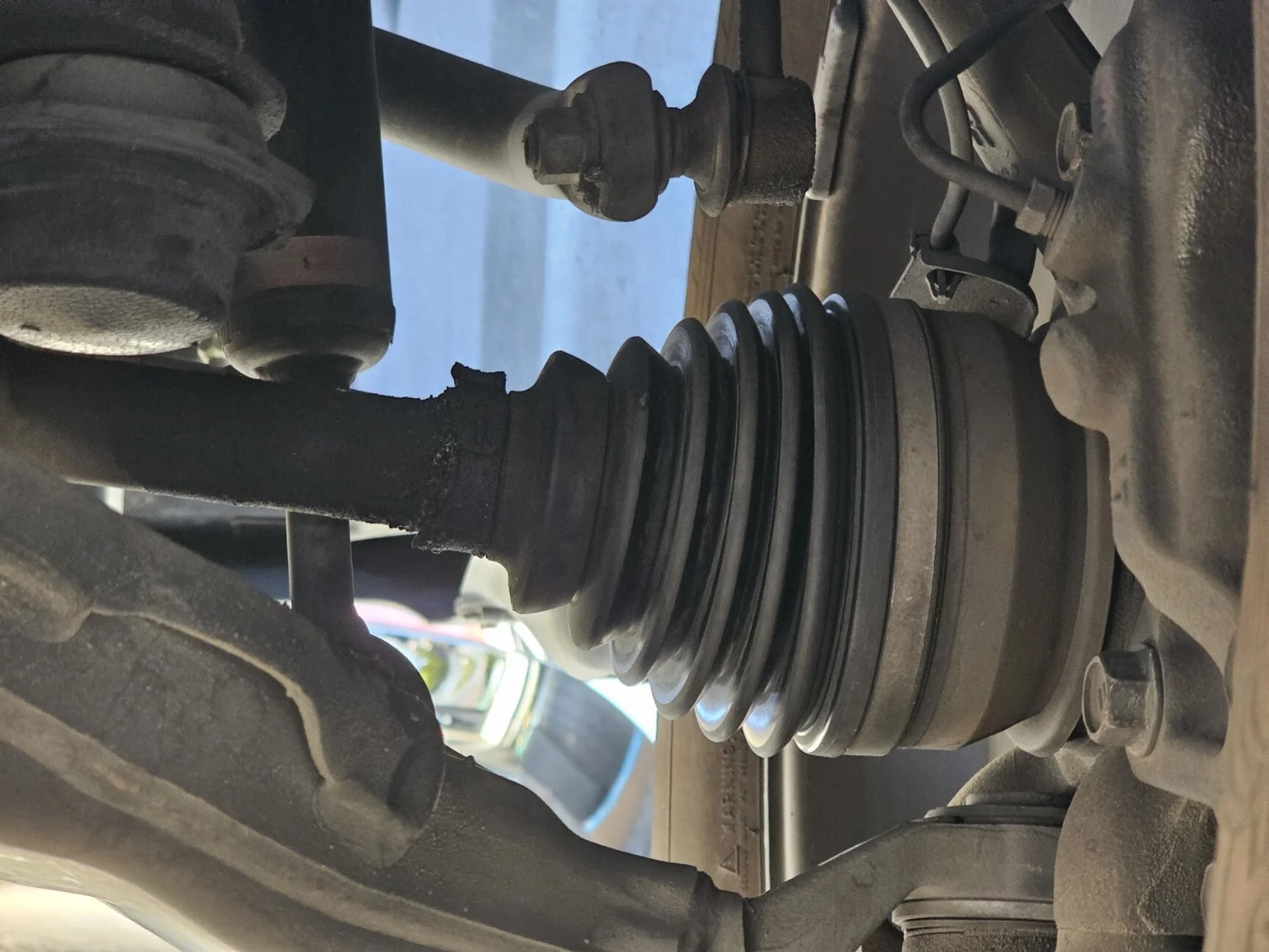

Other news, passenger side outer CV joint is starting to sling grease. It looks like it's coming from the small end of the boot.

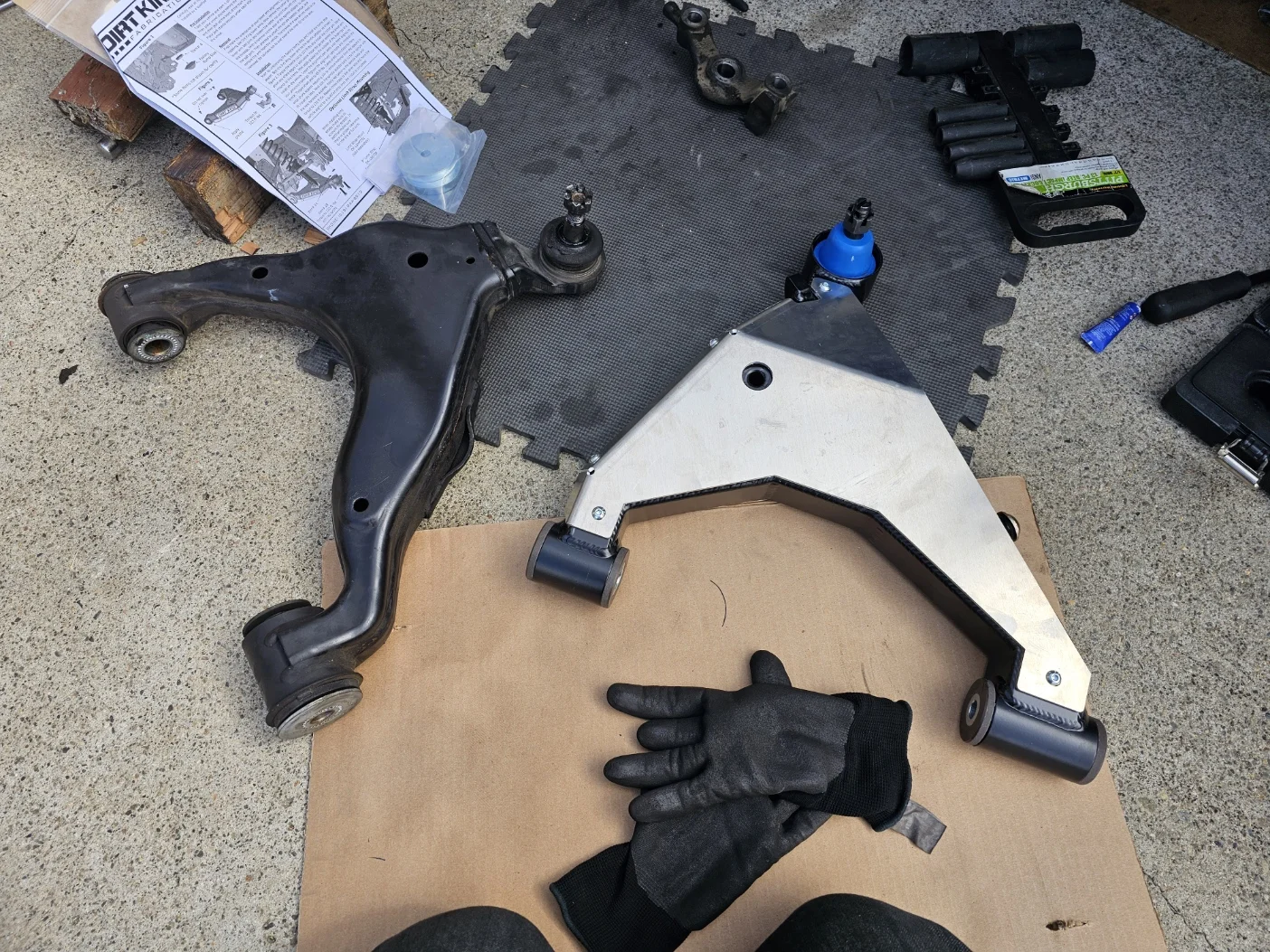

I tackled overhauling the suspension...all of it. Front and rear. Upper and lower.

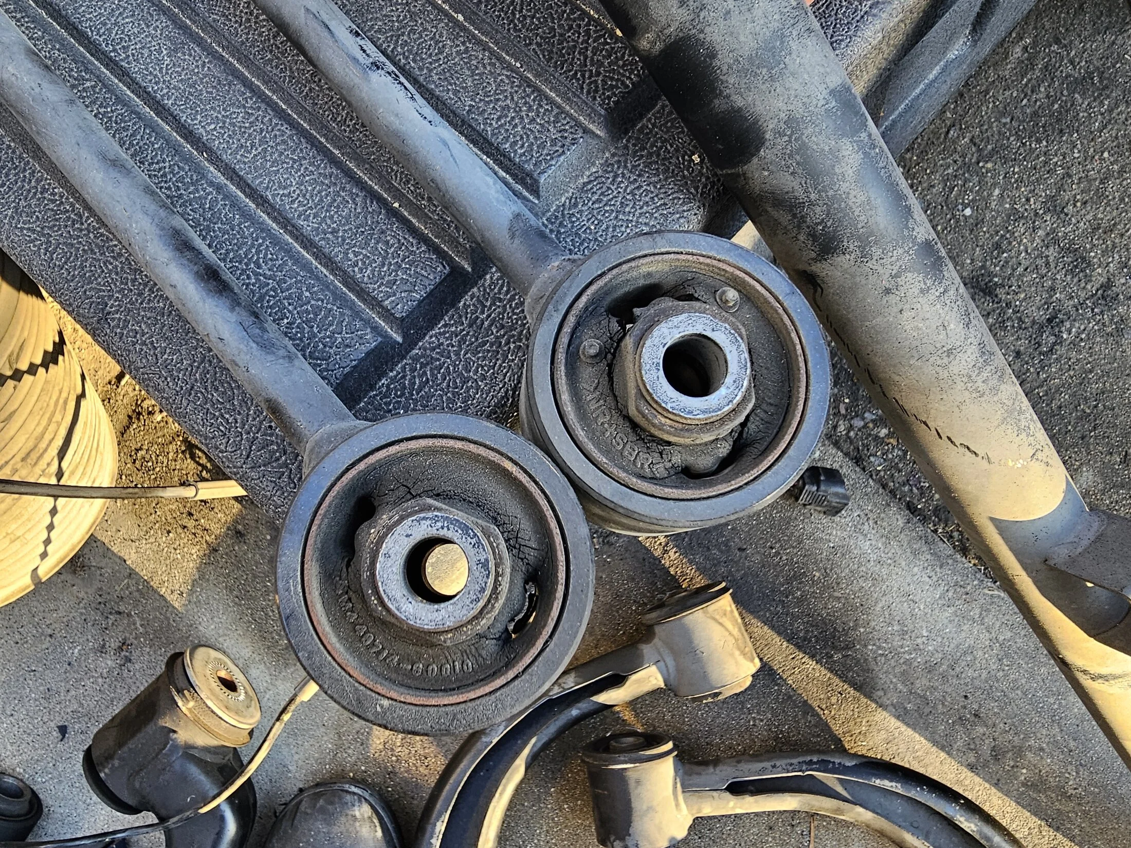

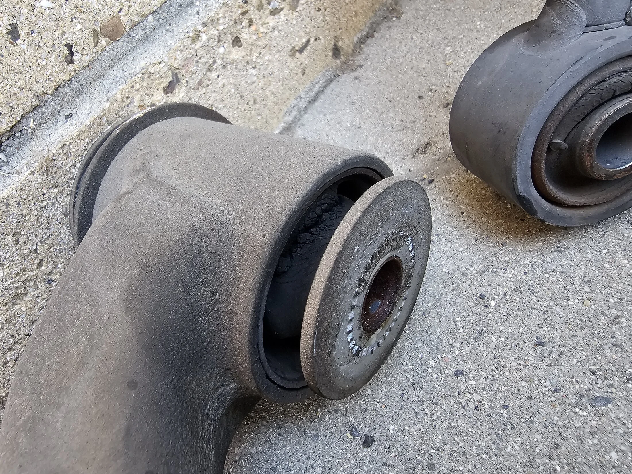

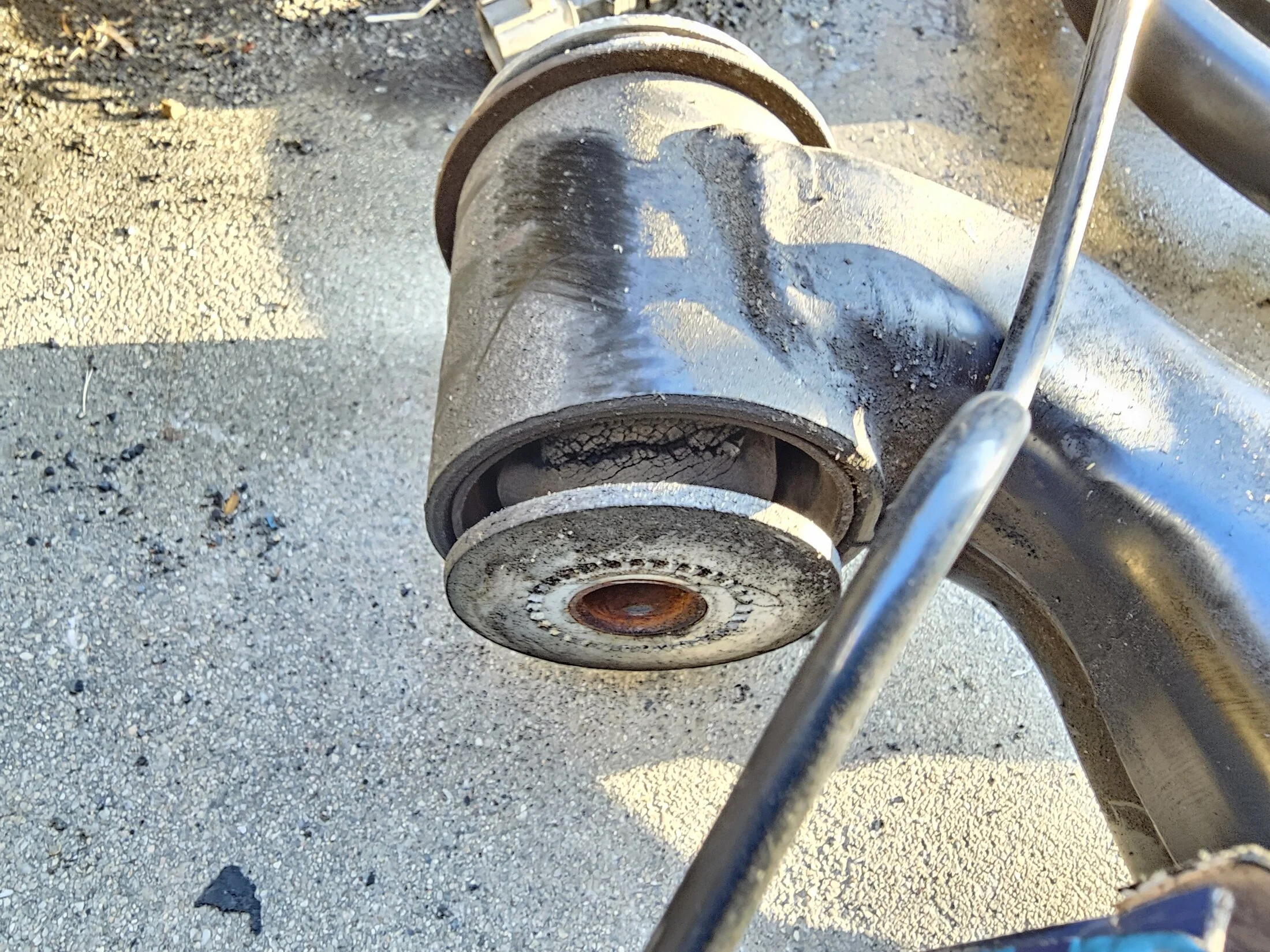

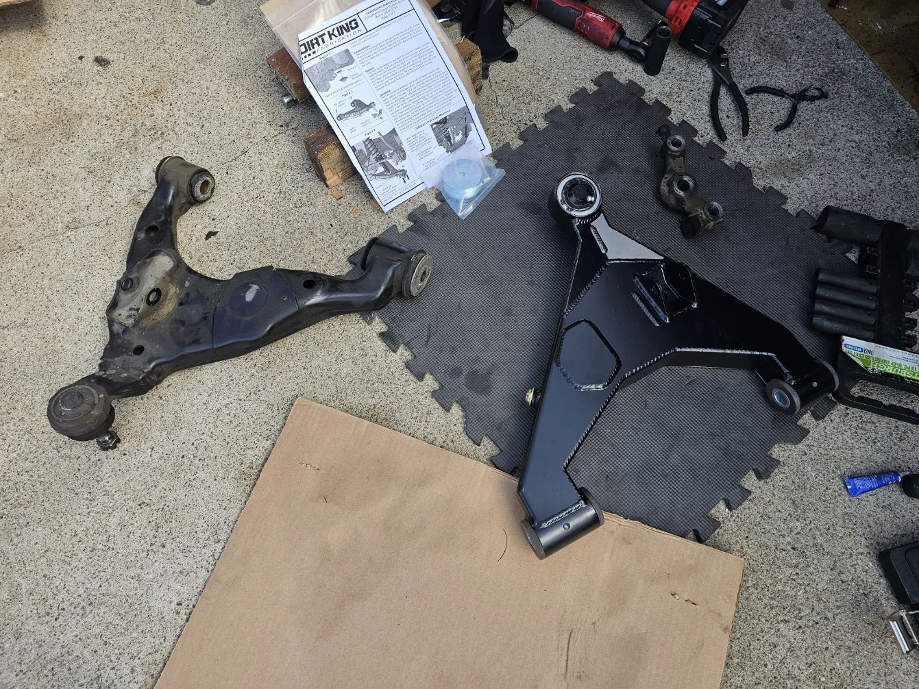

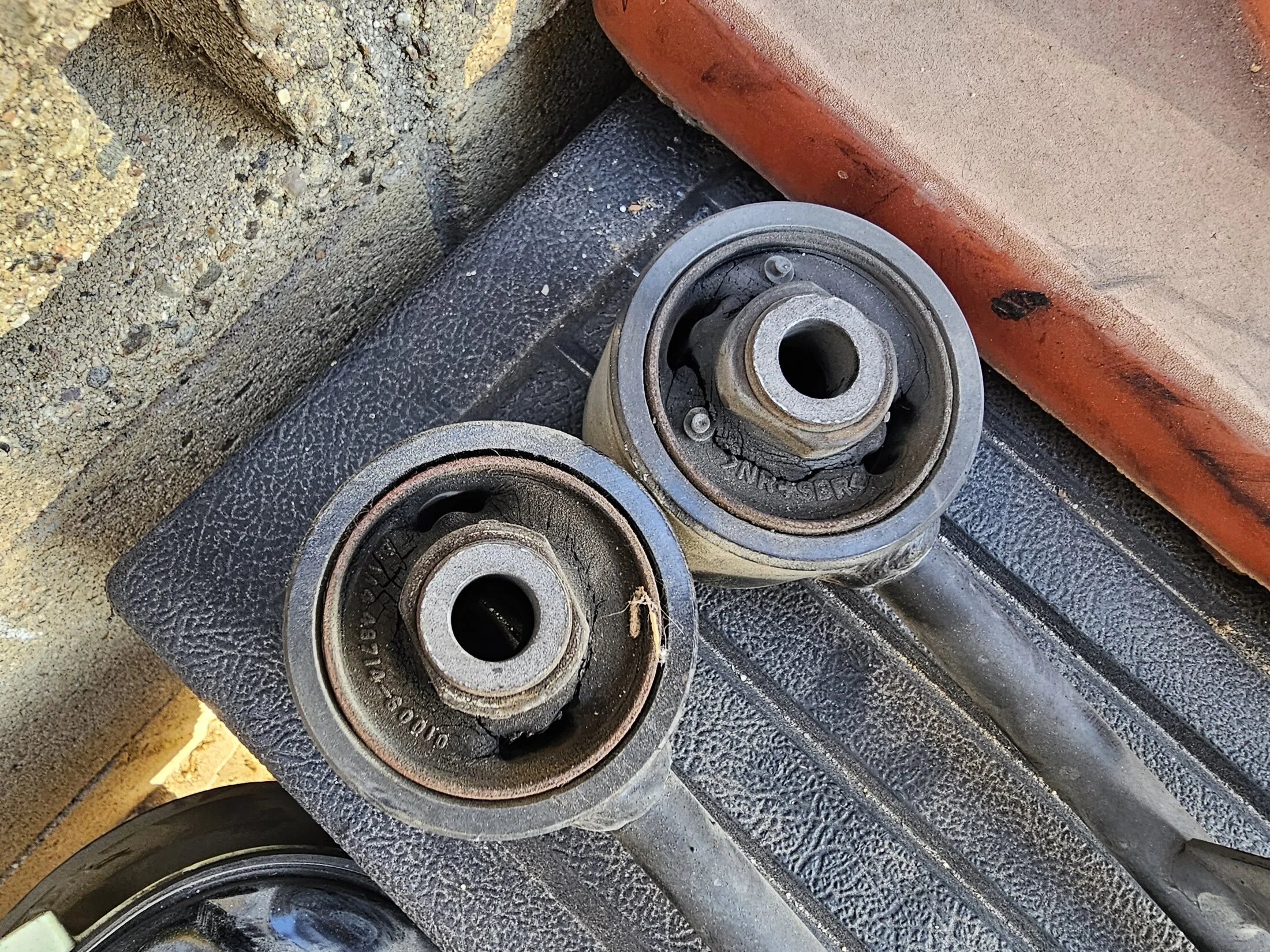

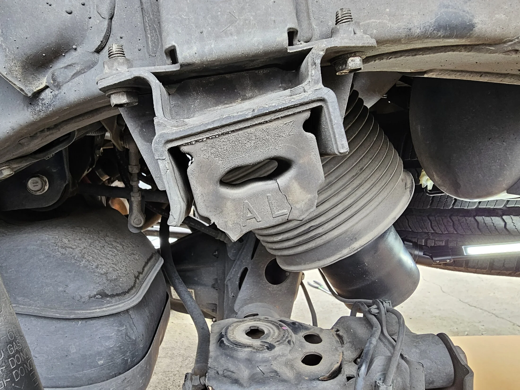

First up, why I needed to change them out:
(The bump stops on both sides were like this)
I didn't get photos of the rear shocks but one of them was easily compressed by hand and the other one required a little more effort to compress but still easy to compress by hand.

Yours looks quite a bit worse than mine did at 145K when I lifted it! Regardless, mine was far from mint, and it shows the pitfalls of just throwing a lift kit on one of these rigs while replacing nothing else - at 15-21 years old - and rolling with it. The rest of the suspension is likely shot due to natural degradation of rubber bushings over time.
You'll love the way it drives now!
Yeah, the dry and hot CA climate does not treat rubber parts kindly.

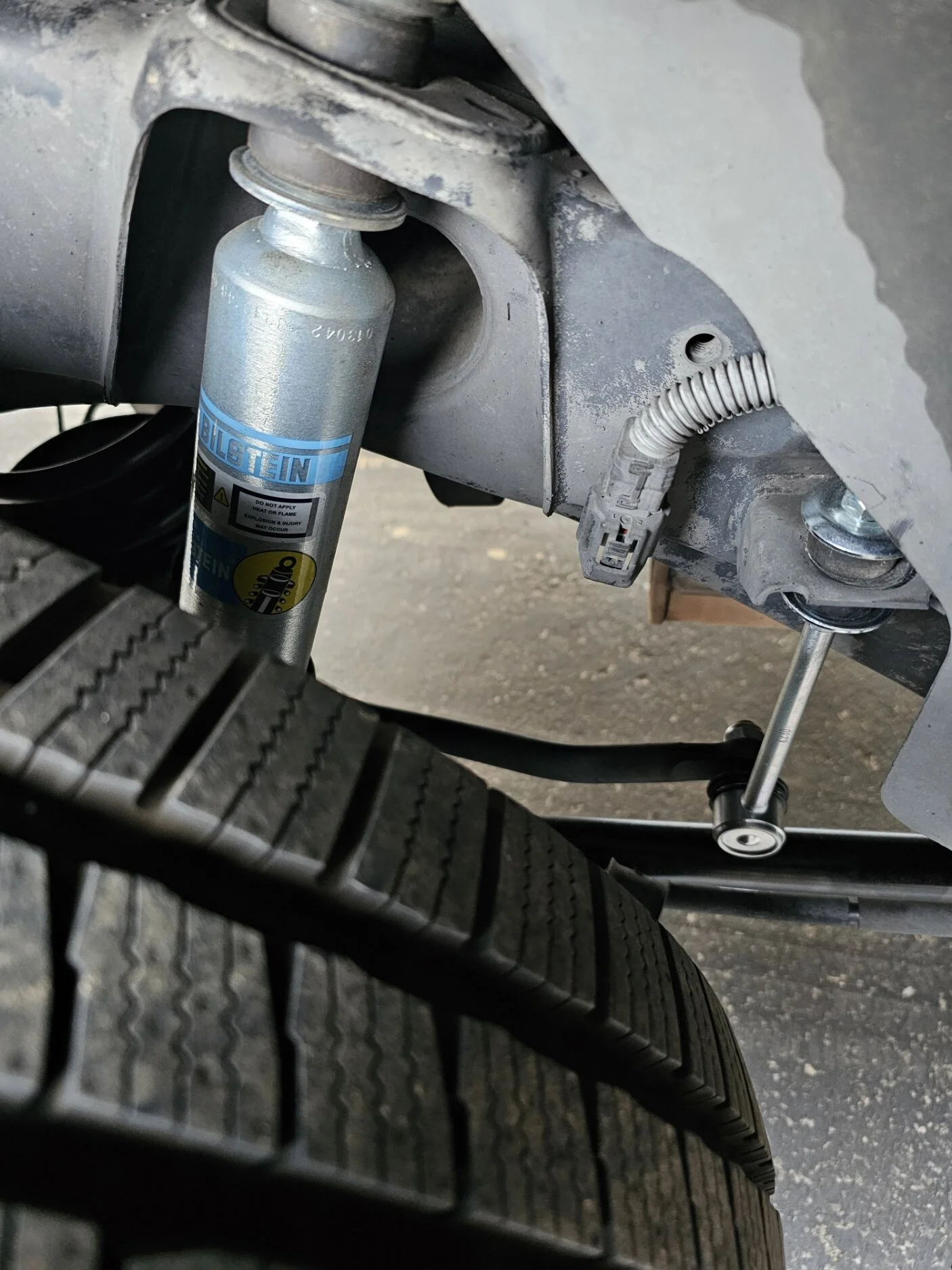

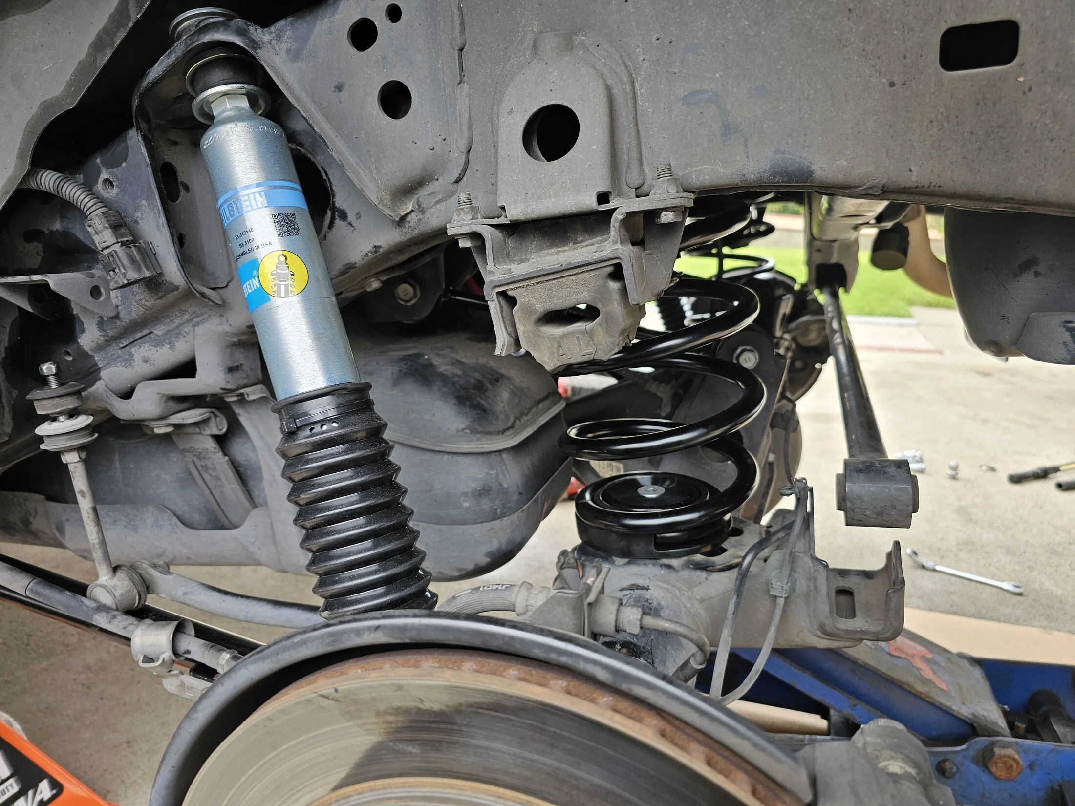

A few in-process photos:

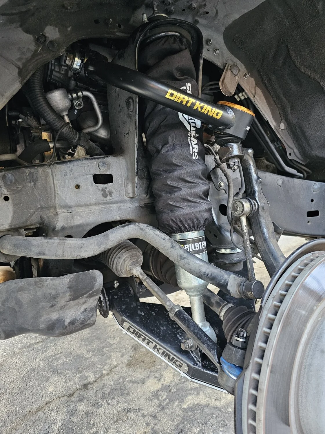

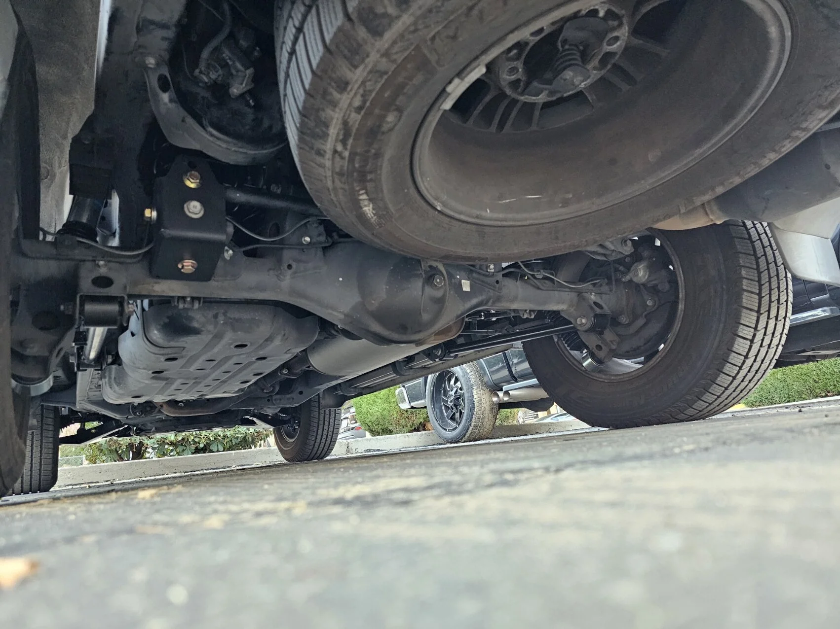

Bilstein 5100, Icon rear coil conversion, Icon 2" lift rear springs (52700), and Energy Suspension spring isolators. The Icon conversion kit is nice but the bolt was too long and interfering with the axle housing. I had to trim about 1/8" off the end of it to get it to fit.
Where I left off at the end of the first day:

Nice! Loving that coil over cover.
it's a bummer to cover up all the Bilstein 6112 goodness but the covers will help the dampers last longer. I'm surprised more people don't use them. I've been using them on my M3's coilover and they've last since 2019 without a rebuild.

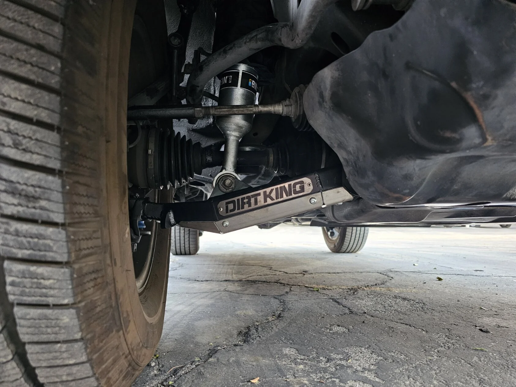

Snagged a few more photos of the suspension today
and went through this rite of passage
If I have time on my day off tomorrow, I'm going to check over the suspension to see if anything loosened up.
I'm happy with how it rides now. I do have about 100lbs of stuff in the back so that is probably helping lol. But it is so much more stable and smooth with actual working dampers.

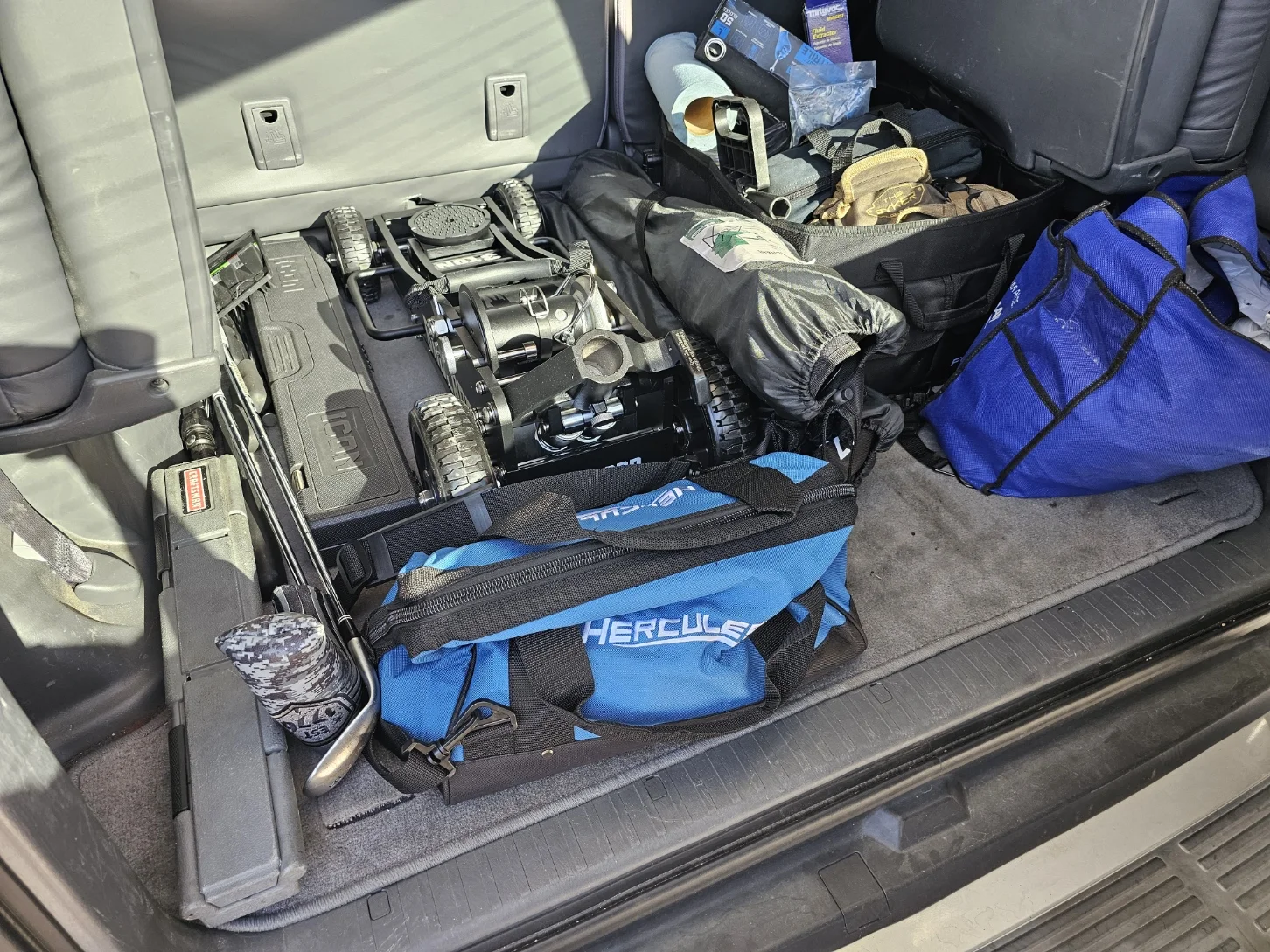

Granted I do have all this in the back lol:
