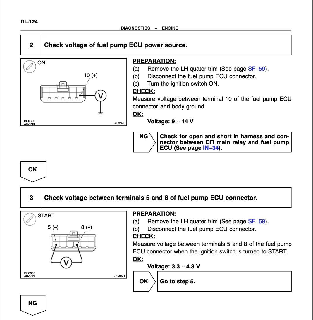

10 .7 volts is normal and within the specified range, spec is 9-14 volts. Remember it's a variable speed pump and regulated by voltage thru the fuel pump ecu.
Where are you testing at? It needs to be metered at the fuel pump ecu. Checking the resistance of the pump is of equal importance as well.
Should be at 0.2-3.0 ohms.
I did a bunch of pump/ecu checks several months ago and have some notes. I may have left them back home in Maryland but I'll look for the service sheet in the FSM and post it up.
