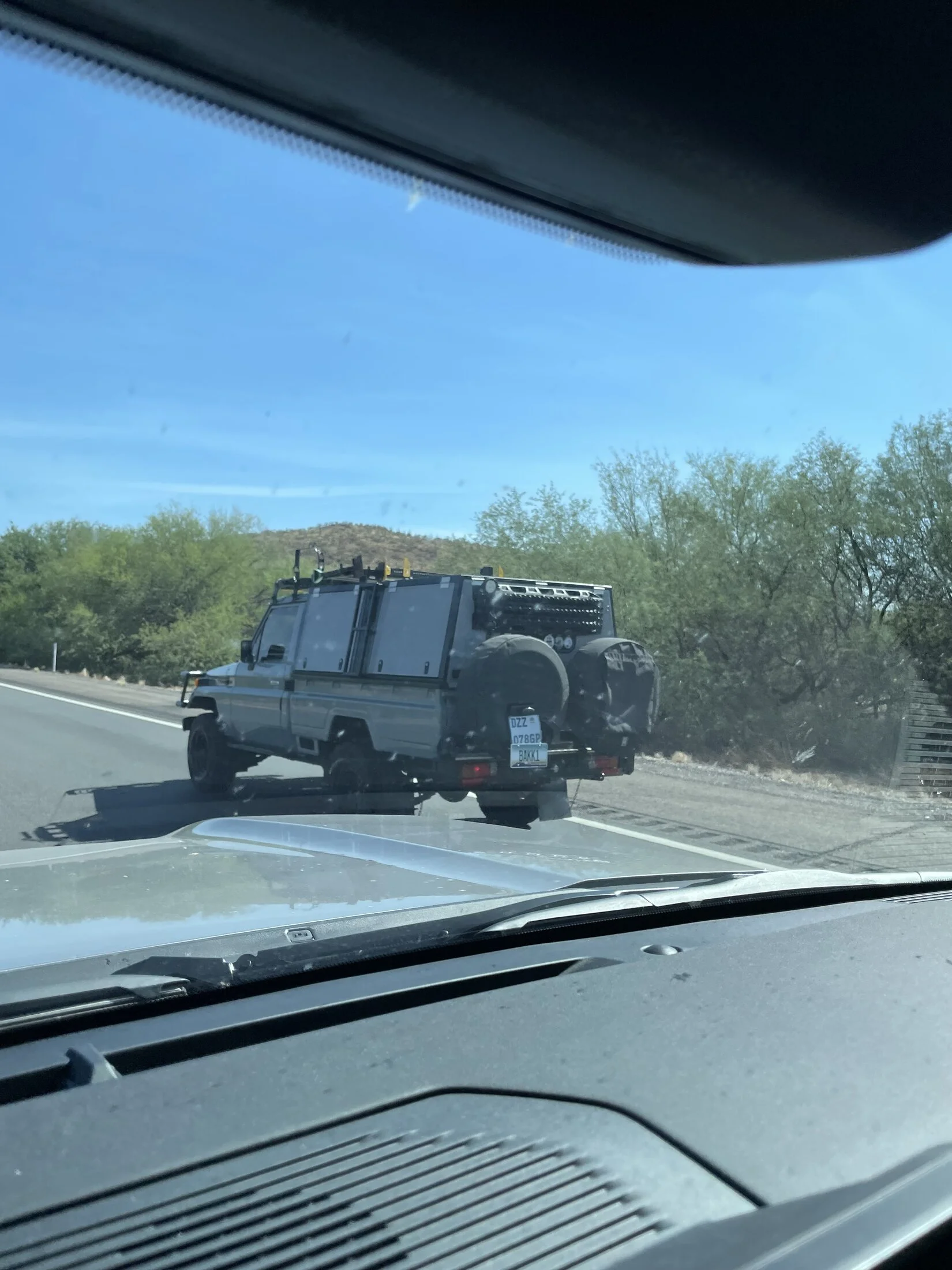

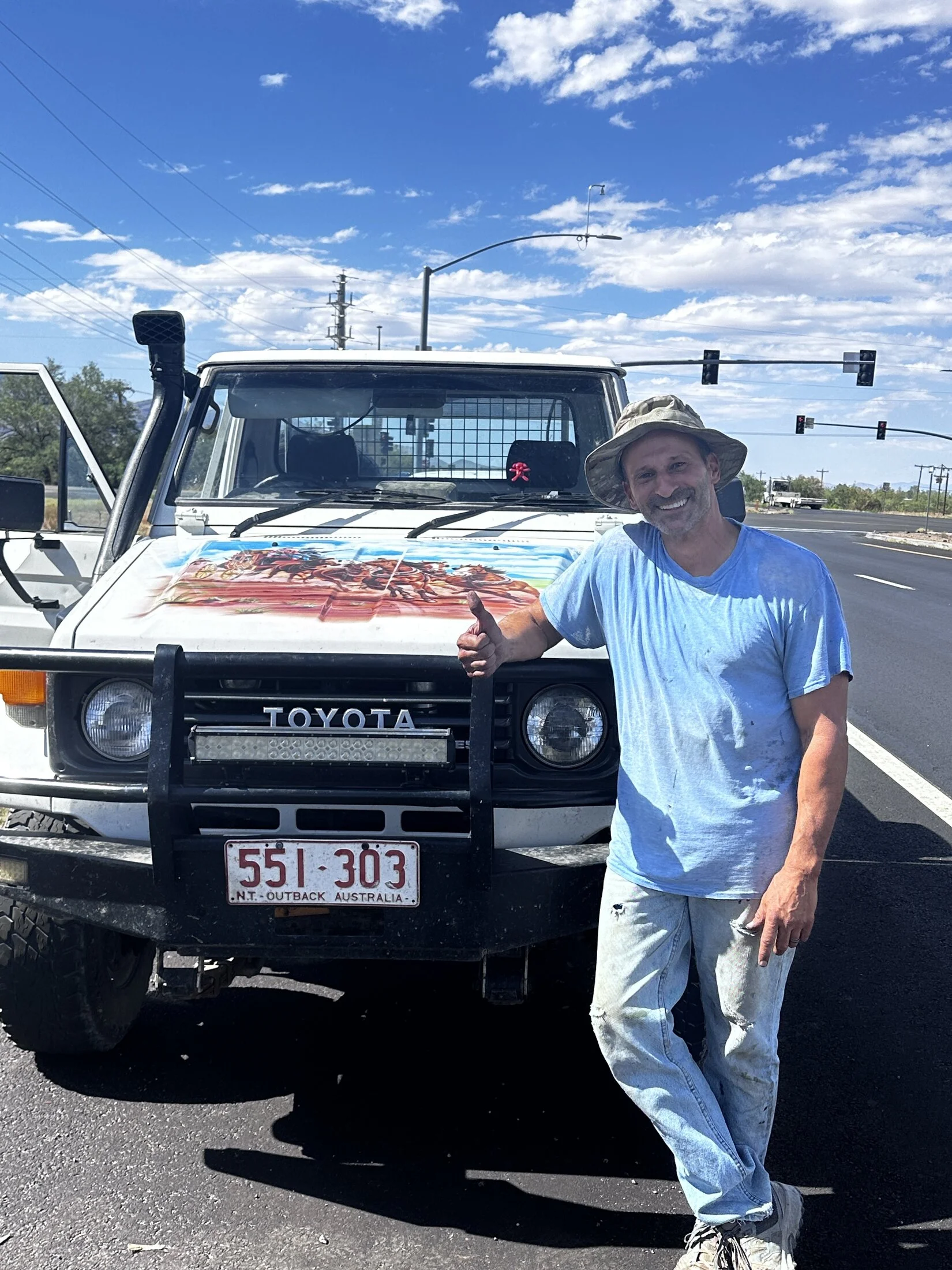

Recovery mission in Whetstone…. Spotted this dude DOA.
Whipped it around…
Looks like the engine mounts were toast and the fan went into the shroud. I peeled back the shroud and then cut the fan fins down for clearance. Then ratchet-strapped the engine mount from the block to the frame to pull it back a bit and support it for him to get back to Elfrieda…. Luckily I had some useful tools with me.
Would like to know the story of his travels. Ausie plates, was he from there or just the vehicle.

I saw this truck back in May at the Ace hardware in Sierra Vista. He must have been happy to have @OGBeno show up with tools.
He’s a dude who lives out in the desert. His truck is Australian.

Yes. His AC compressor clutch is seized.
The truck is a basket case.
