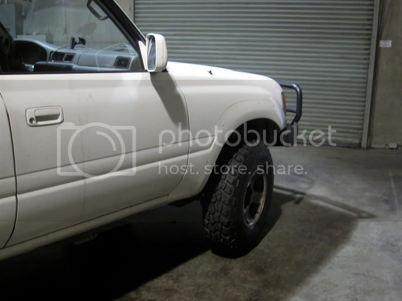

Okay, so I went with the BFG MT KM2s in 255/85/16. I have yet to use them in the dirt, maybe this weekend, but as for on-road performance, this is what I've noticed...
Pros:
--I seem to have a slight jump in mpg, maybe 1-2 mpg in total.
--Cruiser definitely seems more peppy, in terms of acceleration.
--Seems to be braking faster.
Cons:
--Deflection, overall feeling of stability is noticeably affected. Hard braking, while stopping times have decreased, feels more squirrelly. Sudden turns or lane changes can give you an ass-pucker, as the truck feels overall less grounded with the thinner wheel track. My friend described it as "floaty".
And here's how they look:
I don't have the KM2 spare on there yet. I'll be getting one soon.
nice new shoes! the tall skinnies always look at home in a flareless/step bar'less 80. (i can just imagine what 33x9.5x15's will look on my 80...a tad thinner than those)hmm, with those con's i'm debating where i should just grab the 10.5s instead..and then seeing how that affects mileage compared to 9.5s...
