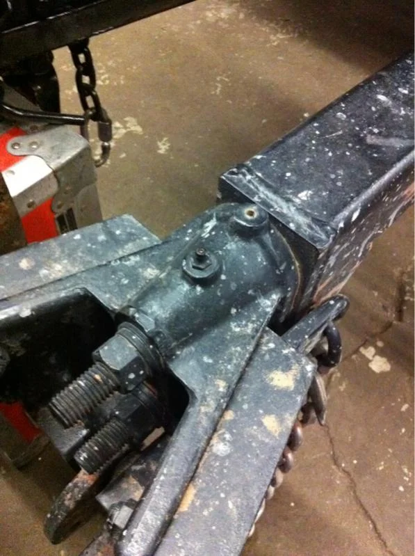

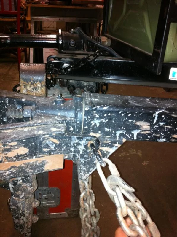

Yep, I don't plan on cutting the frame. What I'd like to do on the trailer side is like the first post in the second thread linked by Brian. What is different is that I'd like to retain the stock lunette casting piece and lunette to fit into that receiver tube, thus retaining landing leg and rotating lunette while being able to add length. So in my first drawing, I probably should have shown the short c-channel around the lunette casting as new material, and not part of the original frame. Real question I guess is how to make a receiver insert using the original lunette casting.
Check out the extension on Jeremy at Expedition Ops' tongue extension. Story goes, the prisoners at the facility he got his from had fabbed up his extension. 100% reversible, and much less engineering needed than some of the other options.
Flat plate with two hold punched through, matching bolts pass through the plate, through the lunette casting, and bolt in the same place the lunette ring does. The two bolts maintain proper alignment and prevent twisting. A gusseted 2.5" receiver tube is welded to the plate, and the max coupler is plugged into it. You could weld or use receiver bits from that point.
From looking at the trailer up close and personal, I would weld the heads of the two bolts to the flat plate before attaching the LONG receiver tube, I guess Jeremy has to stack up a pile of extensions just to reach that bolt.
attachment.php
attachment.php
Welding on a bolt turns it into a Grade Zero bolt because the weld heat alters or removes the heat-treating.
If you don't want it to rotate w/o having to stick a long extension down the tube then weld a pair of heavy strips to the plate right next to two opposing flats of the bolt head. I try to use square key stock for this.
or grind 2 flats at the end of the threaded end...
