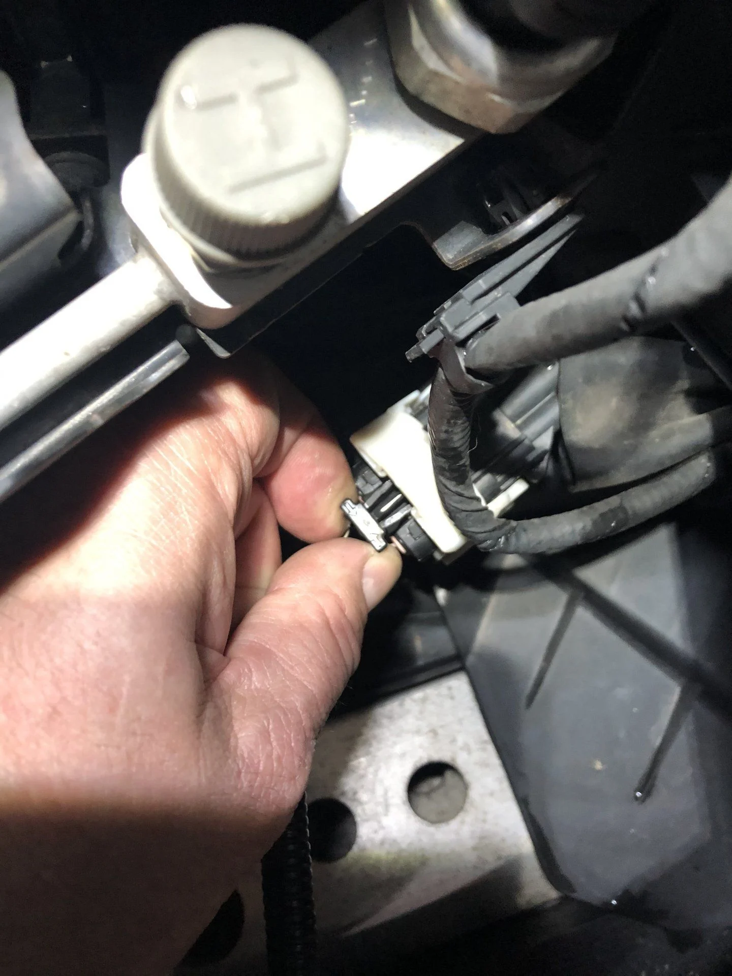

Disconnect the electrical connector to the bumper. Squeeze the sides of the protruding black portion while lifting the white lever.
Disconnect the electrical plugs to the radar and camera.

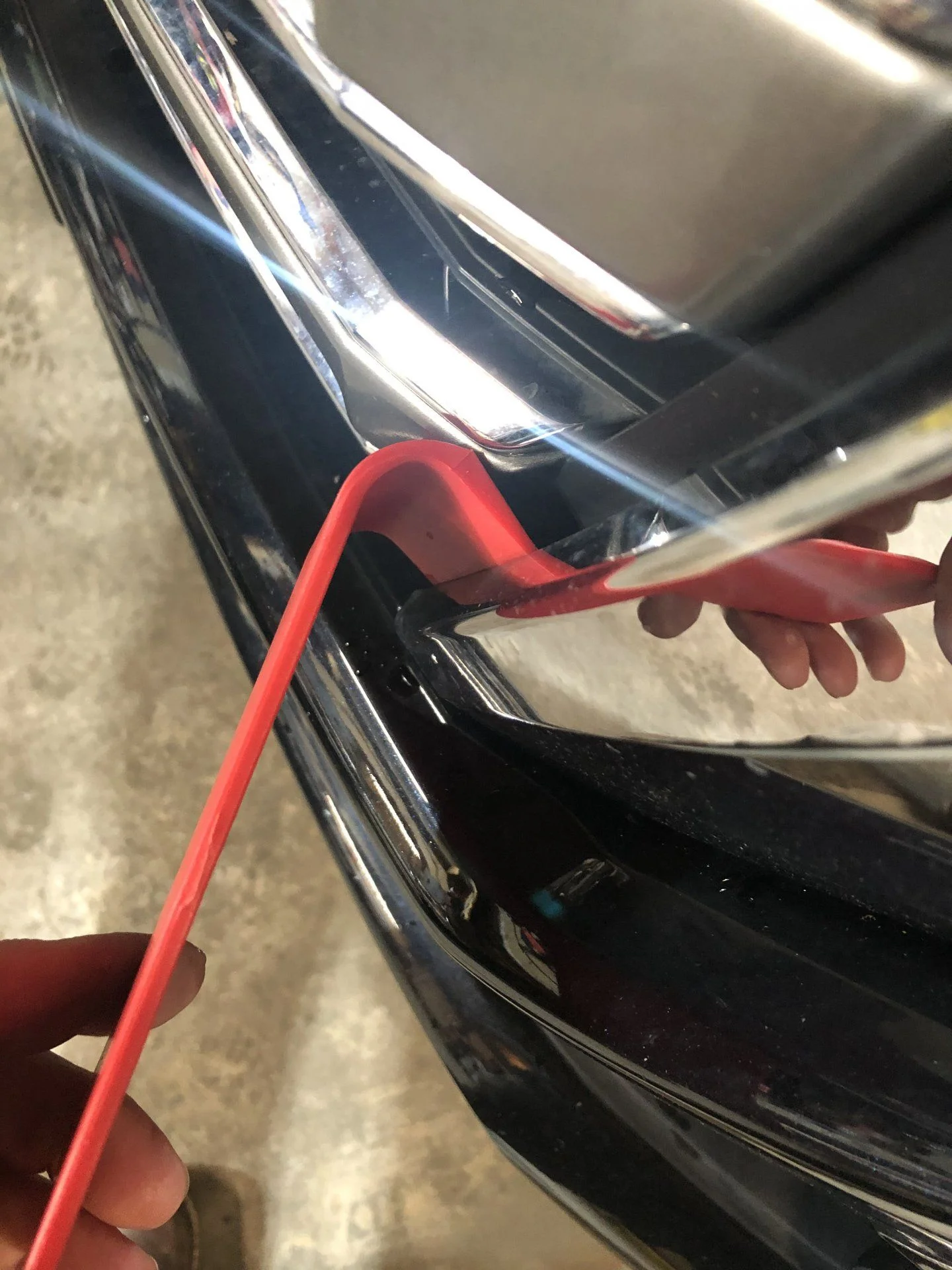

Pop off the outer grille trim with a sturdy trim tool.

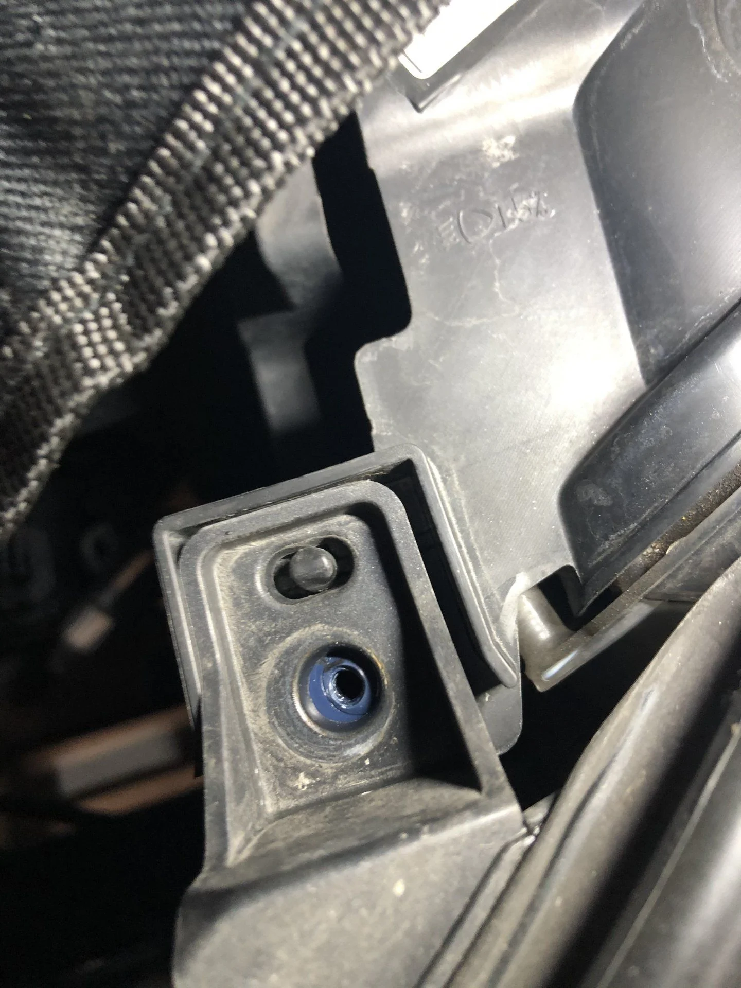

Note that you need to lift the outer mounts over the nub pictured below.

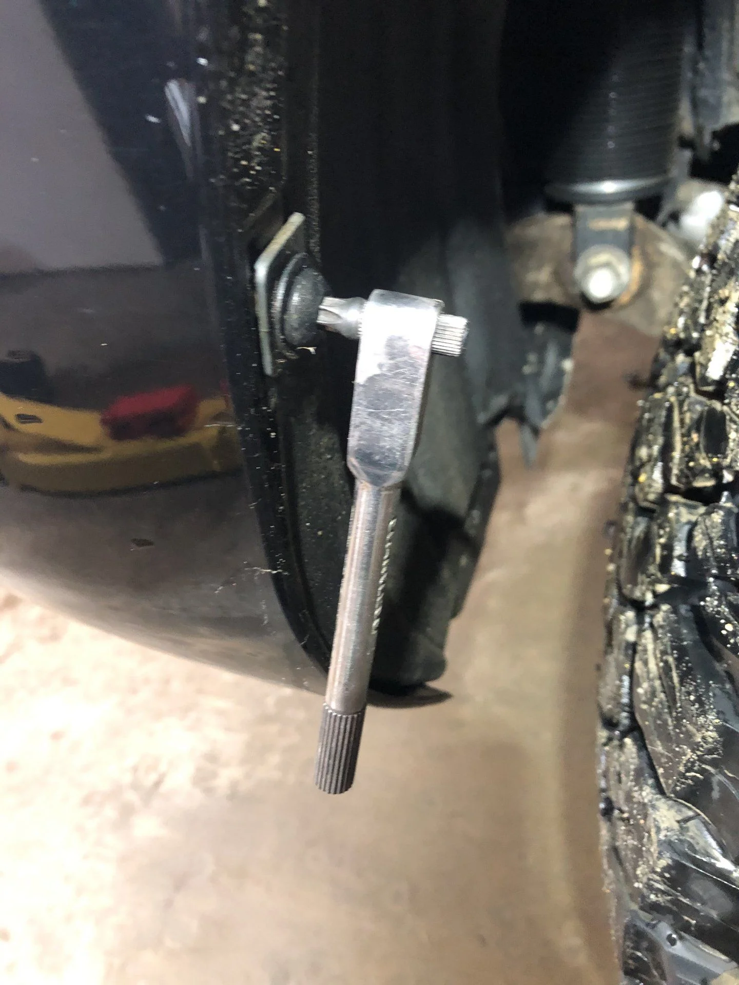

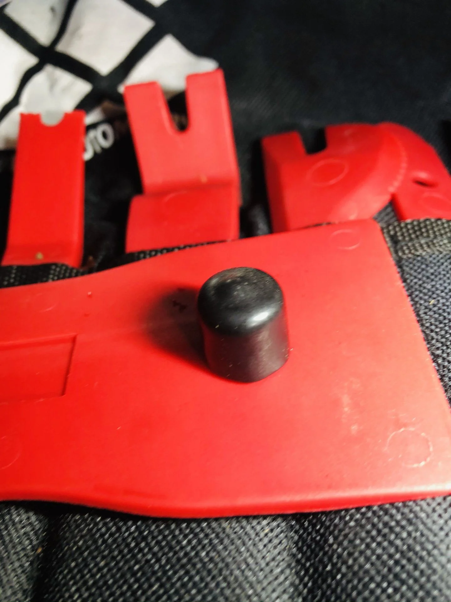

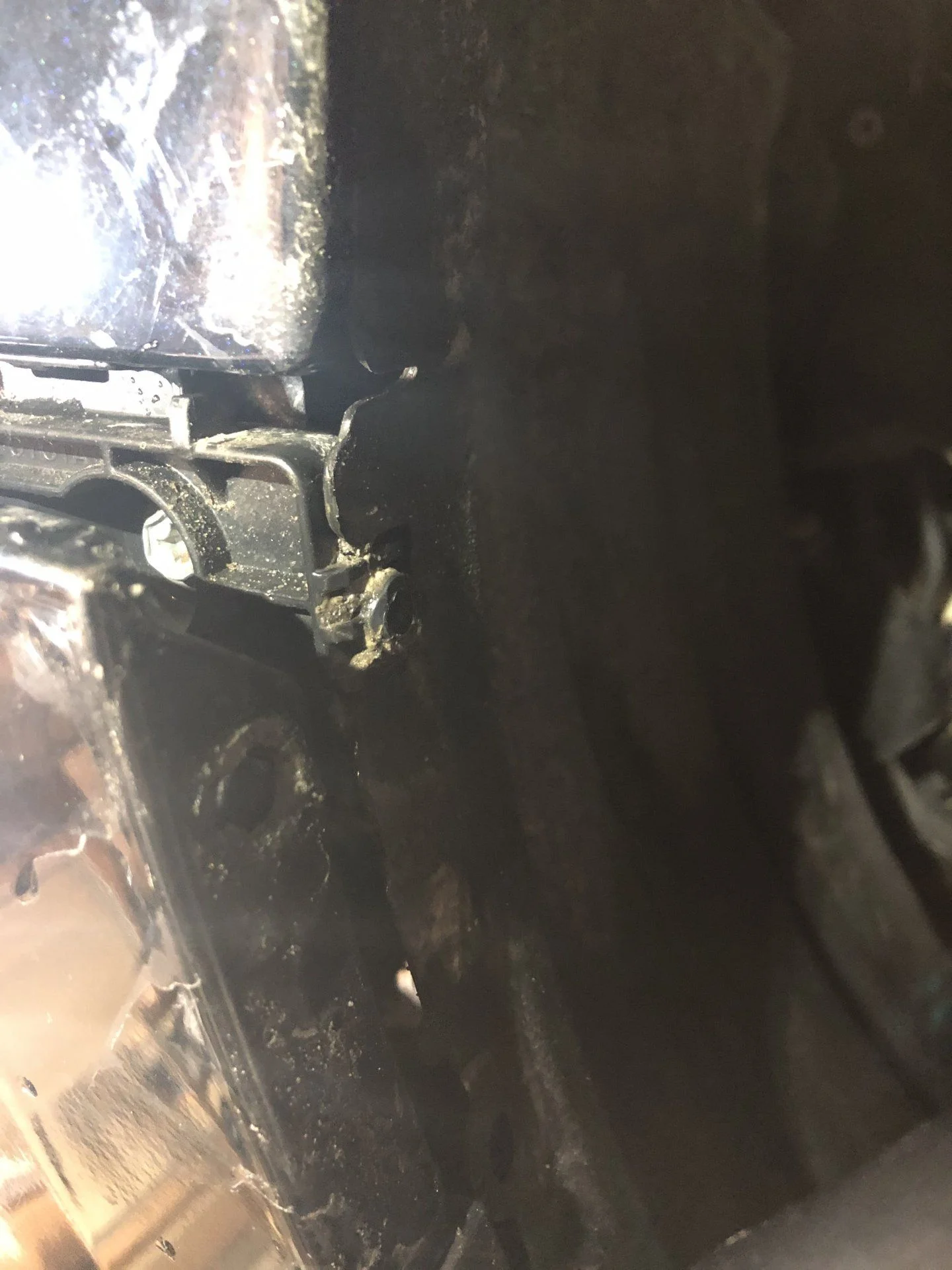

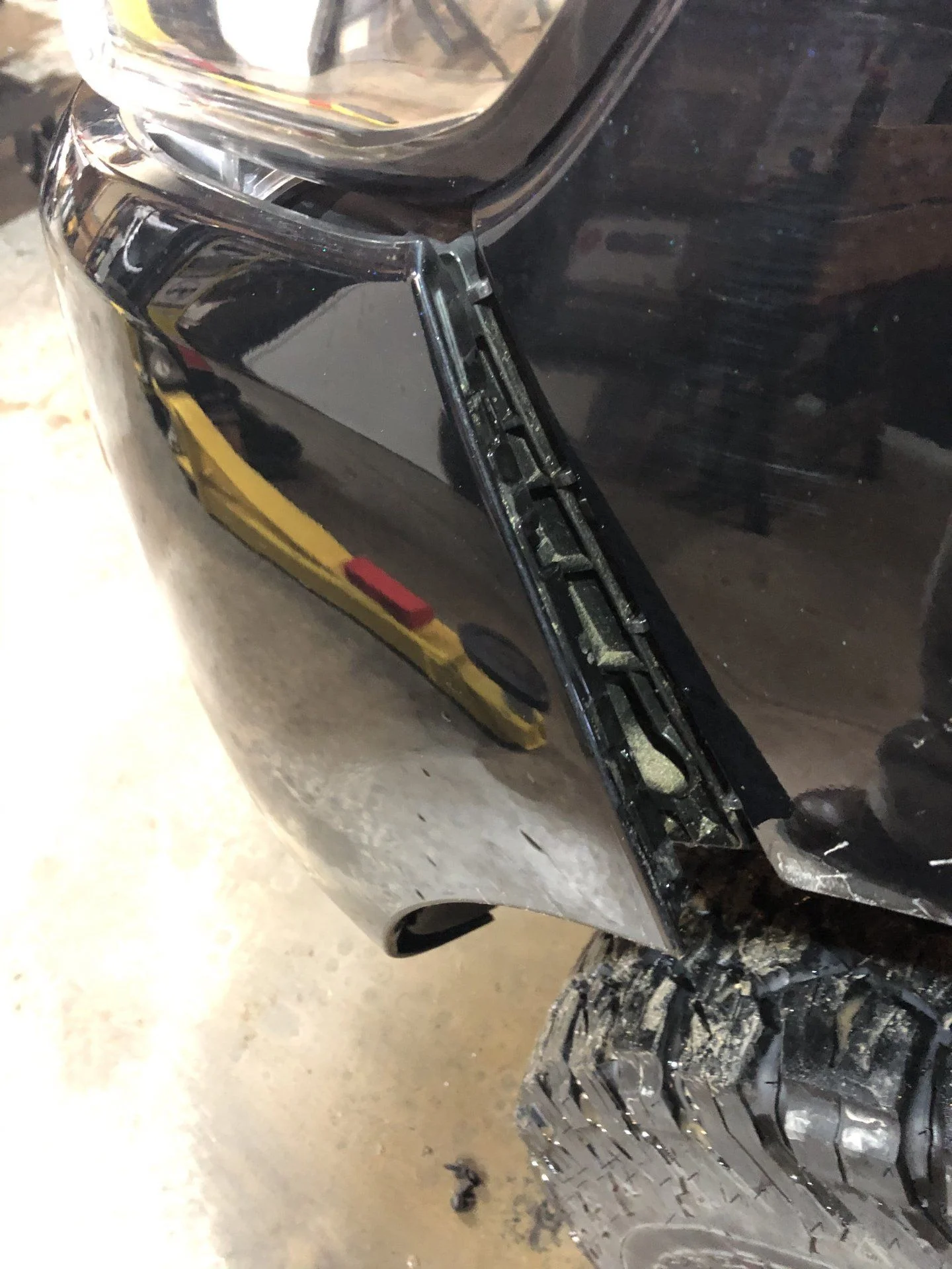

At this point the bumper skin should be ready to come off. One trick here is to note that the top fastener in the wheel well has a plastic nub that you need to pry the bumper skin over (to avoid damaging the mounting point on the bumper skin). I use a trim pry tool here. Sorry for the crappy picture.

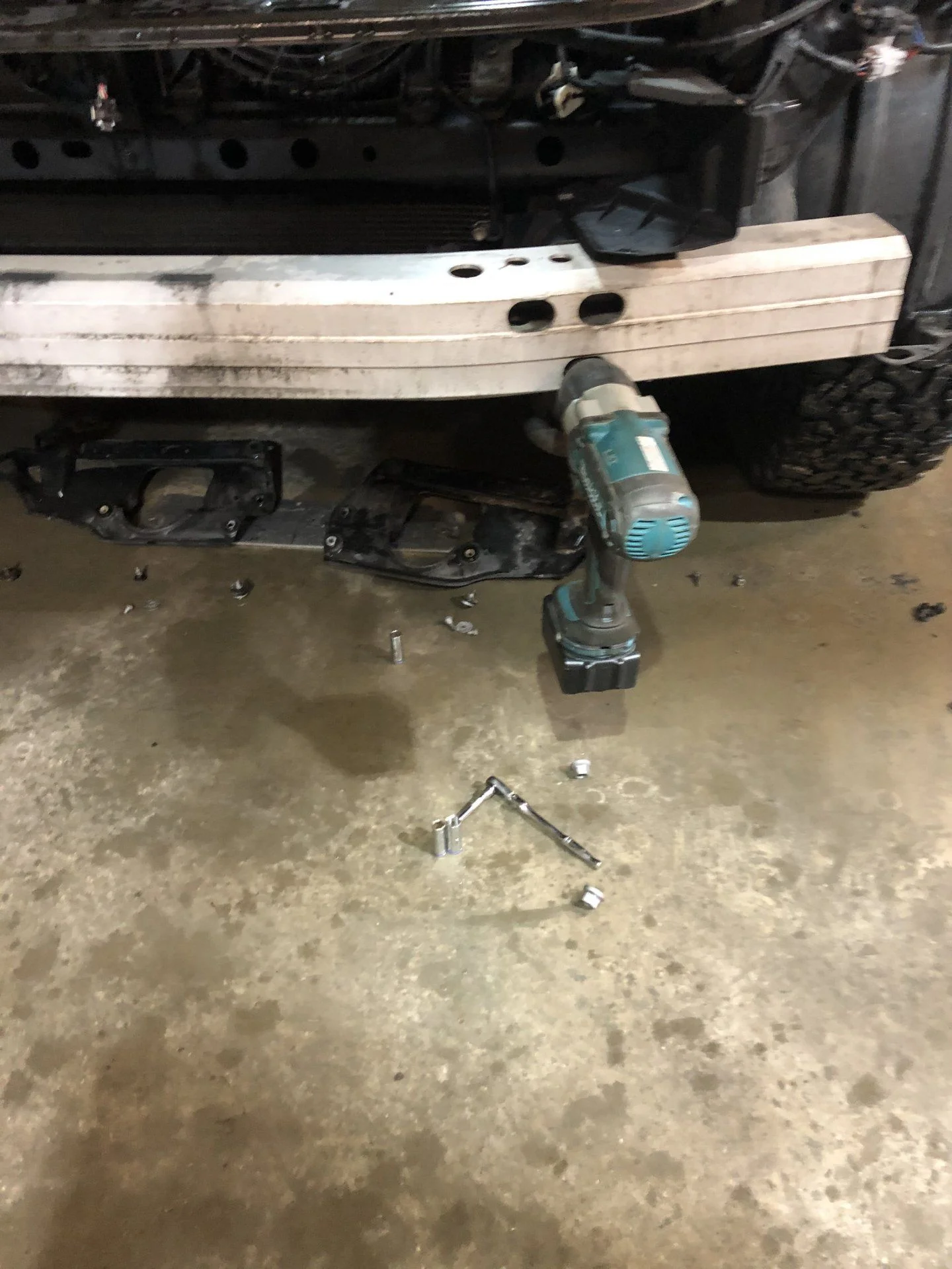

Remove the foam pad, the aluminum bar (17mm) and the frame "horns" (14mm, need a deep well socket).

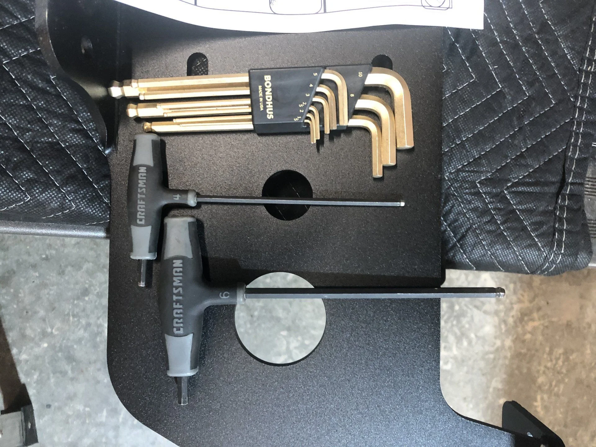

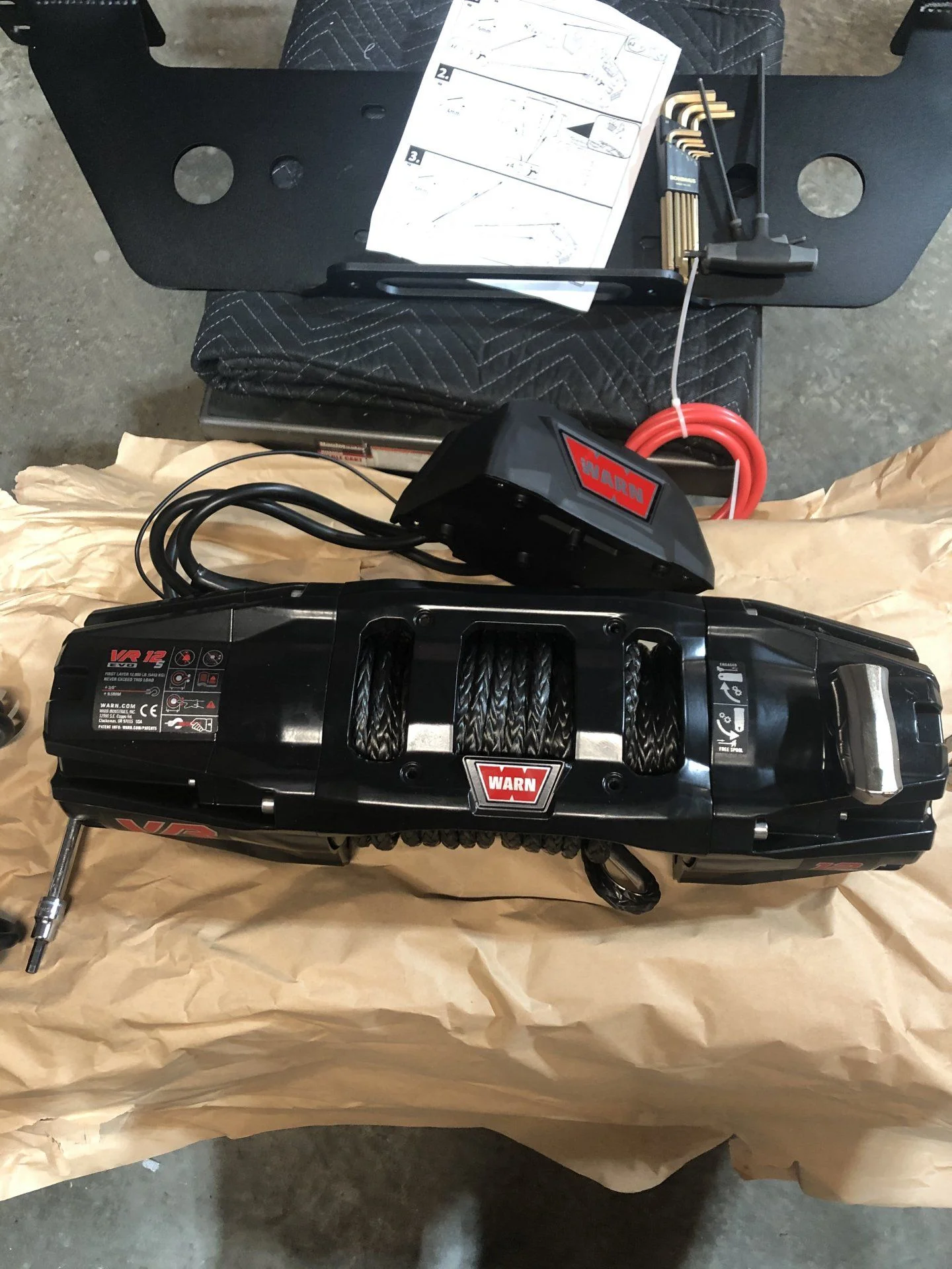

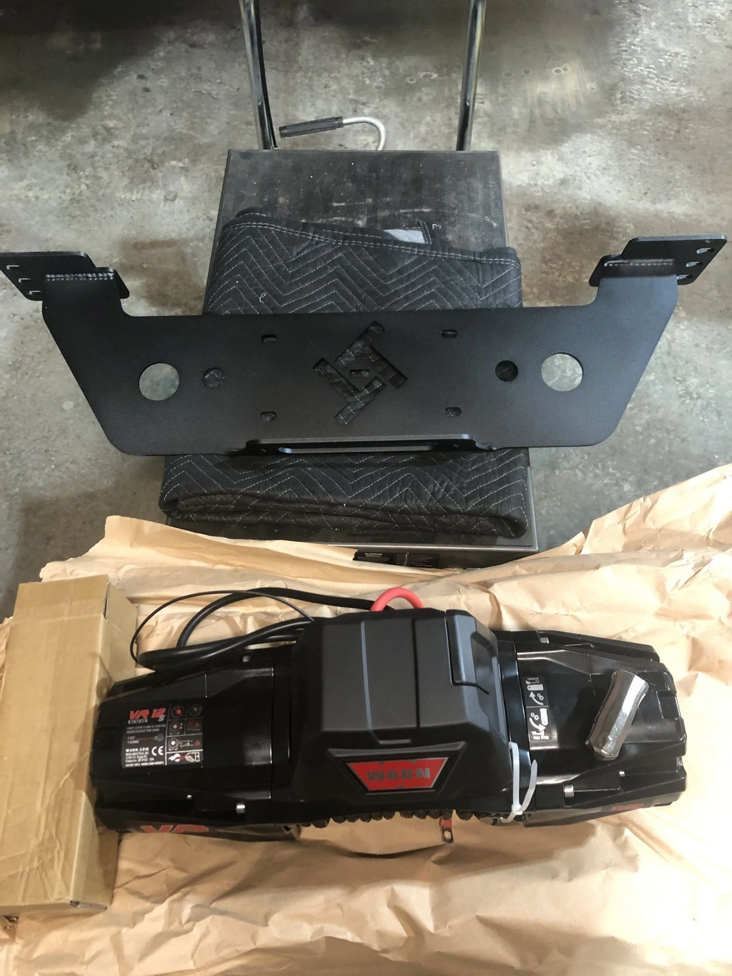

At this point you're ready to install the HWM. I had mine staged and ready to go on a hydraulic lift table which made it easy to install solo.

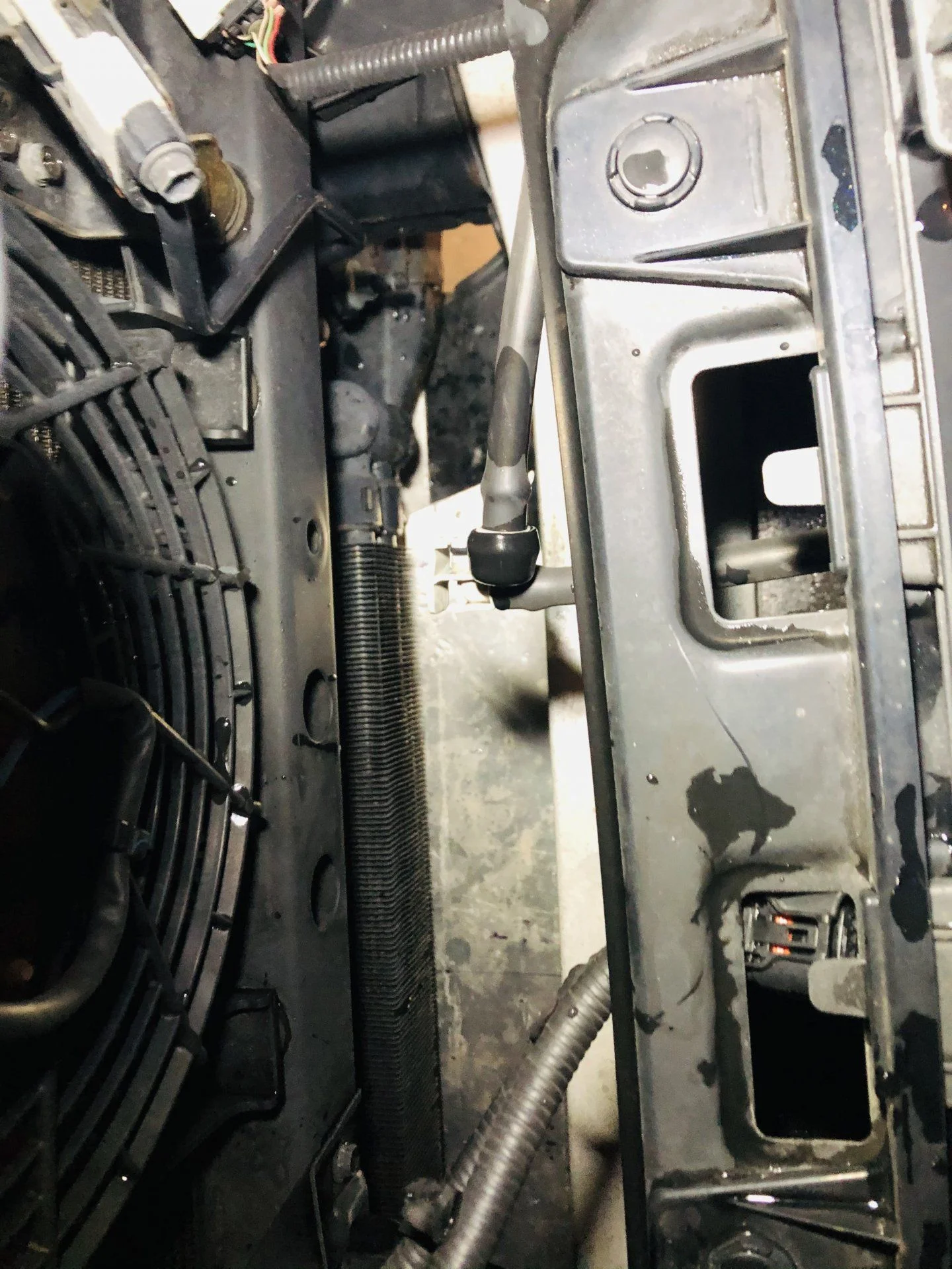

Depending upon which winch you chose, you may need to notch the vertical radiator support bracket. I did not have to do this, there was clearance.
Tighten the 8 - 14mm nuts attaching the winch mount.

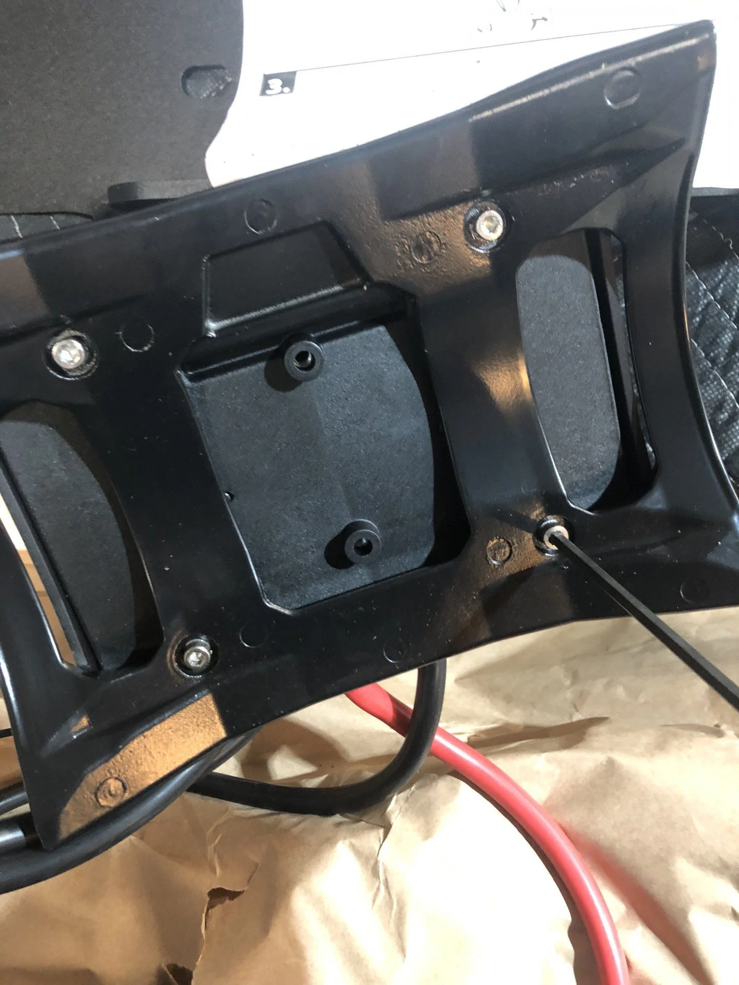

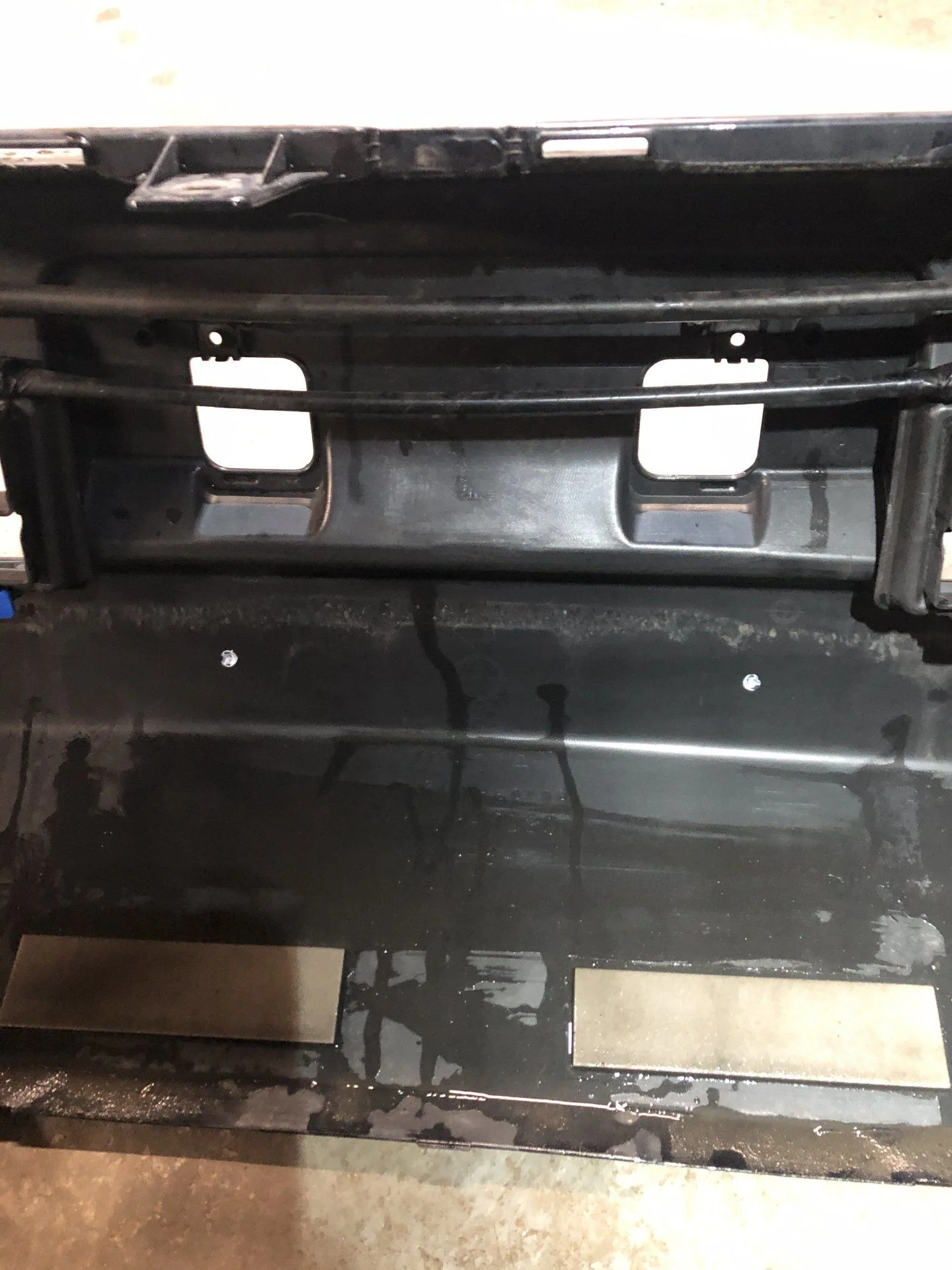

Install short bolts in the fairlead mounting holes, threaded side out. Use something that will transfer a mark - I used a paint pen, grease would work too. Now put the bumper skin back on like you would to reinstall it. The paint transfers the location of the mounting holes.
I did some OCD measuring to make sure the holes were spaced evenly from the centerline and located the same distance vertically. It was completely unnecessary...

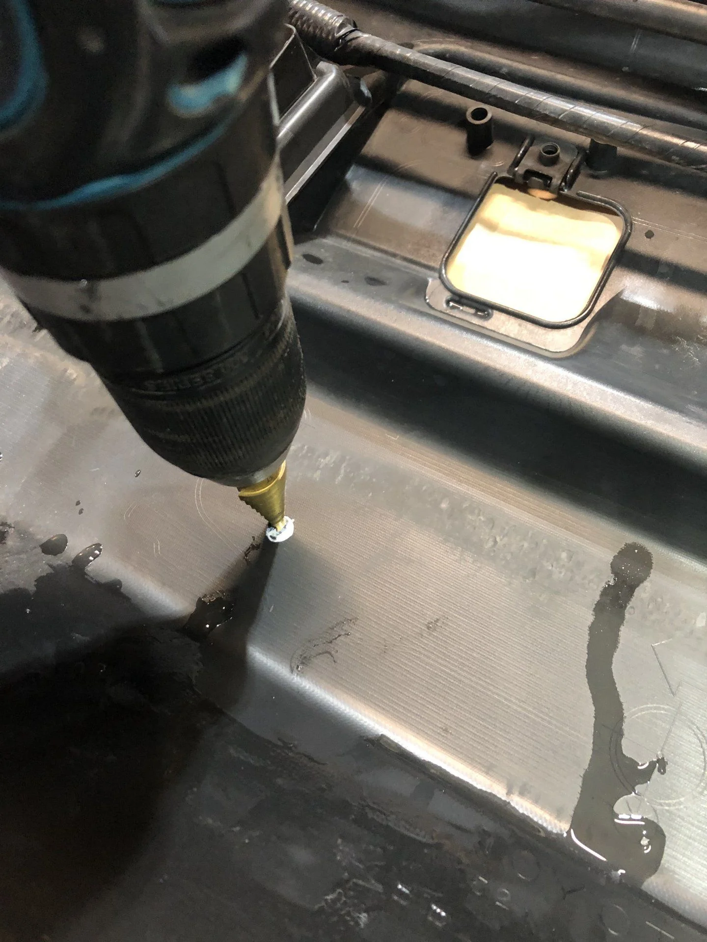

Take a drill (I used a step bit) and drill out the marked holes large enough to fit your fairlead mounting bolts.

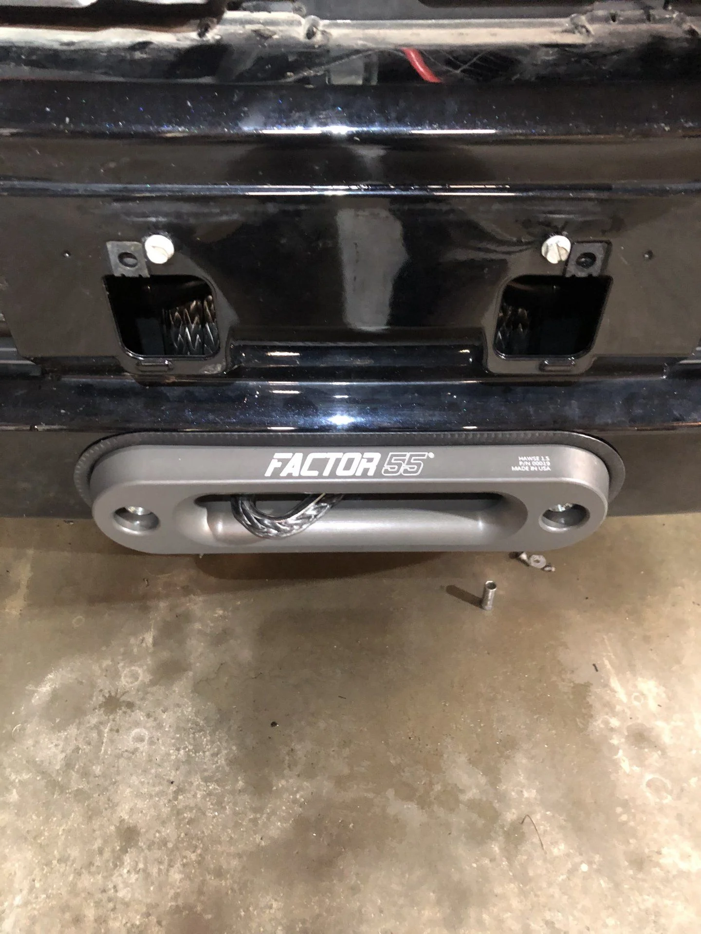

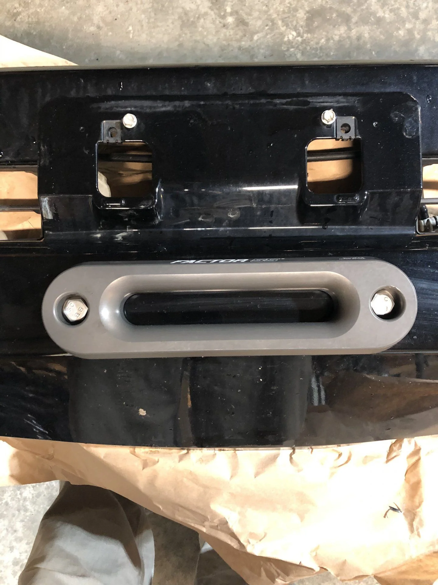

Bolt your fairlead to the outside of the bumper skin using these holes.
Now take a sliver sharpie (well, my rig is black, so silver worked best, if you have a light color rig, use a dark sharpie) and trace the outline of the fairlead with a strong line (1-2mm ish).
Note that the bottom horizontal line across the fairlead is beyond the bend/return in the bumper. You need to eyeball this line to ensure that the fairlead will fit through the hole.

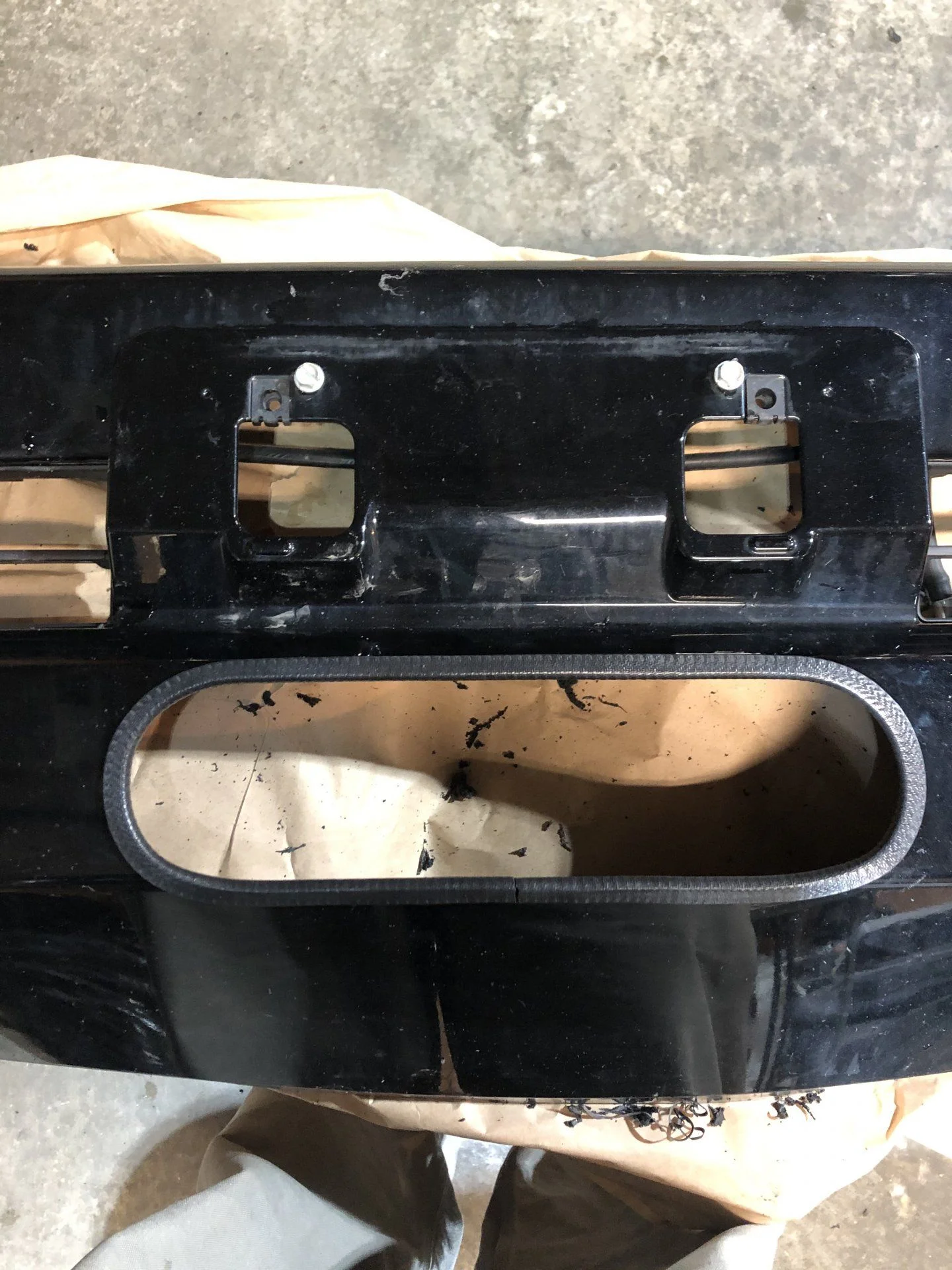

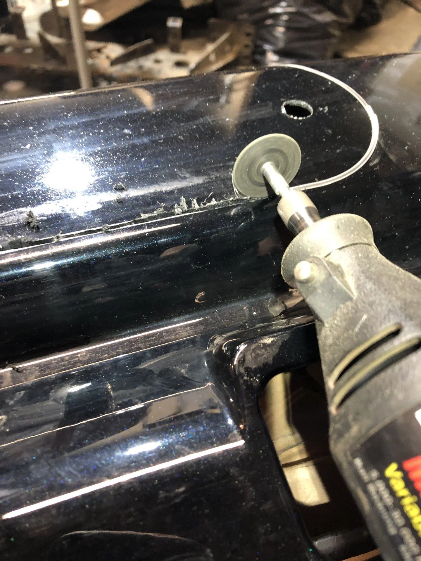

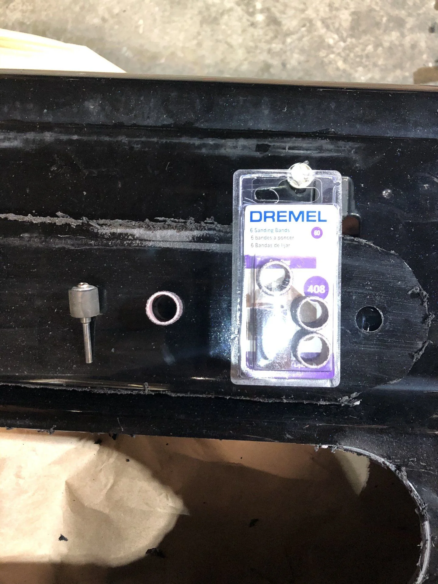

Remove the fairlead, and use the sharpie line as your cut line. I used a Dremel with a fiber backed cutting wheel on medium high speed to cut the outline, and a medium grit drum to finalize and clean up burrs.
If you are going to use a trim to finish the hole.
Important tip (thanks @Fishinsea) your finished cut line should be to the outside of your marked line. This will give you the ideal amount of clearance.
Now with your cut line cleaned up, install the trim.

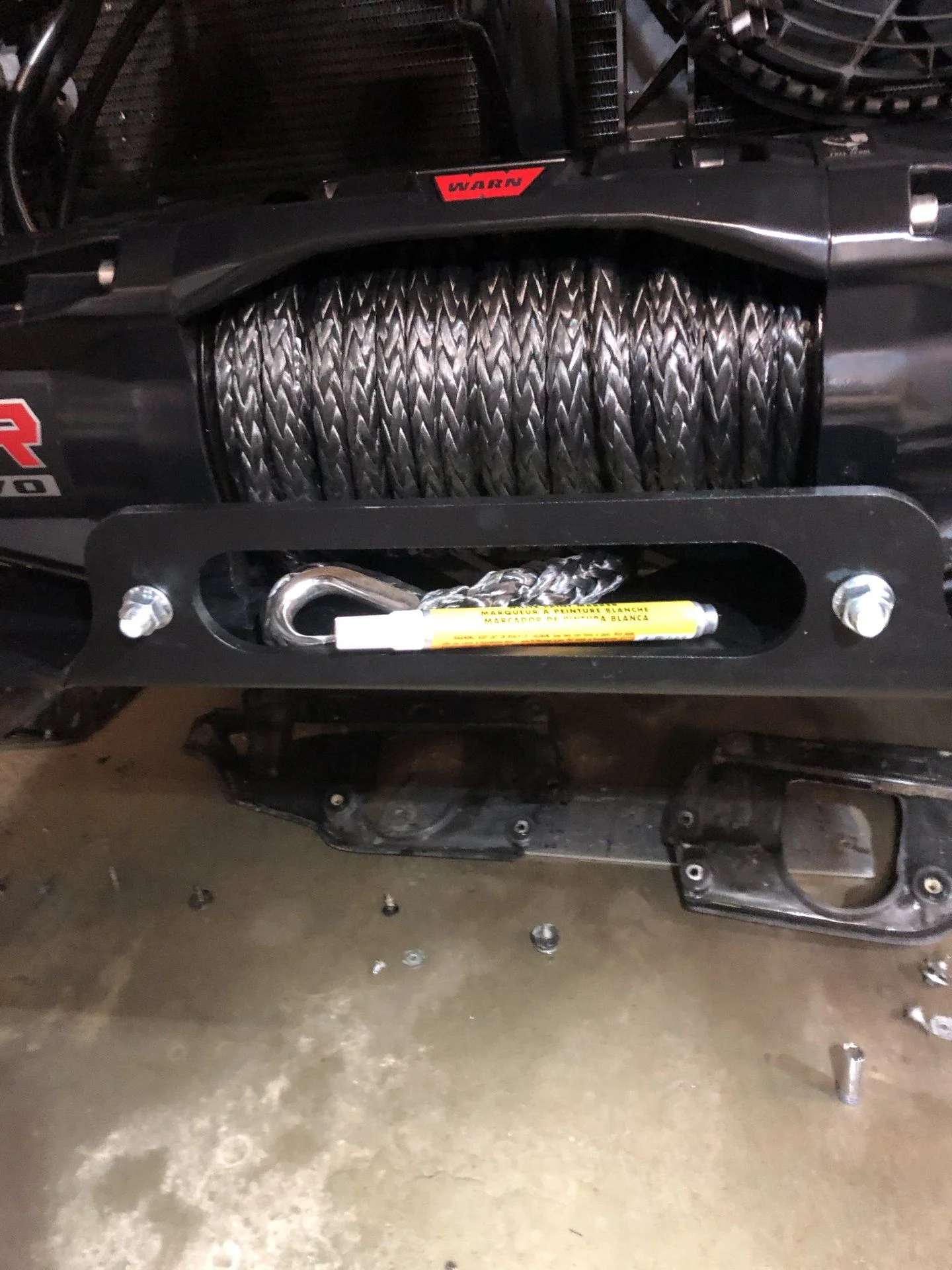

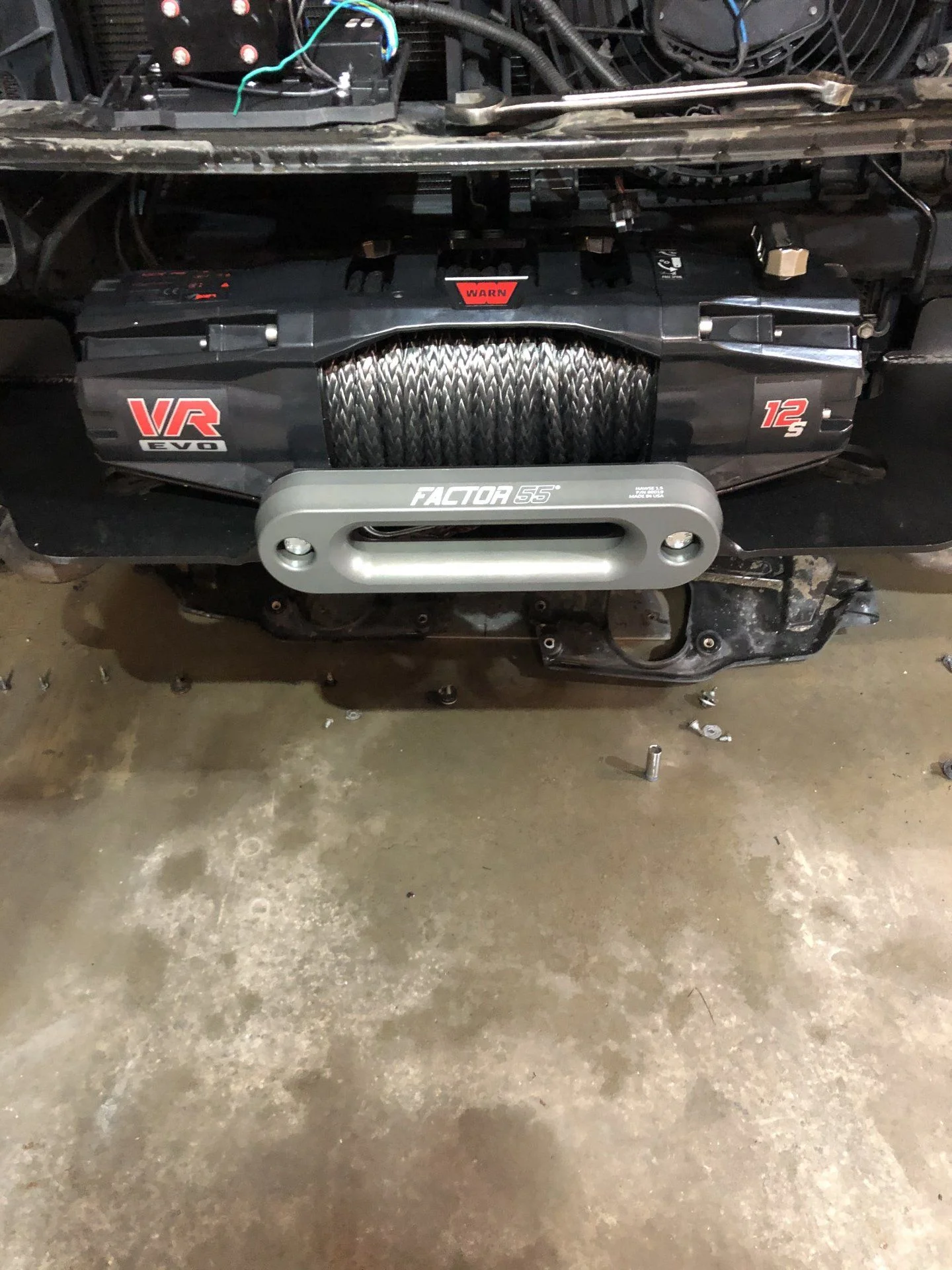

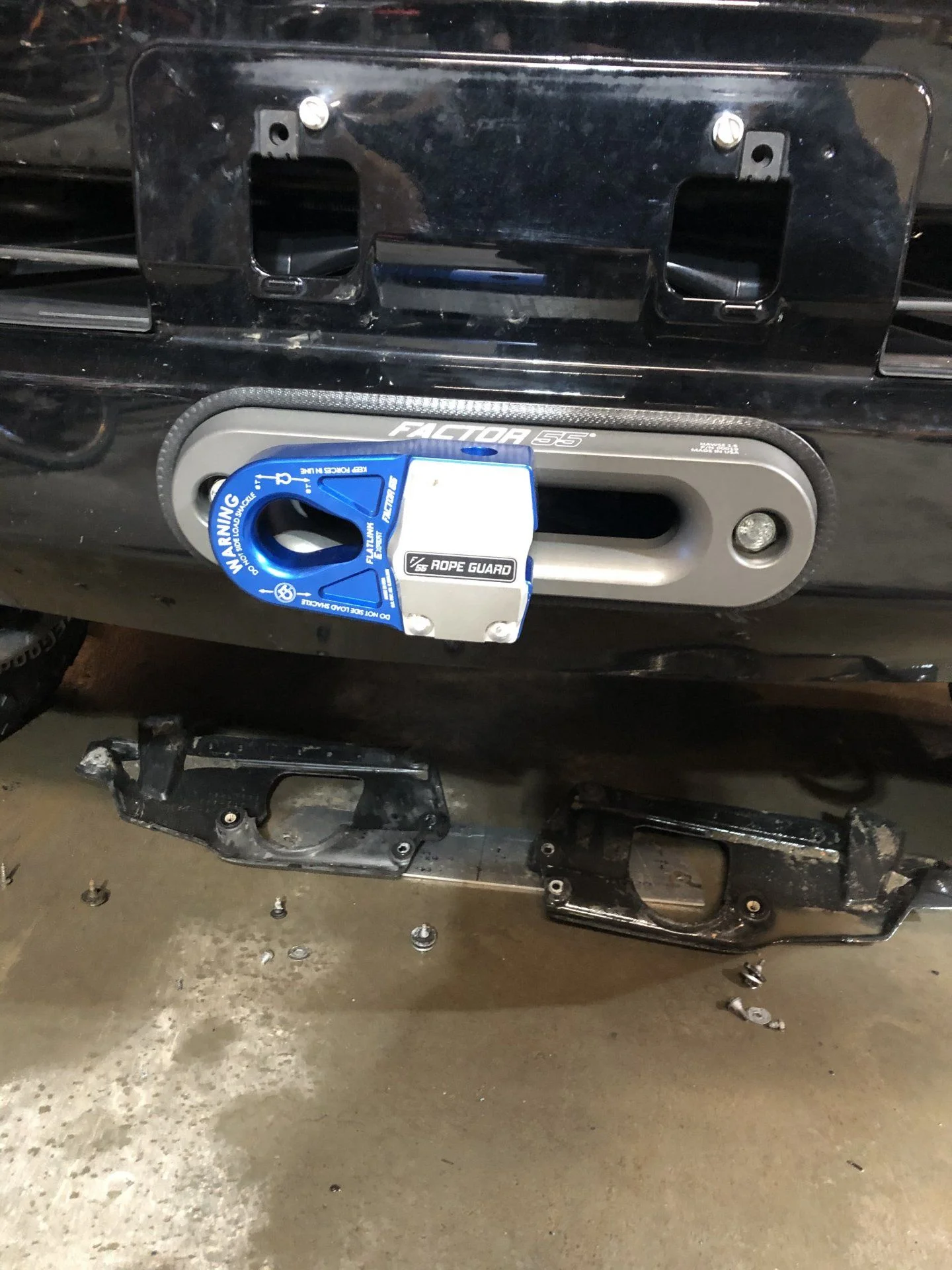

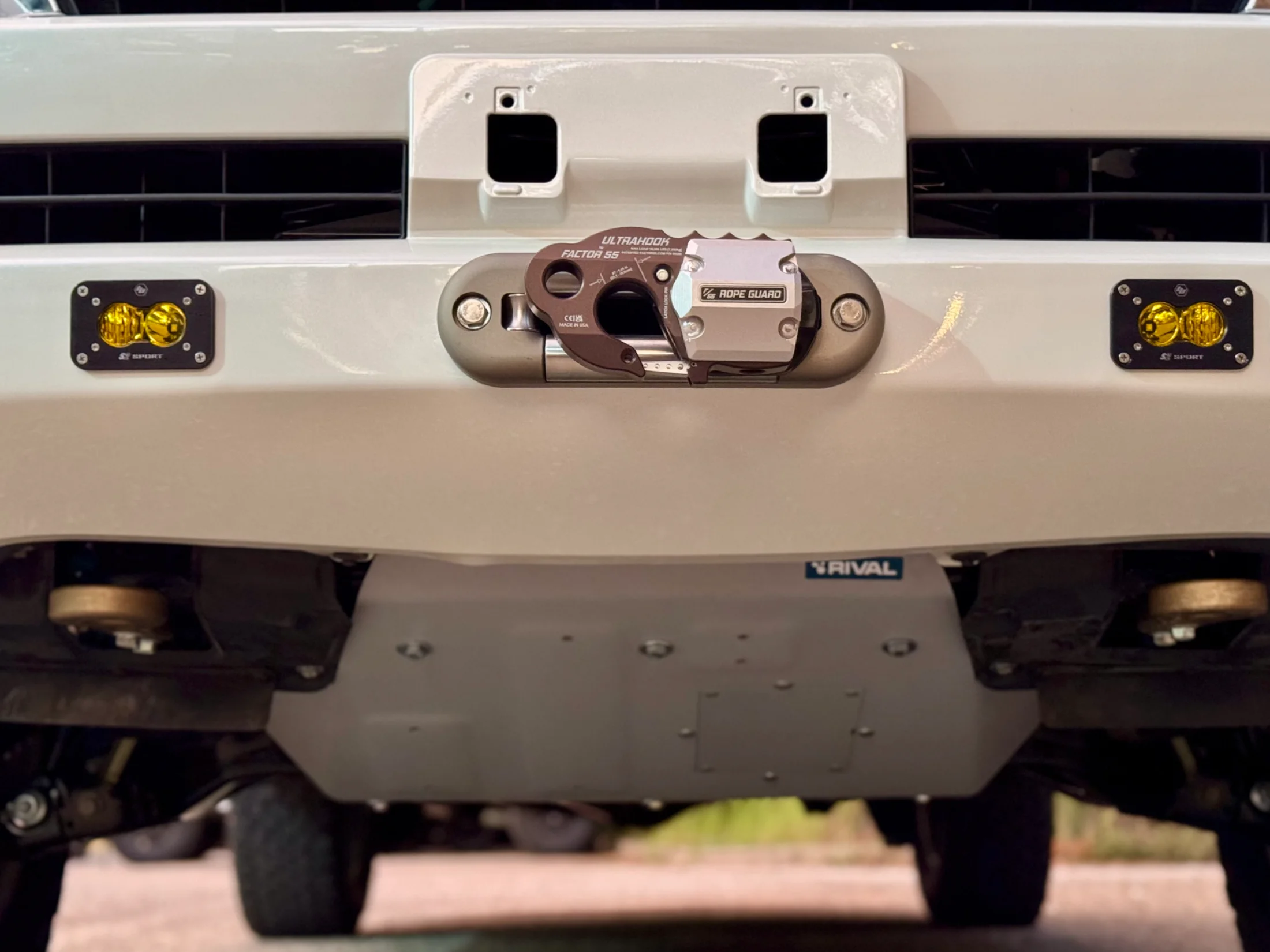

Install your fairlead. Used a longer bolt than supplied with the winch,but yours will depend on your winch and fairlead choice.

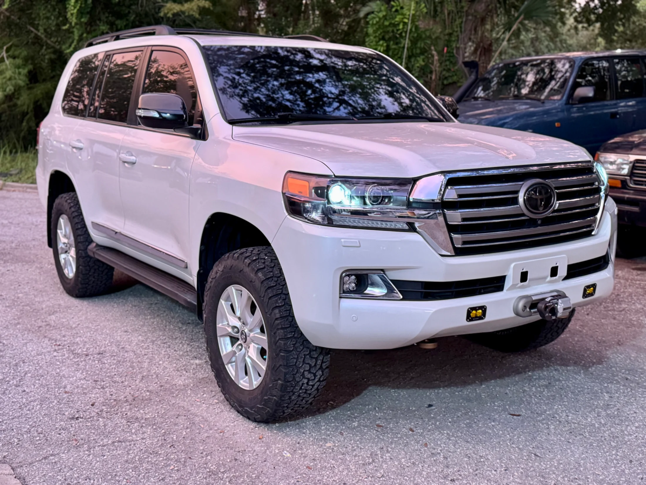

Now put the bumper skin back and test for the opening. Mine fit perfectly, but if yours doesn't, take it off and adjust your opening until it fits.
Reinstall the bumper.
Attach your winch hook.

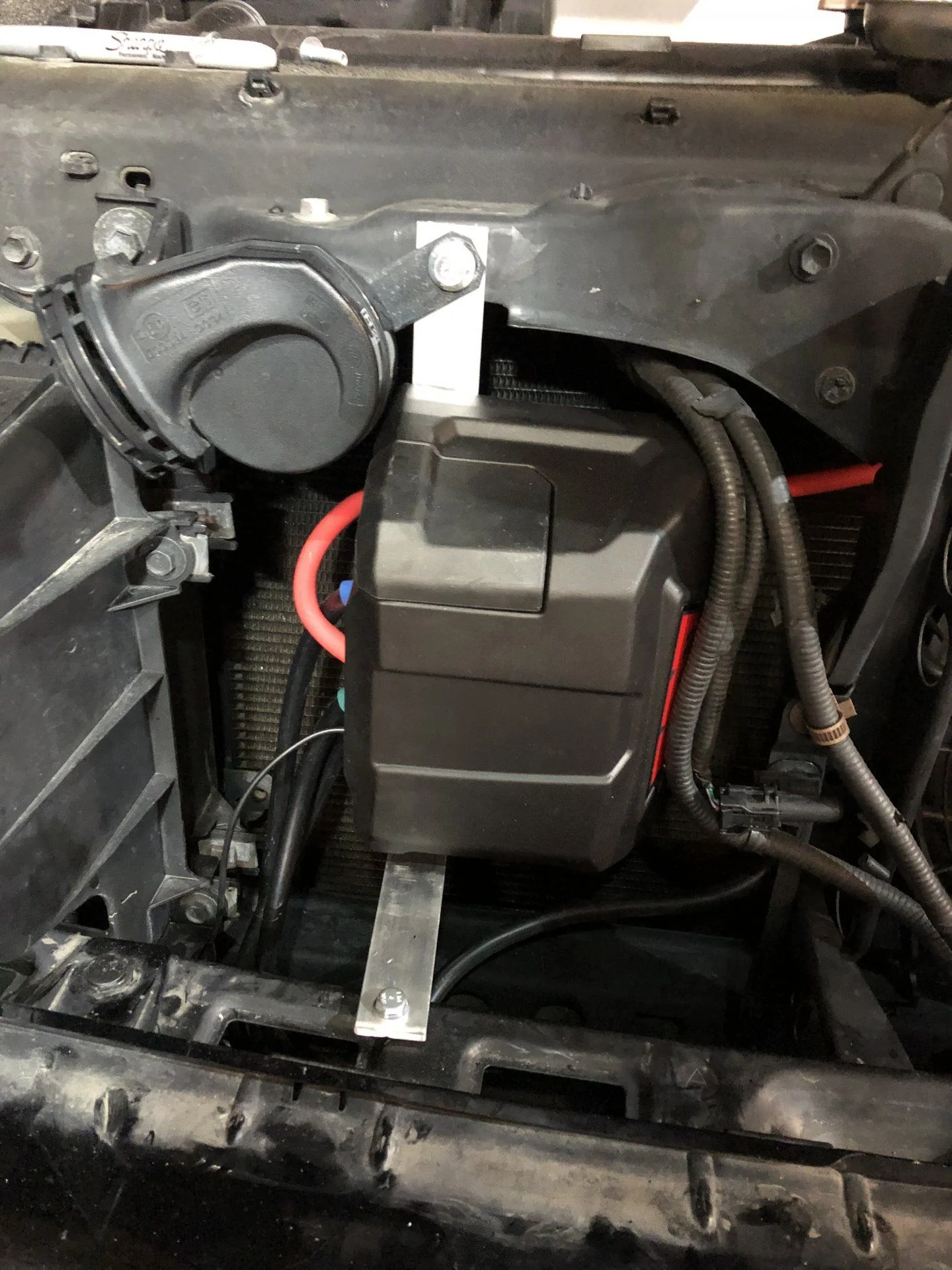

I opted to install my control box vertically (I saw this on a video at a vendor called Vivid). I made a simple L shaped mount out of aluminum strap. I attached the control box to it, and reused the horn mounting hole and a nutsert that I installed in the radiator support.
I don't love how the horn is situated, but it should be okay for now.
Wire your winch based on the manufacturer instructions.

One added thought: some people advise cutting a section out of the horizontal radiator support to ease access to the clutch lever. I found that I have plenty of room to access the clutch lever without cutting anything, but I'll watch it and may someday go back and open things up, if it is challenging to access in real world situations.
Awesome. Thanks for the detailed installed info. The fairlead cutout is fit to a T... nice tip. Also enjoyed that hydraulic lift table, I have the same and it's helped on so many occasions with heavy lifts.
The Warn VR12S sure fits like a glove.

The Warn VR-12S Evo is 73.6 lbs. The HWM is 26 lbs. All told about 100 lbs

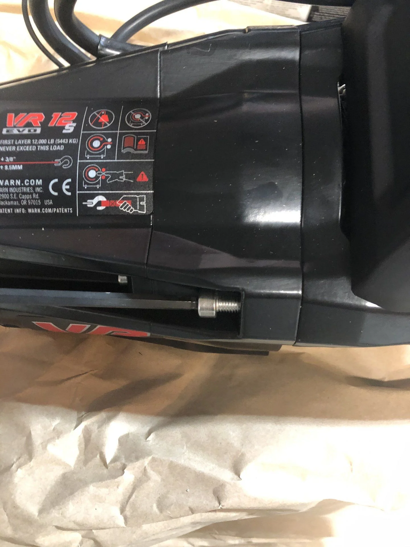

Do the VR series Warns come with the rope already on the winch?
The rope was installed on the one I received. It has instructions for "before first use", pretensioning or something (that I still need to do).
Ok, The Zeon line comes with the rope un-installed. You need to stretch the winch line before the first use. Important to get the first wrap or two seated properly.
