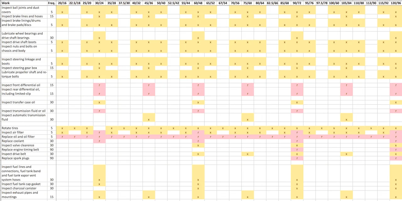

I would appreciate if anybody could tell me if I am missing any major component from the following base-line checklist.
I am trying to group it into logical units, so labor time/cost is kept at a minimum.
Current setup
2000 Landcruiser with 193k miles (born in CT, some rust, now living in CA, USA).
No service records, an initial assessment showed the only major/immediate service needed was alignment and new front tires, which I took care of already (matching Toyo Open Country 285/75/16).
The LC came with OME torsion bar, springs and shocks of unknown model (almost no lift, can't read marks, suspension setup is approximately 3 years old).
I bought the FSM and cross-checked with Toyota's official maintenance schedule and this forum (as much as I could read, including other base-line posts and linked articles like Slee Of Road's Newbie Guide).
Goals
This will be a weekend driver/errands around the city until base-line is complete, then road-trips and some off-road for 2 years(very light trails, no rock-crawling or mudding whatsoever), while I take care of all the "little things"
and make up my mind about building it so I can safely take a road trip to Anchorage/Alaska during summer (no camping, sticking to motels/civilization/paved or dirt roads with the occasional rough spot taken very carefully).
Baseline checklist
Cleaning
