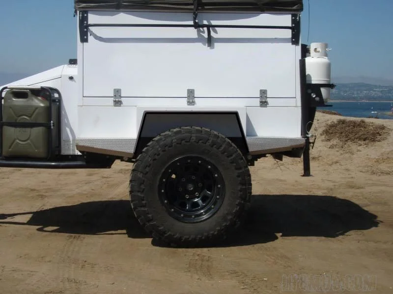

The batteries may go right in the front where I have the black battery bo thing sitting in this pic. Not sure orientation. Just in that area somewhere like everyone else does.
Would you be able to add some 1 1/2" tube framework somehow to mount the Yakima bike mounts to over the front? I plan to bend it up and go across the trailer and front to back as well to mount everything on top.
Ideally I'd like the tent pushed to the back, opening off the back like you have it. Then have enough room on the front still to carry mountain bikes. The bike trays are about 52" long so however far off the front that puts the tubing. Just looking it should be just about perfect to have them tie into the front corners of the trailer with vertical supports?
This same 1 1/2" sq. tubing will be used throughout to mount the tent and any other rack type set ups up top. The Yakima 1A towers don't grip the rain gutters well enough so they are going to be toast for the tent. I'll end up making some mounting brackets to attach the tent directly to the 1 1/2" tubing.
My original plan was to try to keep the Yakima towers in place on the tent, and keep the spacing identical to the roof of the 80 so I could easily take the tent off the trailer with my ceiling hoist, then throw it on the truck for those times I'm not bringing the trailer. Those times will probably be rare so I'll just re-mount the Yakima stuff for the truck if the need arises. Not a big deal.
Like I said, this thing is becoming a do-it-all trailer so it may end up I'm trying to tie too much into it. But for now, let's max it out. :cheers:

Same thought I had after watching so many trailer builds trying to make latches/lift supports/sealing them up, etc. Just such a nice package all ready to go if you just build the rest of the trailer around it, or just make a fitment ring type thing for the top of the 416. Something that welds or bolts to the trailer that transitions to the dimensions of the topper.
Maybe it's just too big for a 416, but for a scratch built trailer seems like a great way to go. Who knows. Good luck either way.:cheers:

Ready to go pick up my axle tomorrow. Varying opinions from my local supplier vs ABC Trailer. Told ABC what I was making(3500#, 35" tires, single axle etc). I asked about simply taking the stock length, pre-cambered axle and flipping it over and mounting new spring perches to keep the camber correct as a sprung over. He said unless I planned to have the thing fully loaded all the time, that a "flat" axle would be the way to go.
I need an answer, in 10 words or less, should I be getting a flat/straight axle, or make sure I have it cambered correctly as a sprung over?
Does that makes sense?
Thanks. (Again).
And it looks like I am going to start from scratch with the trailer frame/axle and build up from there. Scrapped the idea of modifying the current trailer. It stays as a leaves hauler and garbage mover for now. :)
