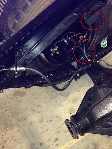

I've got just 1 question. It could be camera angle or it could be just me, BUT in post #177 you have this...
picture. It seems to me that in an event where the leafspring bottoms out against the stopblock, your brakeline gets squished???

I you have a good eye mate as I did look at that and had the same concern with the brake lines. When I get it all back together I will have another good look at it and see how it looks. If I think that this is going to be of concern once she is up and running I will drive it down to Cairns where I got the brakes done and get them to re-do those lines.
I'd also get them to put some nice curves in the hard lines off the cylinders.

Yes he has a good eye to spot the brake line.
