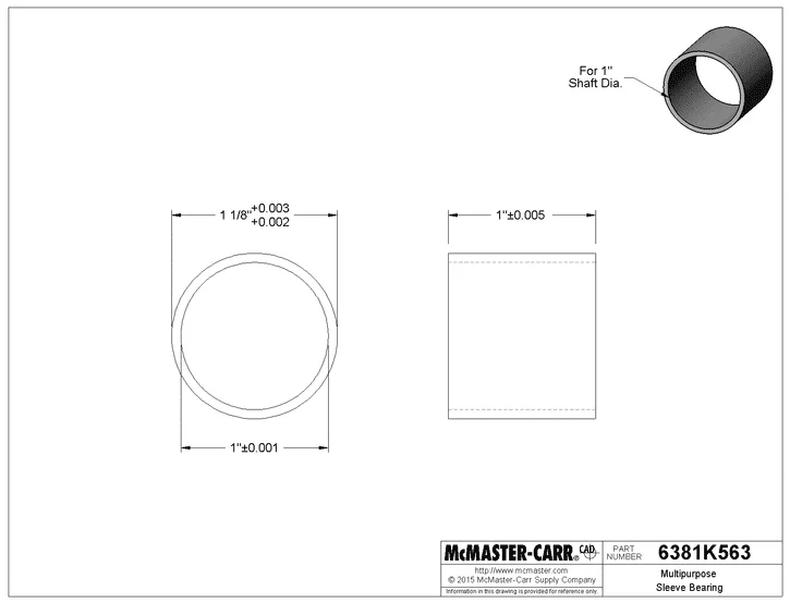

A couple of these beauties and some JB weld and you should be good to go.
McMaster ship same day you order.
