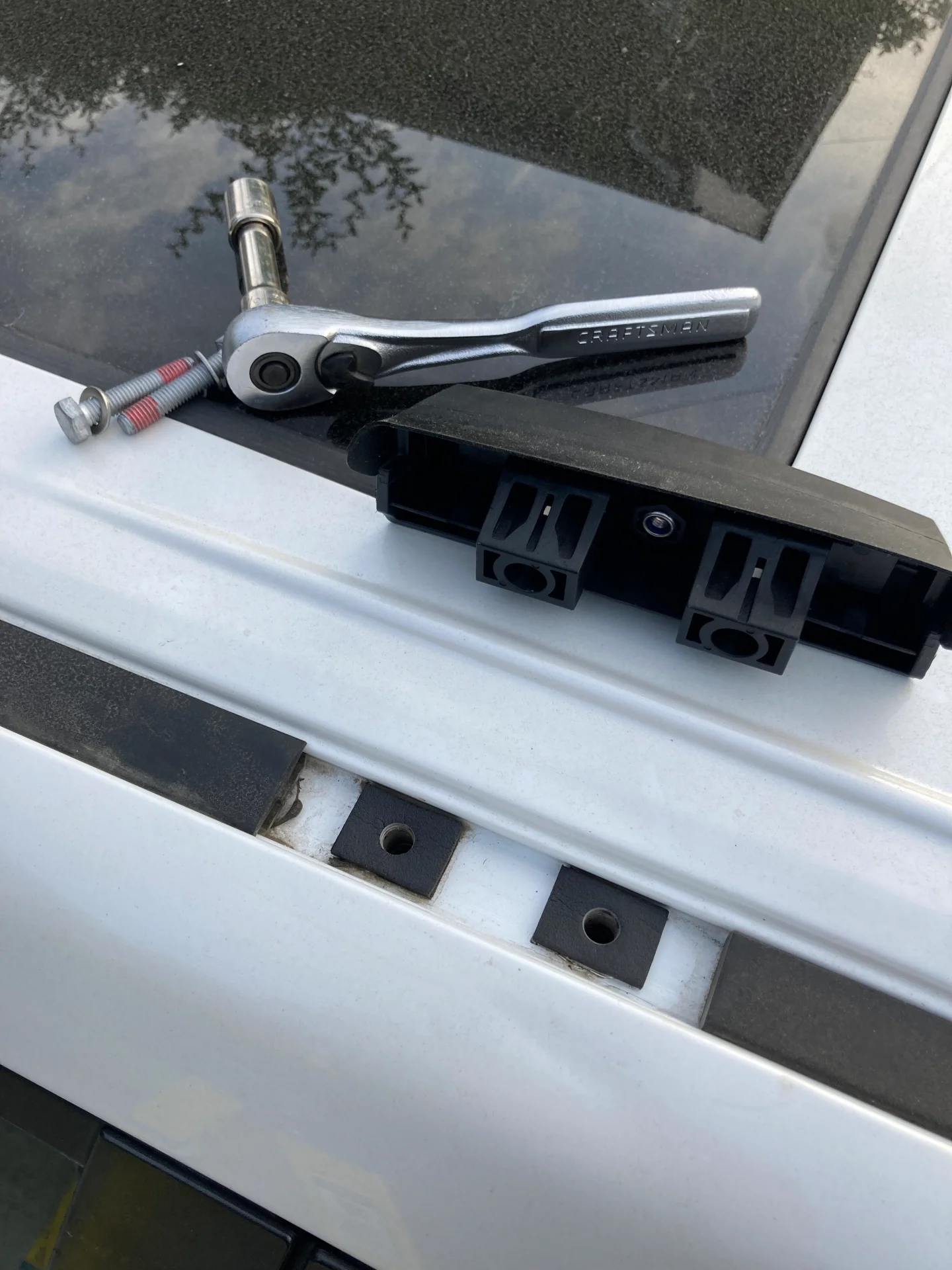

Install steps:
1 - remove flush rails

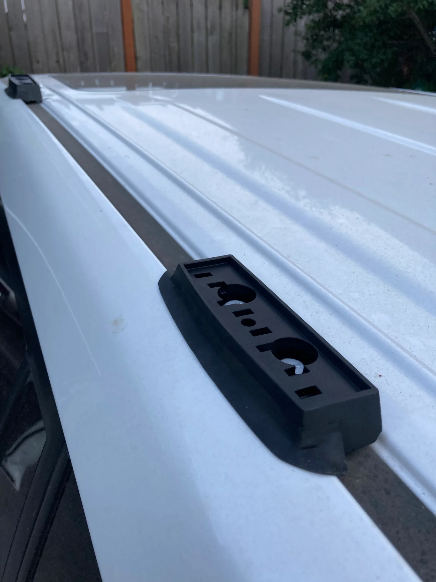

2 - open, follow instructions for the Prado fitting kit - 2 screws in each of six mount locations. Note each pad has a specific location.
3 - attach the leg packs (unlock to mount)
4 - attach support system for bars or lock n load platform

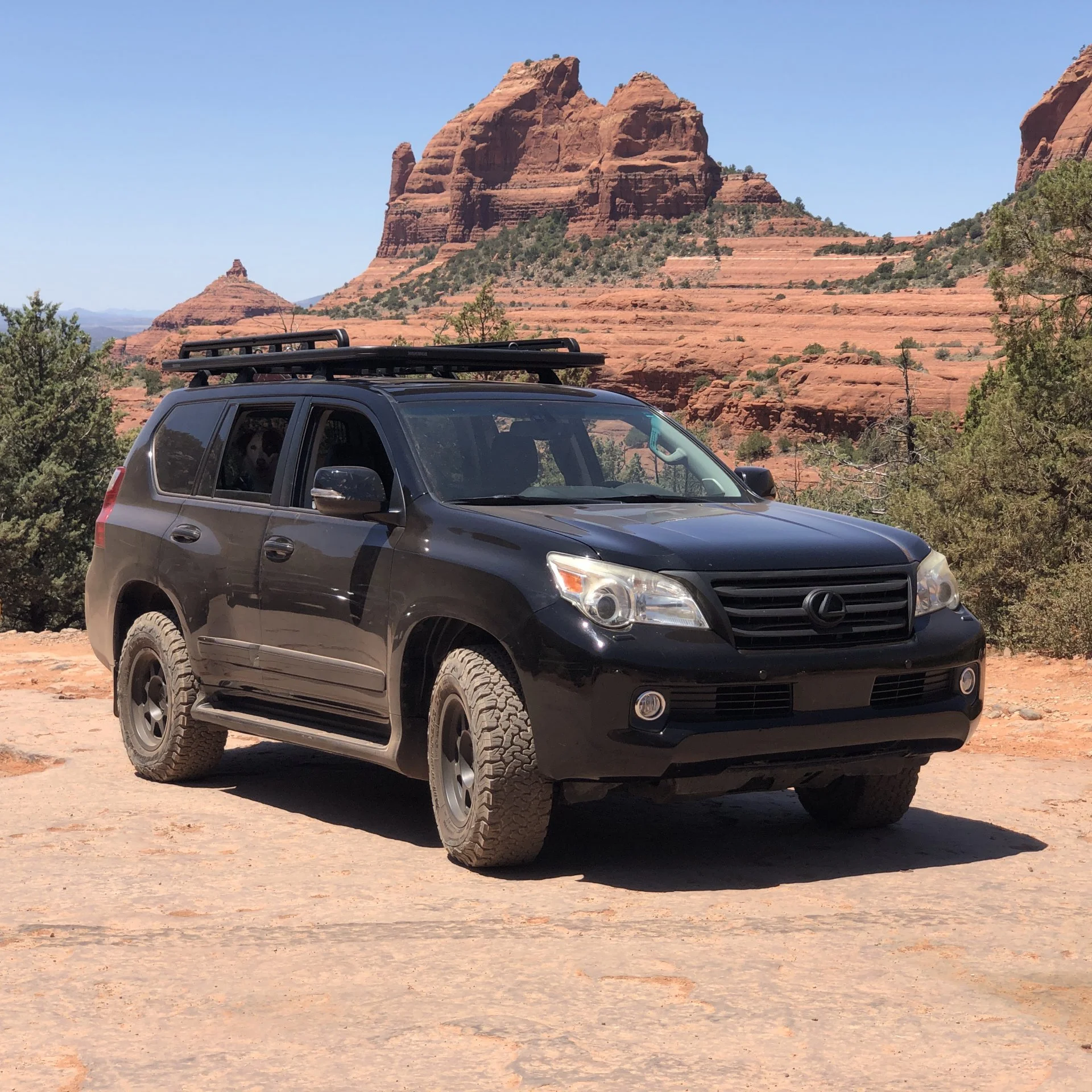

End result can be something like this (I like it and pretty close to roof):
Jake McCurdy is running similar system with Aussie towers.

Install steps:
