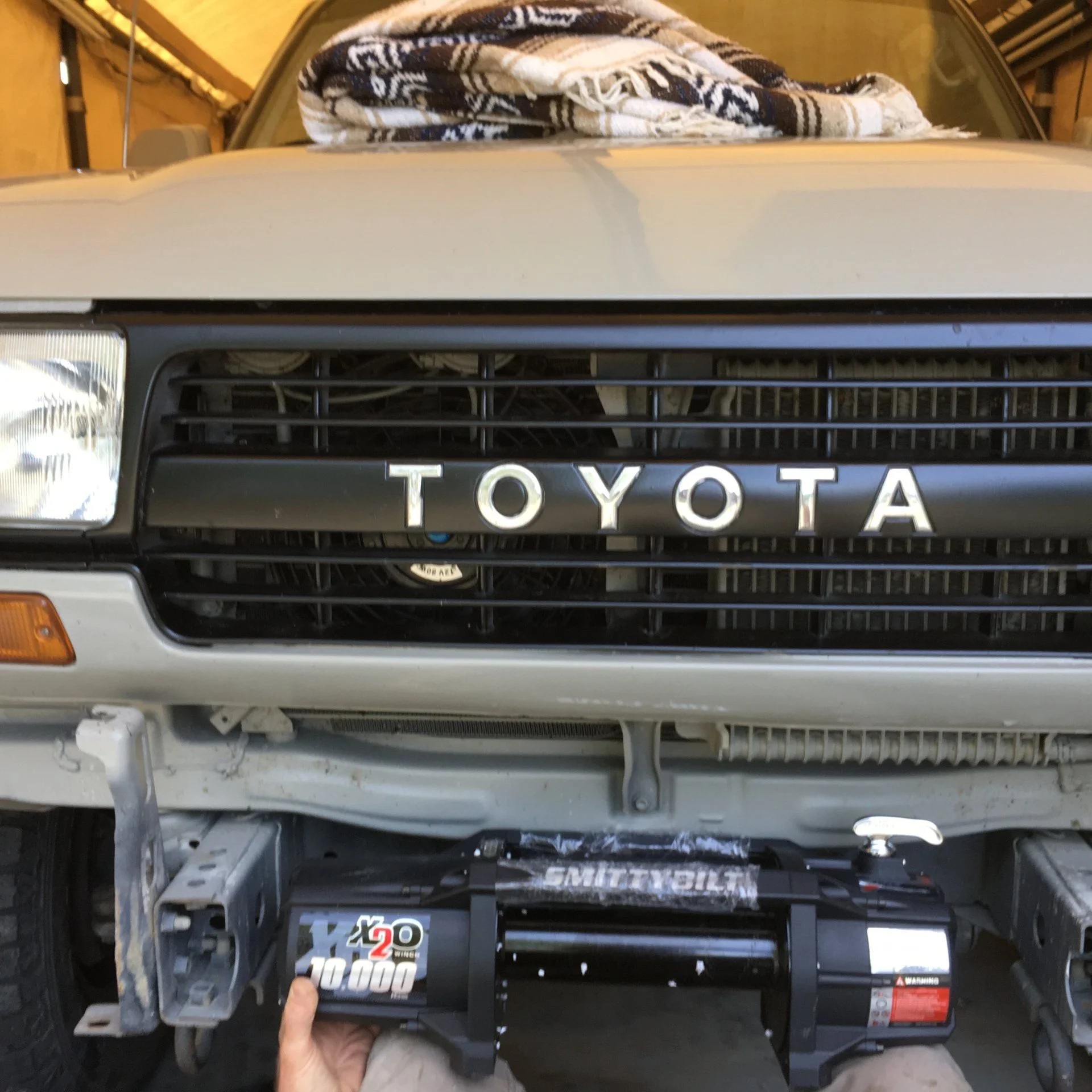

X20 mounting on stock 80, clutch access?
Mar 1, 2015
98
822
Oroville, CA
Just doing some Initial planning here for my Smittybilt X20 10K, which is going on a fJ80 behind a stock bumper. It looks like the clutch engage switch on top is gonna be very difficult to access under a stock bumper has anyone done this before?
My thought is that I’m gonna have to takeoff the chrome plate on the top part of the bumper (and toss it) and bore some kind of access hole. Ideas? The switch is a 3 way job that sticks up about 2”

Update: the clutch works great when accessed through the vent holes, pretty certain that is why Toyota designed it that way. bumper trimming and paint will resume this weekend, winch is on and functioning great already. Will be customizing with flip up license plate mount to hide roller fairlead, popping in some flush mount fog lights, and cheap LED off road lights on top.

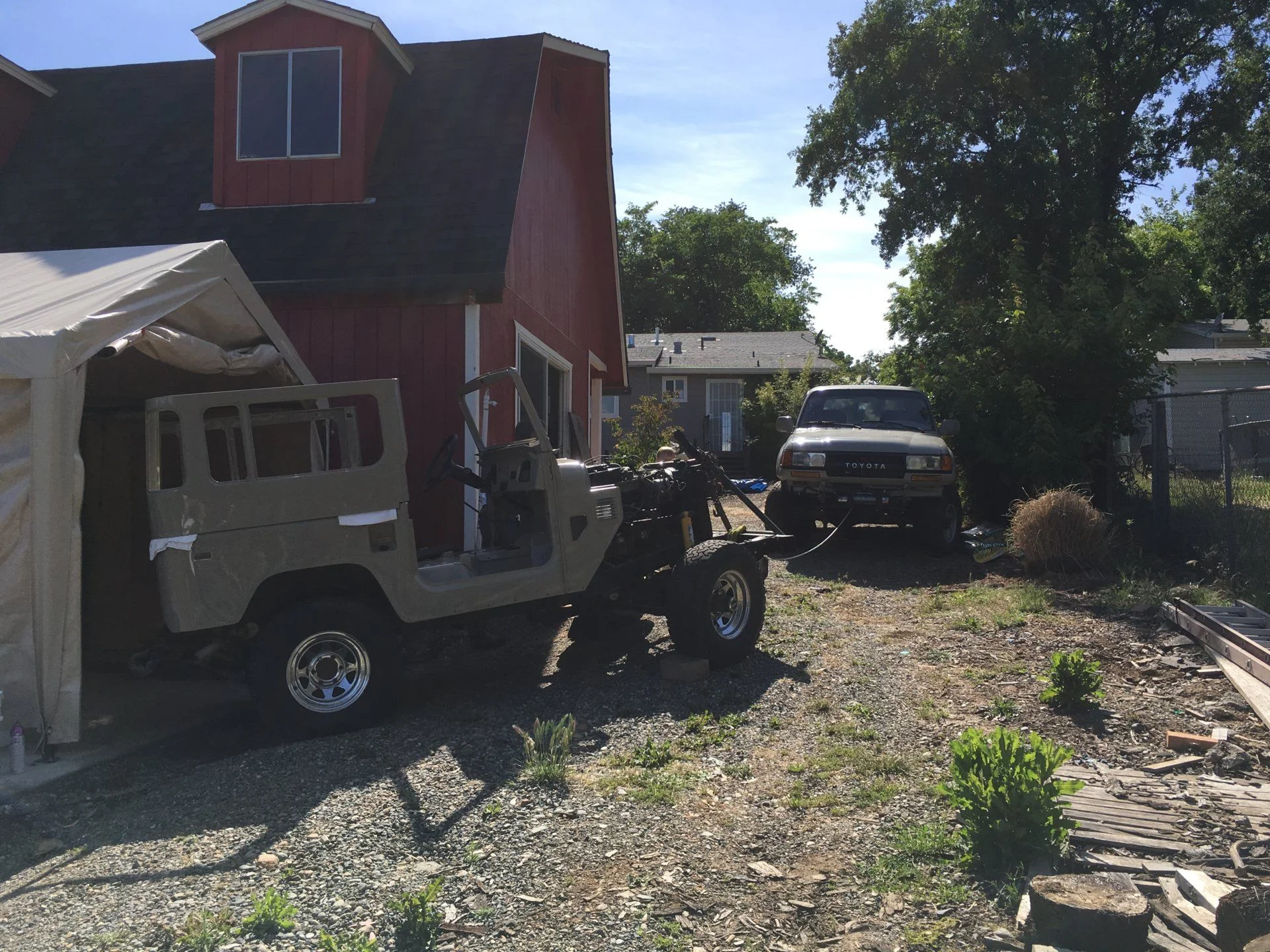

I would add that the OEM is no bull bar but it is also not as cheap and flimsy as you make it out to be. I actually ran it over by accident during the install with no ill effects to bumper whatsoever (just pride:bang:). I don’t doubt that eventually I’ll upgrade but I’m definitely not running around nervous while driving that my bumper is not adequate. And finally, the 40 you see pictured below was my high school ride from the 90s. I put a grill and brush guard on and when I rear-ended a truck it was the bumper upgrade that bent back and took out my headlights and dented my bib and fenders. Dad and I just ordered up a new OEM bumper for it, the resto wouldn’t be complete with out.
