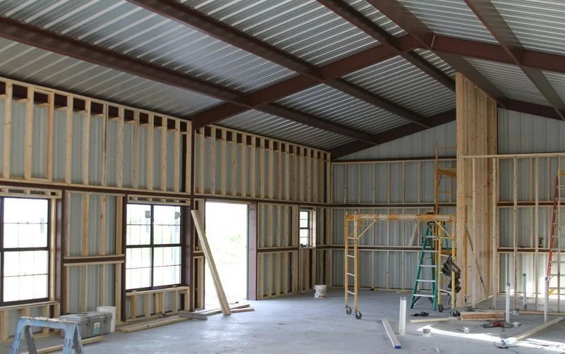

Typically they put metal girts between the frames and then just do vertical metal siding - like this:
The panels span top to bottom, so it's pretty economical with the girts. The T-111 would be vertical as well, so you could basically do it the same way. You might have to put in more girts depending on the span length of the T-111 you're using.
There are vertical HardiePanels that would also span vertically, so they would be virtually the same:
Again, you'd have to check the span length and adjust the girts accordingly.
If you mean one of the horizontal HardiePlank or HardieShingle products, then you would need vertical supports for the material to span across horizontally:
At that point you'd basically have to build a "standard" framed wall (metal or wood stud) between the steel frames for the horizontal siding to attach to - which lessens the economy of the construction. People do this for interior finishes, so it wouldn't be much different to apply the exterior (horizontal) finish to it as well.

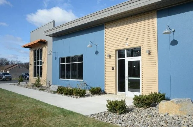

Another option would be an insulated metal panel system. Manufacturers like Metl-Span offer a number of "architectural" panels that could potentially be combined for a look different from the typical "pole barn" siding.
Here is a combination of flat, horizontal, and vertical ribbed panels. But you could just as easily combine them top to bottom as side to side.
