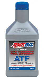

The new Amsoil ATL full-synthetic fuid is recommended for WS.
AMSOIL - Synthetic Low Viscosity Automatic Transmission Fluid (ATL)
I've been running their ATF and have been very pleased.

Problem with Amsoil is that I can't find any importer or dealer in Norway.
