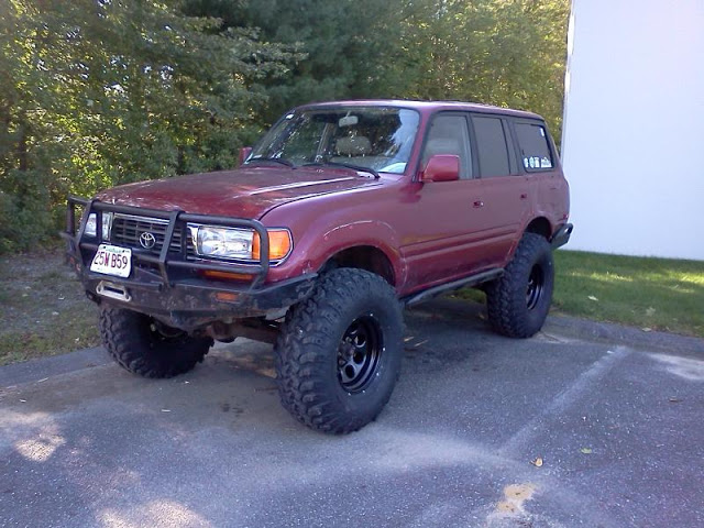

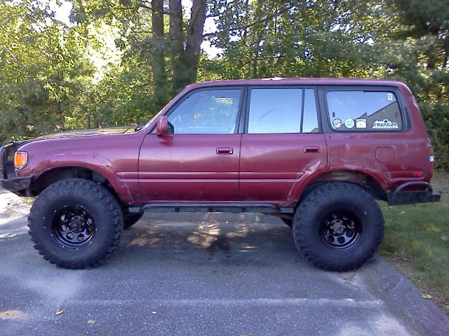

I have seen a lot of 80 series rigs & this this super low geared red 80 on 40"s just screams out to me "Hardcore 80".
@Wrench here on mud has been a member since 2003 but never did a build thread that I know of. I guess it wasn't cool back in the day. So his build is spread out over hundreds & hundreds of pages on ih8mud. I have learned here & there while doing searches that his "Red Macine" is worthy of a build thread.
I'm posting this up so others can see & enjoy this Red Machine.
This is what I know so far. If it's wrong let me know:
6" Slee lift
Stock bump stops
12" Doetsch Tech 8000 series shocks
5:29s
Marks Crawl box 112 to 1
40" IROKs black steel 17x9 4.5" BS wheels
Chrome moly axles
Hydro assist steering.
