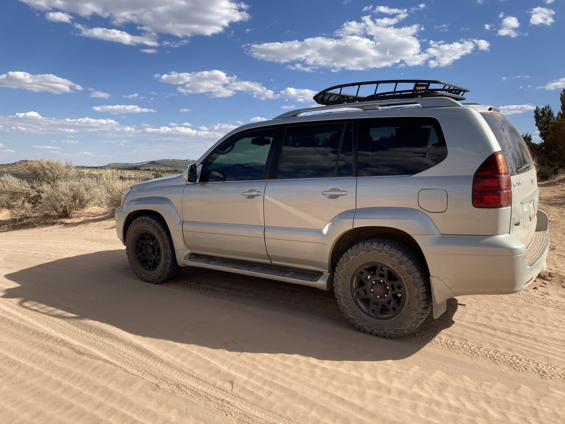

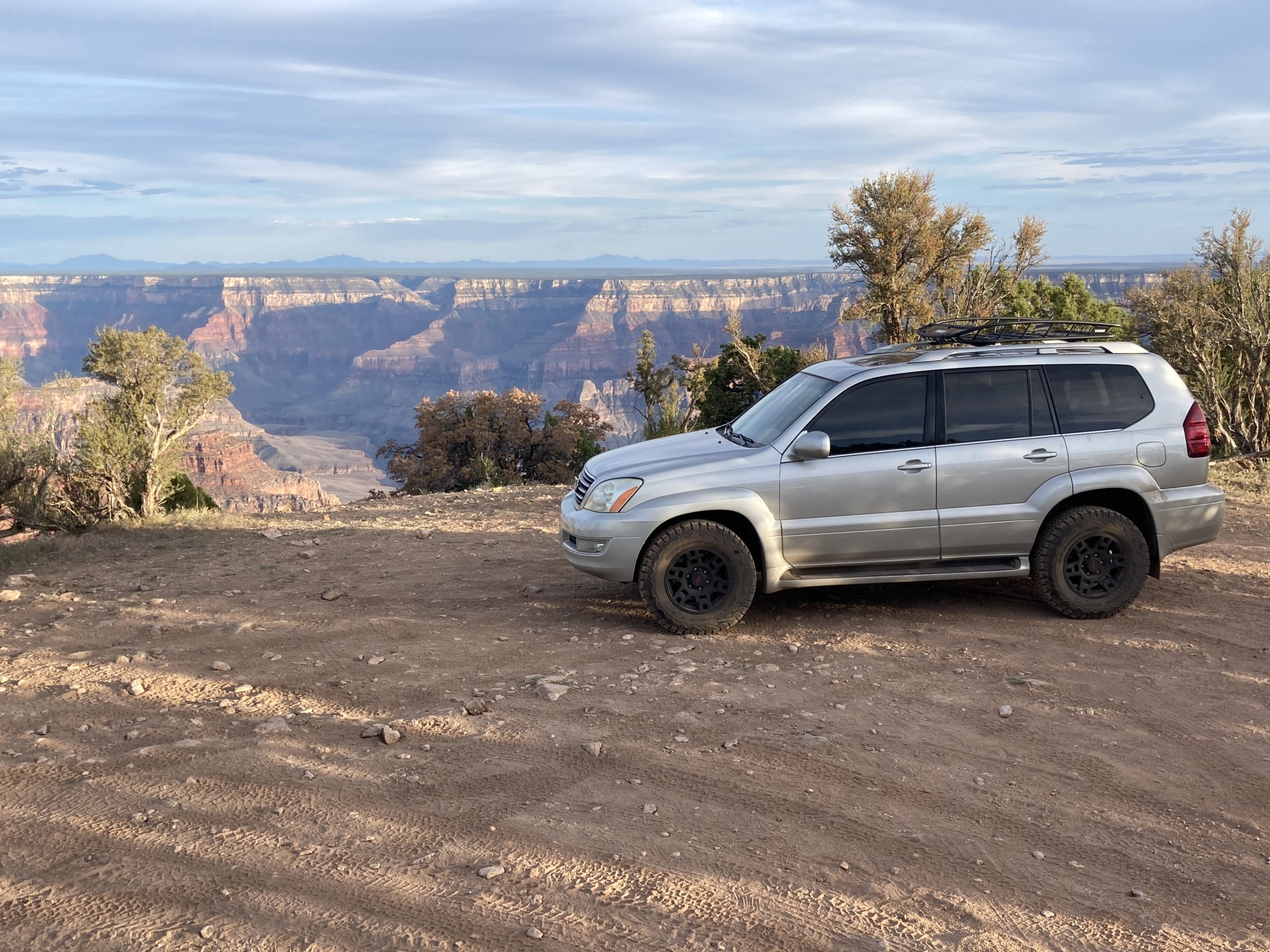

Also, I'm a bit particular about wanting to get this one fixed, given the fact that it got me across the country and back last summer.
