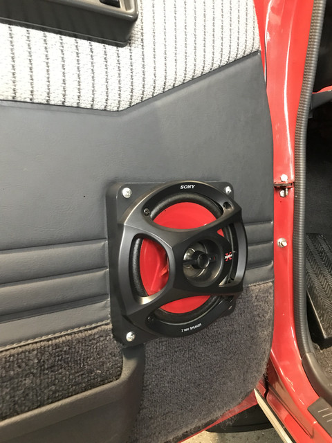

Reposting my wanted ad from earlier in the week with more detail.
I know this whole request sounds a bit weird....I'm just trying to creatively solve a problem.
Here is what I need: A single FJ62 front door speaker grill (either color... and broken tabs are OK) so I can have it put into CAD and then 3D print a replacement set.
-Do you have a cover for sale? Ok... please give me a price.
-Do you have one sitting around that you can send me? That would be great!!! I will have it recreated in CAD, send your original back, AND send you a complimentary pair of the replacement covers in gray (not sure I will be able to do brown). I will pay all shipping.
I'm not doing this to make money, although I wouldn't rule out making these available to the community to recoup the CAD costs and time. The main reason is that I am preparing a beautiful FJ62 for sale. 57k miles, all original paint. It's an amazing truck and I would prefer to remove the aftermarket Sony XPlode speakers in the door for an OEM looking pair....that's the only reason I am attempting this exercise.

The bad thing is you are going to have holes in the door panels that won't be covered by the factory grills. But you could recreate a factory looking grill in a larger size. There are a lot of people who would want that as many people are in the same exact situation as you are.
My main goal with this vehicle is to make a suitable replacement that looks like it could've been OEM. The marks that the aftermarket speaker left are definitely larger than the OEM grill. I plan to make the replacement just large enough to cover that area on the vinyl part but probably stop it from going down into the carpet area (to look similar to OEM) I'm confident that the carpet will spring back and you can't really see the screw holes there anyway.
It'll take some testing but I think I can find a nice solution. I might have the designer put screw holes on this as opposed to printing/using those lock-in tabs.
I hope to receive the part in the coming day or two and knock it out. Keep you all posted on progress.
