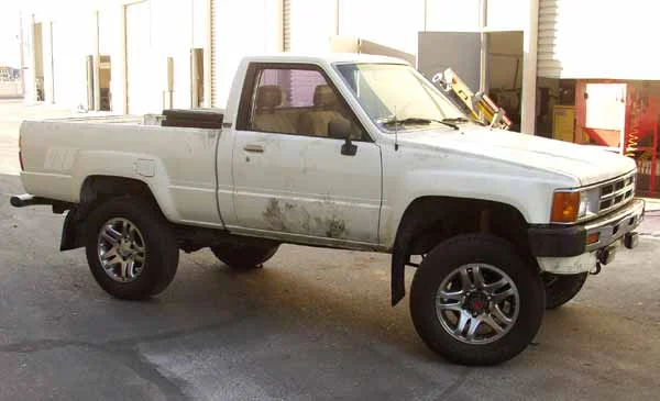

My '90 Runner with Tacoma rims and the '84 with the Tundra's. The 17" rims are large enough to clear the tie rod end on the early axle, but still need spacers. Sorry about the mess, I bought it that way and hadn't cleaned it up before shooting that pic! :o
So with 17" rims , would I still need one inch spacers for the front ? And, on the 16" Taco rims I only need front spacers, right? Just making sure.
Those 17" wheels fit mine without spacers, so none are "needed" for them to fit on the truck. With more backspace the tires are in the wheel wells further, reducing the track width, so you may want spacers.

I think those 17's are 17x7.5 A little narrow if you plan to go a lot wider later.
They work well with my 37x12.5's!:D
