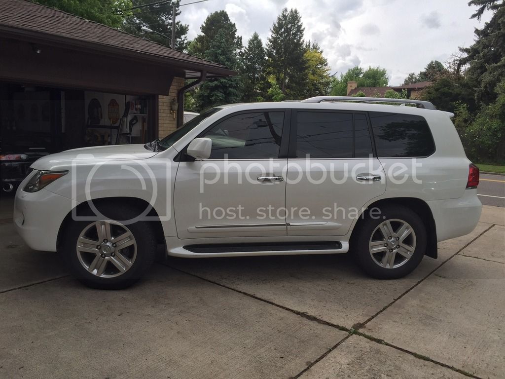

Not a 2016 but The wife's LX is running 275/60/20s with no issues and no apparent impact to trans operation. Fills out the wheel wells a bit more.

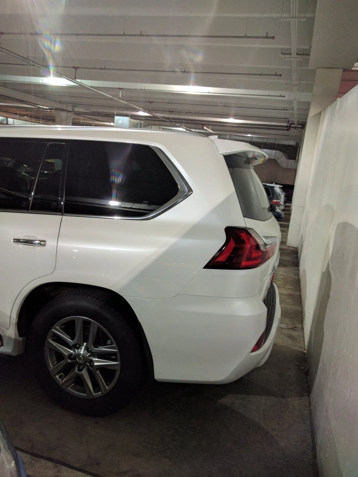

Sneak peek to my new wheels
What they are: Michelin Defender LTX 275/60-20 on 20" LX570 OEM wheels.
How do they ride: 9/10 in the comfort department and a huge improvement from the stock 275/50-21 but the stocks were a bit quieter.
Any issues: none whatsoever.... No rubbing at all with almost 1 inch between the tires and the front fenders at full lock.
Reason for the change: wanted better wheels for the snow and soft off-roading. Also planning a coast to coast road trip this summer and would love to take it through some of the canyons, mountains, and sand dunes.
Will post more pics soon.
