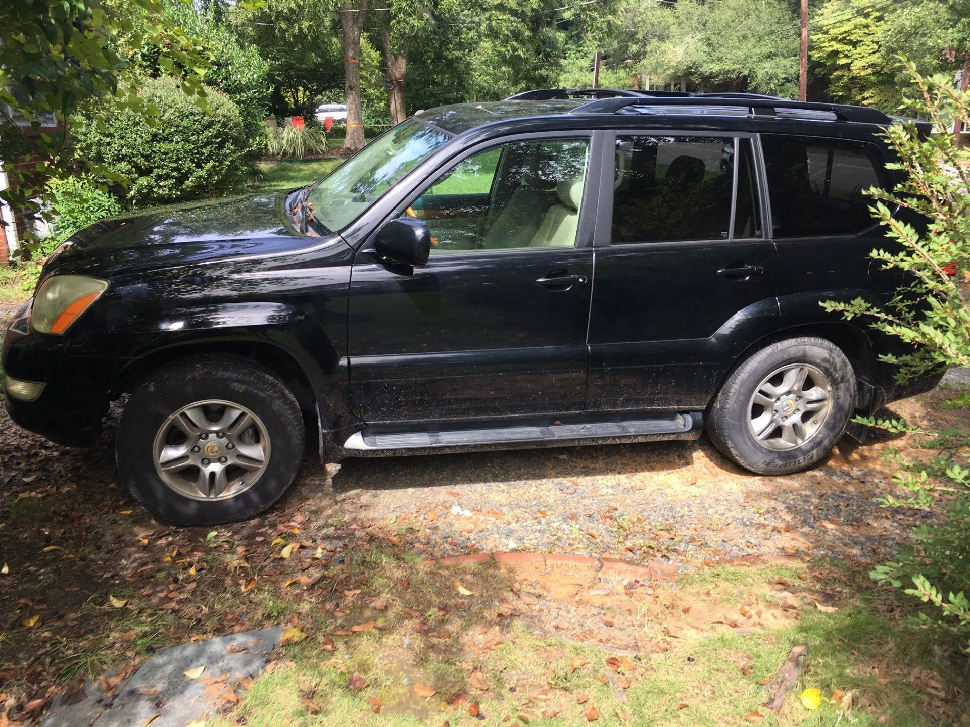

Hi Everyone. I've been lurking here for few weeks and decided make an account and introduce myself since I plan doing some work on my GX470 and I'd appreciate any input members here are willing to give.
I've owned my 06 GX470 (Black, non-KDSS, Nav, ML audio) about four years now. At the time I bought it, I was just looking for a truck that could haul a trailer for a move I was about to make, and then last me a few years after that. I came across a GX with 150k miles on it that was considerably less expensive than other options I was considering (mainly used 4runners). The dash was cracked and the front leather seats were showing signs of damage from baking in the Florida sun, but I was ok with that. I test drove it and bought it the same day. Fast forward to now (185k), the car is paid off and has served its purpose. The only problems I've had with it were one of the air bags got a leak and needed to be replaced, and just recently I needed to replace the alternator. I consider myself fortunate to have found this gem given that the circumstances that required me to buy it were less than ideal.
I've been wanting to get into overlanding/off-roading for a while now, and I've decided hold on to my GX and invest some money to make it moderately off-road capable so I cut my teeth and make all of the rooking mistakes in that before upgrading. I plan on doing a 3" lift and so far I've purchased:

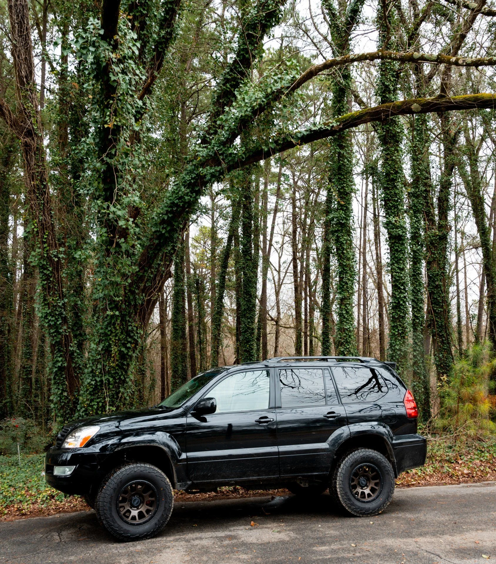

Here's an update since this thread got resurrected. I got the lift installed - went with the RRW RR5-V wheels and Falken Wildpeak 285/70/17 tires, replaced the major fluids, replaced the TB/WP and took care of the other service items. I replaced the alternator (Tucson Alternator Exchange 240A), cv axles (CVJs) and brakes (Power Stop GX460 calipers and EBC rotors). I also installed new Depo sport headlights and a Diode Dynamics fog light HID conversion kit.
Before:
After:

Incredible transformation! There truck looks tremendous!
Looks great, I'm sure it's a blast to drive with the fresh suspension and other upgrades!
Thanks! I was surprised with how much the handling improved, even with the lift added. There's a night and day difference getting on and off the interstate with any sort of speed with the new setup.
Lift springs are pretty well always a higher spring rate than stock, so less bodyroll than you'd expect with an increase in height!
