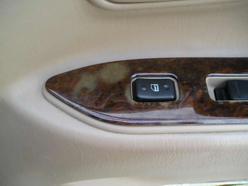

Here's a 98 LC

Right....but the thread-eee mentioned the OEM being garbage. Do you know whathe means?
Take another look at LC trim closely. Does that look good to you? How about add some warping to it. Discolored, faded, warped = garbage.

Wild! Man..if it's gonna warp it'll be in 200* AZ heat. :D
Dang...mine's fine. I do use furniture cleaner on it (sometimes).
I'm sure the LX's is better, though I'd not want the LX wood color. Don't like the red-ish tint. Like the dark stuff.

yeah the laminate wood sucks. the main problem is the acrylic coating tends to seperate from the "wood" paper.

Hmmm, that picture of the 98 LC fake wood looks familiar. The spots are worse now. Maybe if I wait long engough it will all turn gold colored and be a nice match for the beige interior. :grinpimp:
Only the front arm rests have the discolration. The back arm rests look good as new. Glad to hear others are having good success in getting them off. Performance products had replacement kits in their Toyota truck catalog. Had considered replacing, but now removing everything but the center console piece seems a good option.
Removed ALL of my faux wood this afternoon - I used a combination of heat from the heater, a hair dryer, and a metal putty knife with the leading edge covered with masking tape. Even with the masking tape and extreme care however the putty knife left a few (very small) scratches, so I gave up on it and stuck to the hair dryer and my hands. Just heat up the narrow areas of the faux wood, tear this area off by hand, and then work your way forward or backwards using the hair dryer to apply heat as you go. The narrow areas will come off almost immediately - the trim around the center console (where the nav unit/radio is) came off in almost one piece. The thicker areas such as the passenger door switch will take longer - just take your time and stick to a hair dryer and your hands to avoid scratches.
