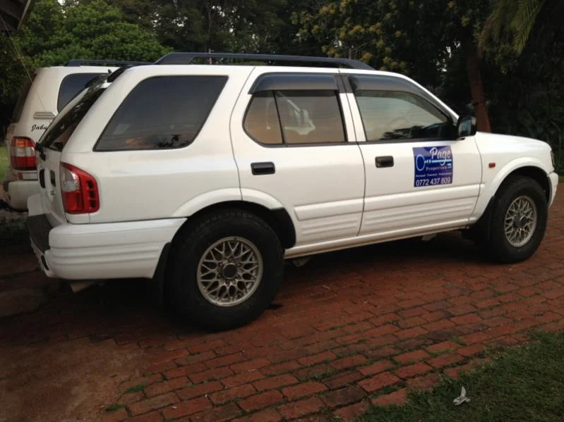

The Wizard was extremely dirty, owner chain smoked, and the cabin had been used to ferry potatoes to market... And so it began, we removed & cleaned & washed the bare inside & replaced the whole interior with what we had on the accident vehicle. There was some damage to the "new" Wizzard on front and back, must have had a fender bender, so off came the front & back end, and we replaced the front crossmember, repaired the grill, headlight, indicator light, back right lower quarter panel & rear bumper.
We replaced the back door & window, the replacement bumper had rusted insides so that was swapped out with the original, and everything went back on...
When changing the back window we found a rusted hole by the back right shock window mount so we torched that & in went new steel & when that was done we sent it to a panel beater who took out a few minor bumps on the bonnet
After a base coat & some 2k white, she turned out ok, SWAMBO is very happy as she has been complaining about her 626 that has no air con & window doesn't wind down for 2 weeks, I just kept telling her a surprise was on the way...

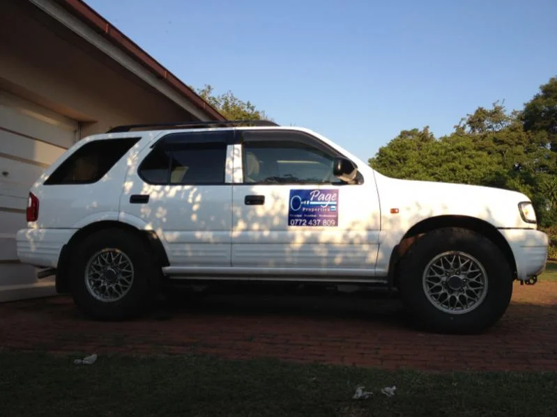

I added some new rubber, after finding the max size possible without raising it off a chart on planetisuzoo.com, 265/70 R16's, they only had 2 Yokohama's so they went on the front, then the desert hawks by Achillies went on the back, also only 2 left, and e general grabber went under as the spare... The lowest point on the vehicle is the spare...
She loves it, perfect size for her and has everything she wanted in a 4x4, she was looking at the Rav4... Already put her magnetic signs on the sides and sent the 626 packing...
It is leaking a bit of oil and I just gave it a service, and keep cutting out, so the oil sensor needs to be changed & I need to find a computer to plug it into to see if all the injectors are working ...
I also have a dual battery setup on the accident vehicle and so I will be putting that into this one, and when my Sliders for the cruiser are ready, there will also be a set for the Wizard
Some more pics
I like the look of the rubber on the Wizzard, fits nice, I may have to replace the back coil springs and I definitely need to replace the bump stops, if only we had timbren in Zim...
Shocks are ok, and should suffice for now, rancho 5000's IIRC
