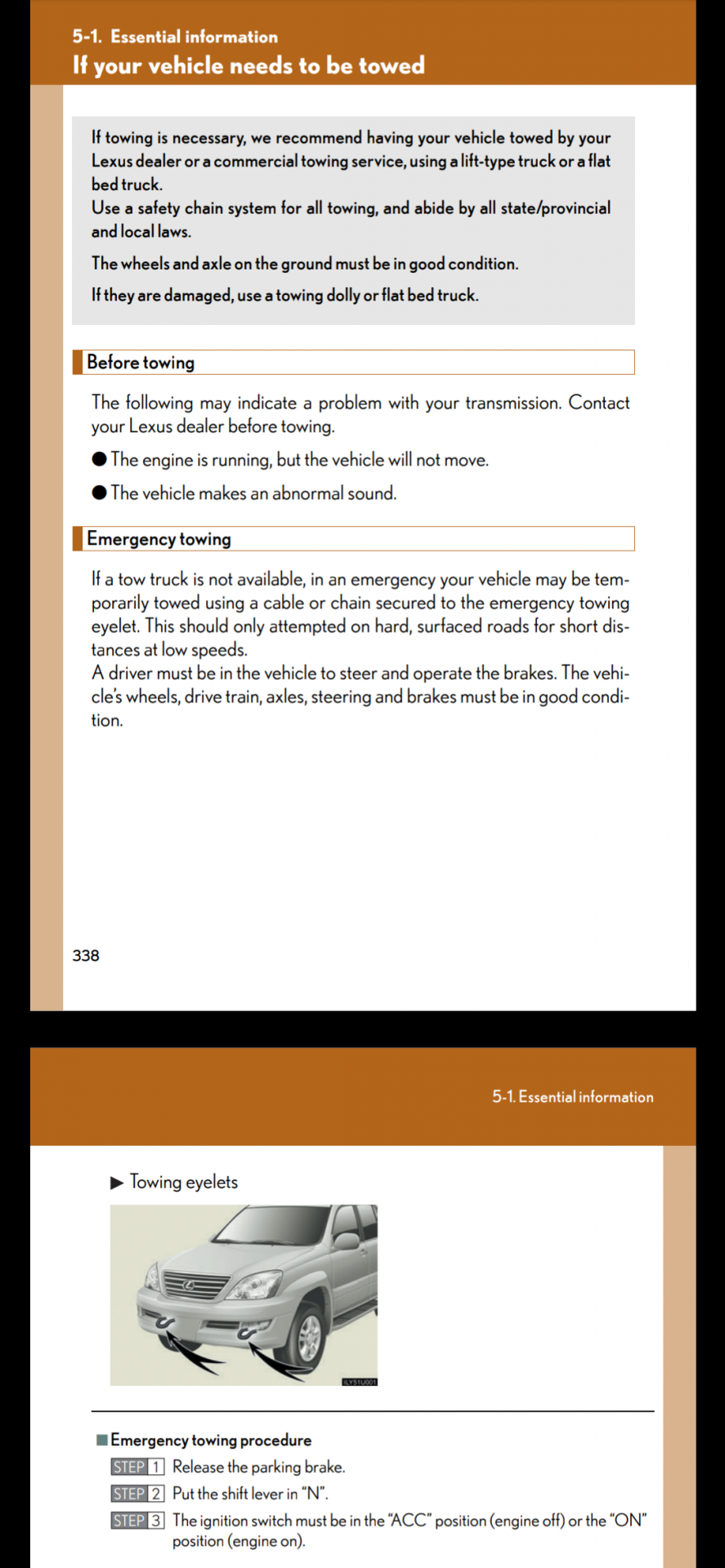

Can anyone show an actual documented failure of the front TOWING EYELETS? That's right, Toyota/Lexus even calls them "Towing Eyelets" in the Owner's Manual. Just because some companies try to sell recovery points that mount to the exact same structure as the factory Towing Eyelets, and claim that the factory points are weak to sell their product, doesn't actually make them weak.
Use a kinetic recovery rope and soft shackles, and I would give them a 0% chance of failure under normal conditions. Yes, if you hooked up a chain and gave it a yank with another truck any mounting point will eventually snap off. Kinetic ropes take the strain very well to make it easier on both rigs. I think I spent a whopping $100 on my rope/soft shackle setup that lives in the GX.

You're kidding me, right? 🤣🤣🤣
Some idiot stuck in the sand yanks it violently enough to rip the entire front end of the frame off and you're blaming the towing eyelets? The towing eyelets are still obviously attached to the frame chunks that were ripped off, if anything that video is a testament that the frame itself will fail before the towing eyelets separate from the frame.
