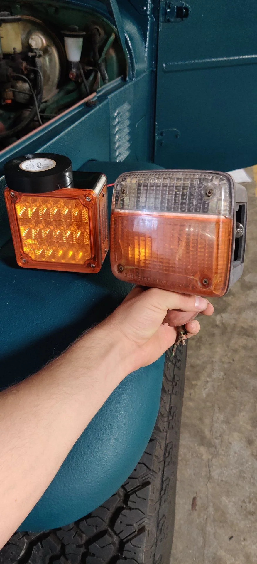

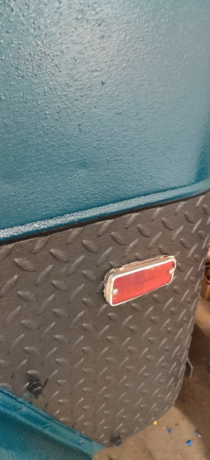

Do you have front amber small square apron lamps above fenders ?
or
rear red color side markers on rear quarter panels
By any chance ?
or
By any chance ?
I swapped out the front apron lamps for some LED lights I found cause original ones were pretty beat up.
And I still have the red side markers on the quarter panels.
Attached photos of both.

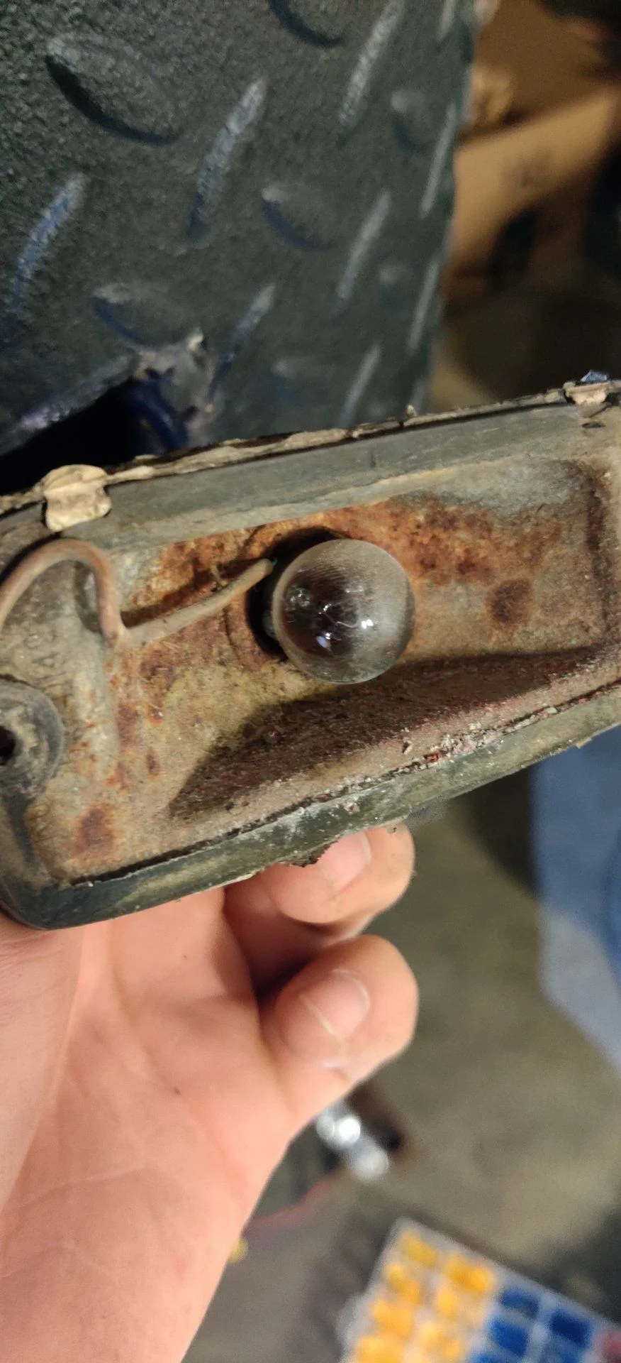

are your red side marker metal housings rears rusty or clean still ?
1. No, my model doesn't have the amber lights like you sent. Only the signal lights that sit on top of the fender that I sent a picture of.
2. These are quite rusty, I'm having trouble getting bulb out even. Attached a quick photo below.
You need to do the following:
Go through ALL the light housings and clean them up. You will never get this to work if all your lights look like that!
Tip: A soak for 20 minutes or more in white vinegar and a wire brush will make a world of difference. Rinse them WELL, let dry and paint with reflective aluminum paint to restore the light reflection. Then follow ToyotaMatts suggestion about grounding all the light housings.
Next would be to pull the fuse panel, disconnect the connectors from the back, then give it a soak in vinegar for about 10 minutes and use a Dremel type tool with a wire wheel to polish the fuse clips until they shine. Re-install it and install all NEW fuses.
Then disconnect the battery cables, clean the terminals and the battery posts. Go to the other end of the battery cables and clean those connections.
After you have done all that THEN start trouble shooting your issues. Any weak link in this electrical chain will have you chasing your tail for hours...
