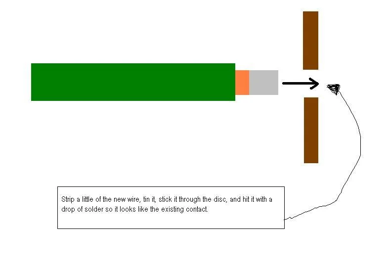

Ok...I am trying to reconstruct a rear harness just in case I get a brake and flasher switch to work...are you saying use a 25 bib light (or equivalent 3 wire light) and use it how? Shoot, I've heard it explained before about adding the extra wire but it just never made sense .
Kinda lost here, can you tell?
Dang Phil, I don't have a single picture of that. I use a brand new early to '67 bib light. They only have a two wires, one is a ground, the other is the running light. If you take off the lens and pull the bulb out you'll see the little fiber disc that has a spring behind it and the contact. Let me try to draw a picture.
OK, Im with you so far....in theory that should take up three of the four green wires routed aft (L turn, R turn, and parking going to L, R, and license...against Mr T's wishes)...the fourth green wire be brakes? And how do dat go?

Yep, you've got it so far, except both the turn and brake are combined at the turn signal switch, and there is a redundant brake wire.
1 - Left Turn and Brake (from turn signal switch)
2 - Right Turn and Brake (from turn signal switch)
3 - Marker /running lights (from light switch)
4 - Brake (from brake switch) <- Do not use, I cut this up front and rewired it for a reverse light. Or keep it for an extree wire if you afeared of shorts. :doh:
