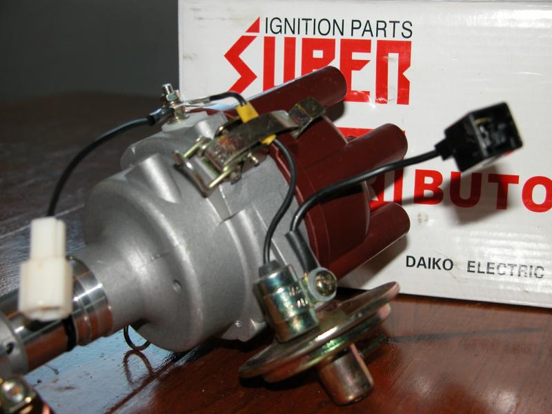

The truck is a US model. California actually if that makes a difference. I got the new "Non US" dizzy from SOR. It has points, and is made by Daiko Electric.
I've tried to attach a pic.....

Oey! Points! No wonder the connectors are different. Going to points is a down-grade from electronic ignition. I can see some pluses for certain uses (like extreme remote Overland trips), but not in a DD.

Ignition +12V goes to the + terminal of coil.
Signal wire goes from - terminal coil to the white connector on dissy.
Black connector is optional redundant ground. Connect to any good ground on engine block, if desired.
