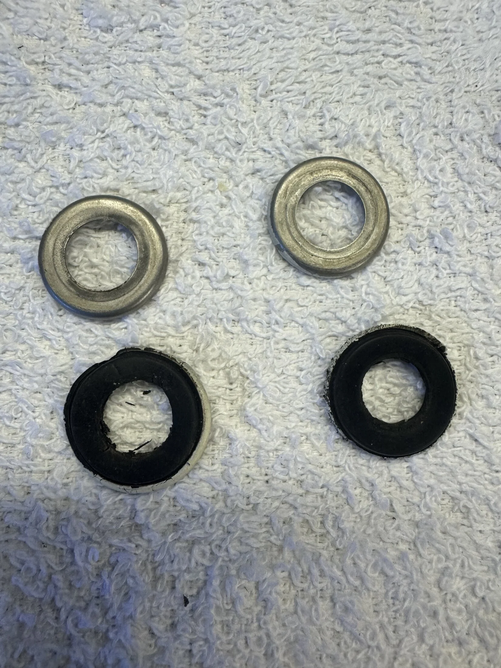

Hello all. Looking where to find 1977 FJ40 rubber washers that seal the windshield wiper arm mechanism against the windshield frame. Looked at both my local hardware stores and my search didn’t come up with what I was looking for. Thank you for any help!
I would likely make them out of something like neoprene or EDPM. Two punches one OD one ID or maybe an exacto knife.

Part no. 85185-25040, "packing" is $7.41 each OEM list (same as SOR)
The metal "washer" is part no. 90209-12002, $2.50 each OEM list.
@charliemeyer007 Thank you so much for the idea!!!

@73FJ40 Epic! Thank you for all the hard work. I really appreciate the part numbers!!!
