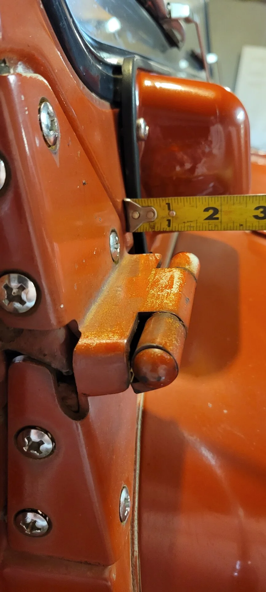

I think your box is too tall and you need later model hinges. This is from a 1975 USA FJ40
That explains it. Thanks, that's exactly what I needed to know. I was told these were later style hinges, but evidently not at all. Now I know what direction to go in. Thanks
