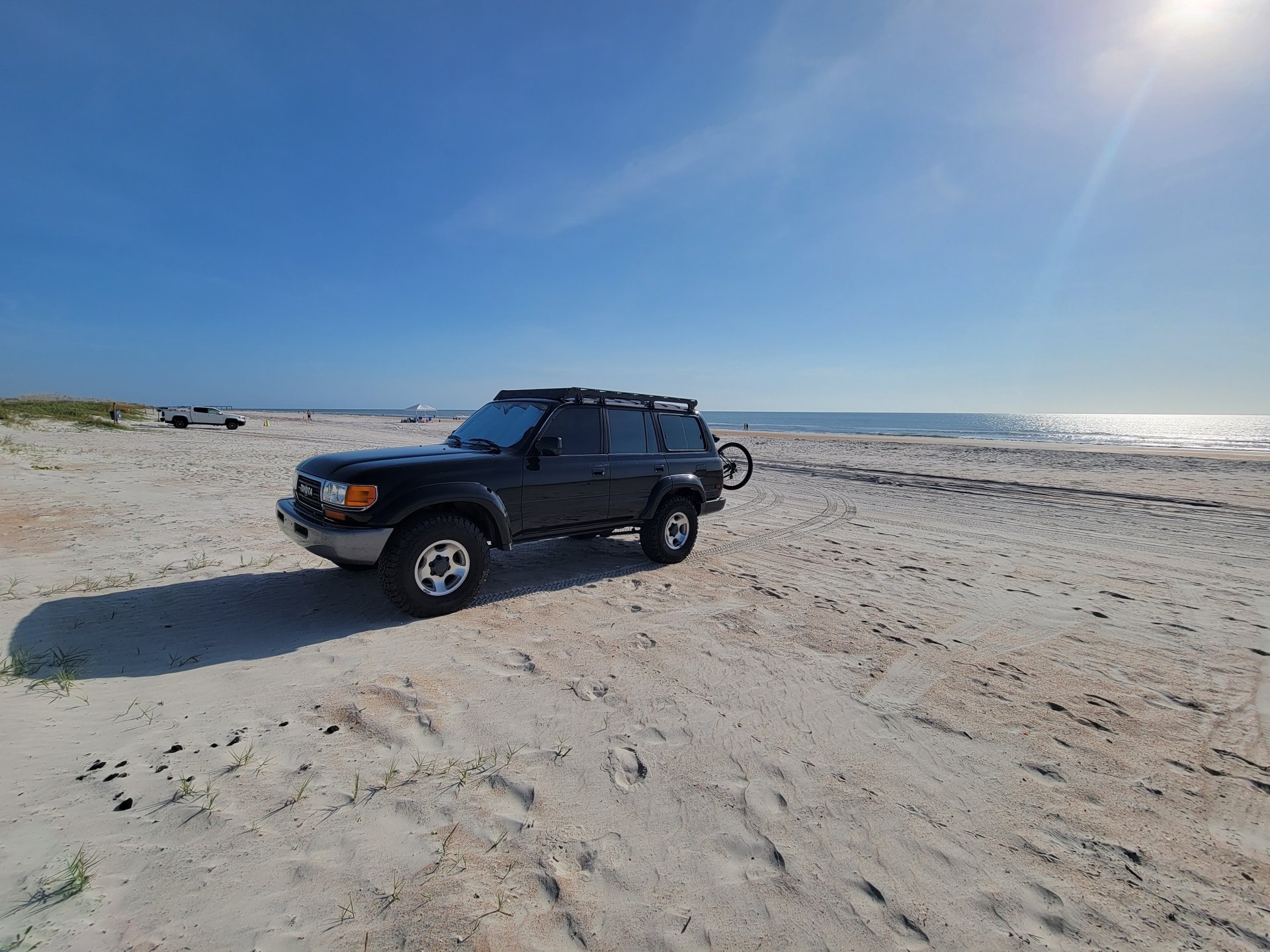

I had mine done a few weeks ago, 35% all the way around. 80% on the front windshield, all ceramic (did not have the sunroof tinted). He had to clean up the glass a lot because of over spray from the monstaliner and he said he had to shrink the rear tint for the rear hatch. It was not cheap but it looks amazing. We were worried with the factory bronze tinted glass the back windows had would throw off the look but it turned out great. Usually if you go too dark there will be a mirrored look with the bronze glass from the 90s.
I also had my new F250 done, 50% over the factory tint on the back, 20% on the front doors, 80% on the windshield and 35% on the full length sun roof. For both it was $1,500. Steep but it's been well worth it. And that was a deal considering the work he put in on the land cruiser. Razor bladed and sanded all the windows and still kept the rear defrost. I've used the same tint guy for 20 years so if you think the price is high it really wasn't considering the work he put in.

Thanks for the info. When I realized my fingers got sunburned from holding the steering wheel on a recent trip I knew I needed to do something.

That looks good. Which tint product did you use?
I think he uses LLumar tint. There's 3 levels of ceramic that he keeps on hand, the highest level/best he only keeps in 35% tint (legal limit in my state). I use the mid grade which blocks 90-whatever % of UV rays. I usually tint darker than 35% so that's why I've always had him do the mid grade ceramic. I went 35% on the land cruiser so I could see on the trails at dusk when backing up. And that may still be too dark but I'll risk it. It's made it much more tolerable to drive in the summer. (my wife tells me I'm a diva since I keep my AC seats on full blast all summer long in my truck)
