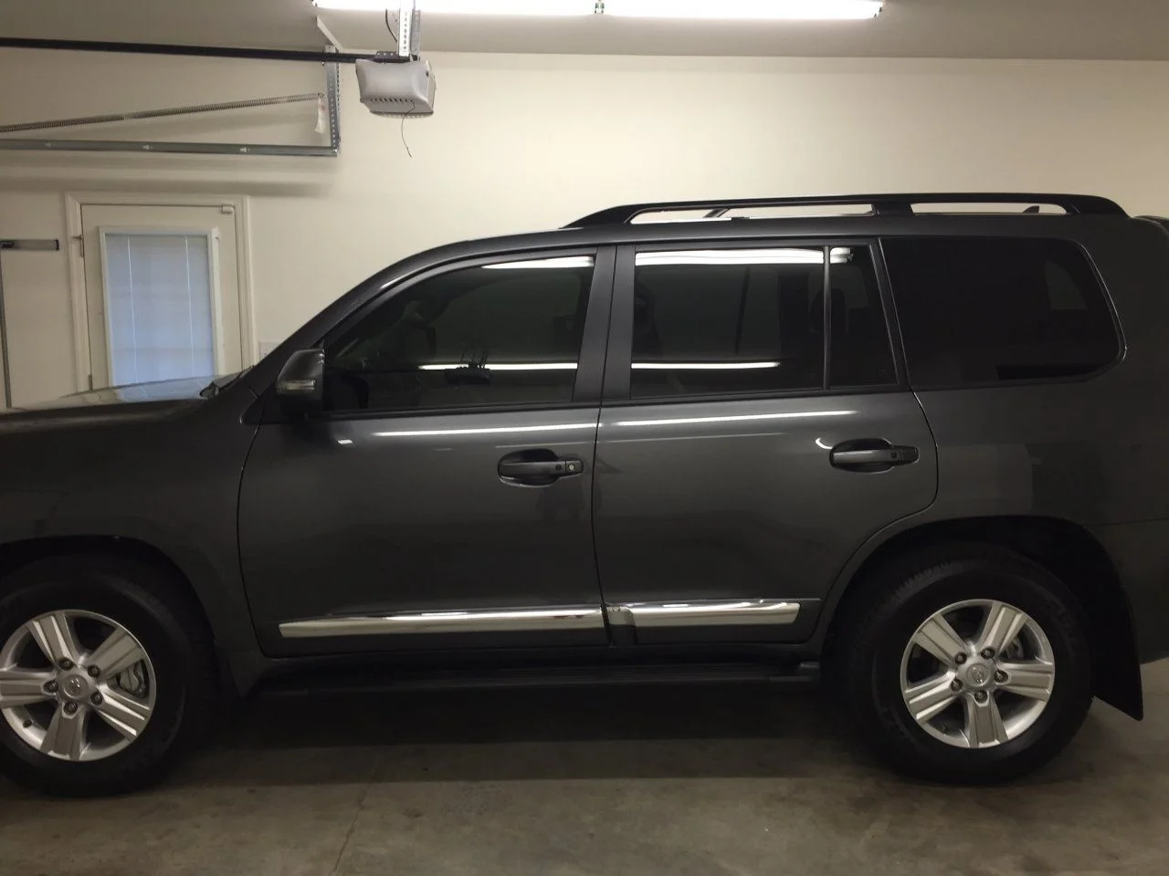

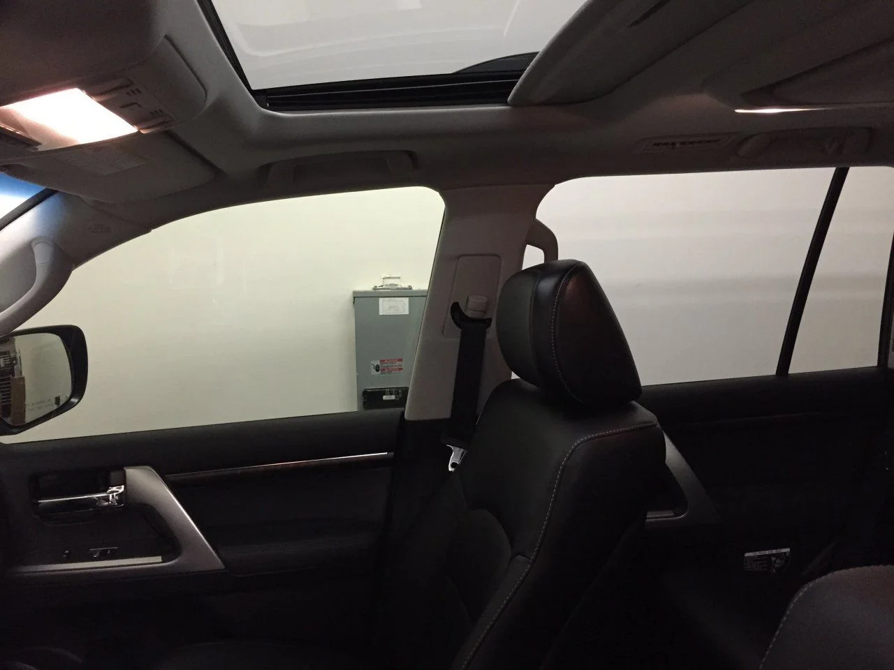

Got my front windows redone and they look better. We originally used a 28% film to match the back better. We ended up removing and going darker to hide the "green" factory UV coating. It's been an interesting learning experience. I've attached a few photos. The only time you can really tell the difference now is in my garage against the white wall background...

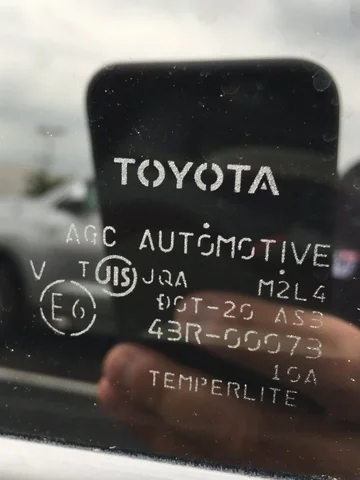

This is the marking on the rear glass...

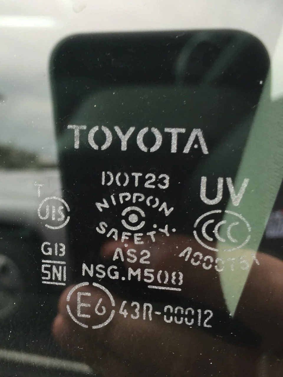

This is the marking on the front glass, notice the UV designation...
I'm not sure it's possible to get it perfect, I'll just have to learn to ignore it.
