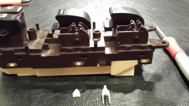

The internal design of this model is much improved over the LC module in my original post in this thread. The rockers drive a mechanical switch in the LC module. In this LX module there are small ferrite buttons embedded in a silicone rubber pad that actuate hall effect switches on the circuit board. Very neat. These switches do have a weak point, but its not the cracking of the plastic switch molding. That's much beefier than the LC module and should last forever.

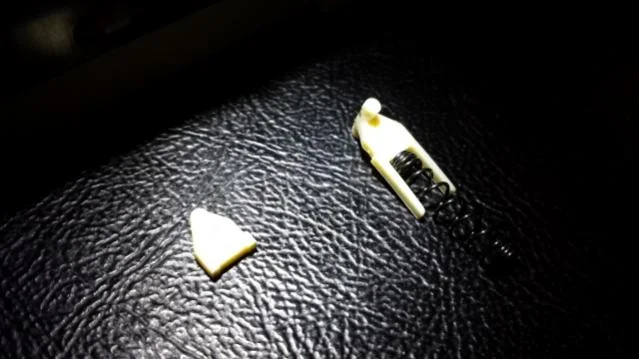

The LX problem is the small white plastic actuator that is located under the rocker switch cover. This little guy can break, and when it does the switch no longer works.
On the right is the complete pin I took from a good switch in this module.
On the left is the broken pin from the failed switch. The two legs and the crossbar at the top are broken off. This appears to be how these switches fail. Its not repairable.
The options are:
- A new switch module or a used switch module from a breaker like CruiserParts
- Replace the failed pin and hood with one taken from another switch in the module like drivers side rear door position and move the broken switch to that position. It will not work, but at least the drivers window switch will now work.

The switch will work without the white guide pin thing. The rocker will feel very loose and will almost always go into auto no matter how careful you go about pushing or pulling it. I had issues with my 01 lx so I just robbed the guide pins out of the rear door switches and put them in the front.
...via IH8MUD app
In this case I suspect the crossbar broke off and jammed the rocker mechanism. Stealing a good guide pin from another switch is the only option, agreed.
Good to know that the switch will kinda work without the detent pin. I couldn't test this switch in my 99 LC.

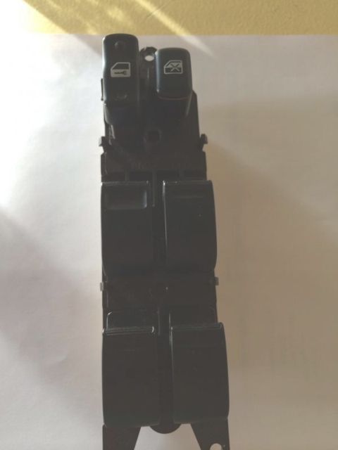

APK, thanks for the excellent info. I disassembled the master switch on my 2000 LX this evening and confirmed no corrosion on the circuit board. Driver window auto and manual work fine; just have issues with all passenger windows. The other switches appear to actuate just fine and push the pins down with similar force as the driver side. Thoughts?
Not sure I understand which switch types were fitted on what year models. Does your switch look like the one in my pics or the one in CEOs pics? They are very different animals. If its the Lexus type with Auto on all four switches I'd suspect a component failure on the module board or a broken PCB track, or even a connector/harness problem. Its highly unlikely that the switch mechanisms failed in all three positions at once as you describe.
Yep, same as CEO's layout. Very robust design for 2000. How can I test for a harness problem?
