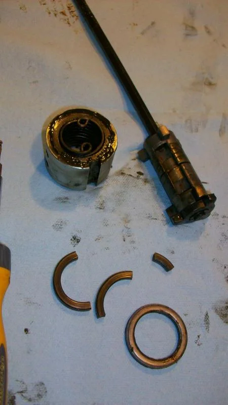

the In/Out lever on my TMax has had an attitude for the past year....stiff and such....and it's clocked wrong...
so i pull it apart today.....
remove winch, pull gear side, reseat the planetaries, and reassemble....reattach to the bumper and it pulls with NO reduction....like 100mph....stupid fast.....
so, remove and re-do everything to be sure it's right......reinstall and the same issue....
3rd time, and it's on the shop floor....
what part of the reassembly am i missing that causes it to spool in and out at 100mph? it acts like the reduction assembly isn't connected at all....
TIA for any help.....

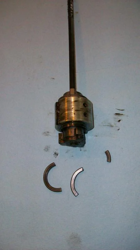

found the problem....metal ring in the brake assembly snapped apart and was jamming inside the drum.....
next step: call TMax for a replacement, and see if it can arrive tomorrow so I can winch this weekend....
or, run without that part and not have the internal brake...which would be fine for this trip....

removed the brake portion, appears it'll be easy to run without if needed....
off to True Value with the 'good' piece to see if I can find something....not gonna get too wound on it, don't need the brake for this weekend anyways....
and as an FYI, the winch works just fine without the brake system installed...one e-clip off the end, slide the brake mechanism off, re-install the internals that slide over the shaft, and viola :)
