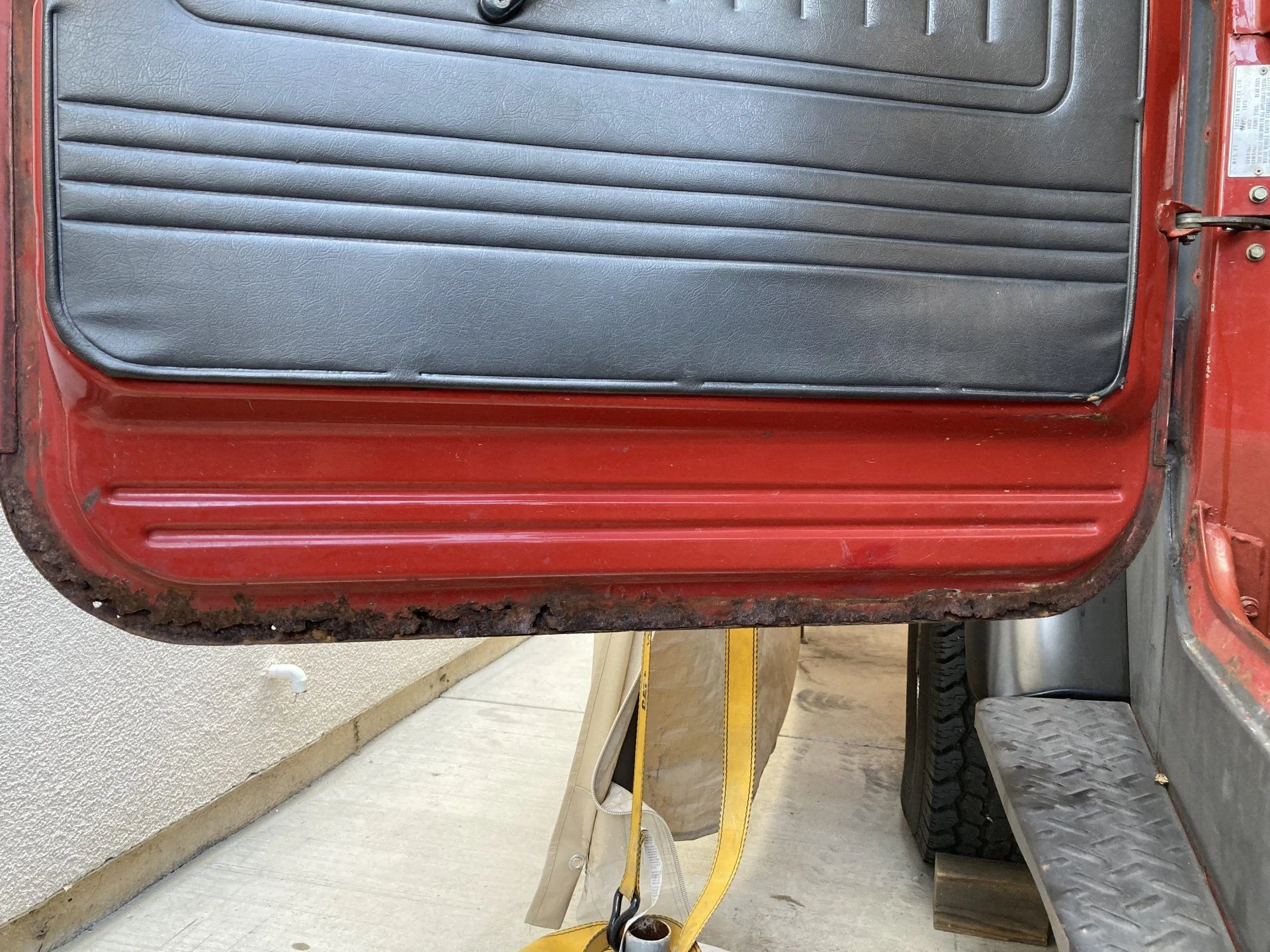

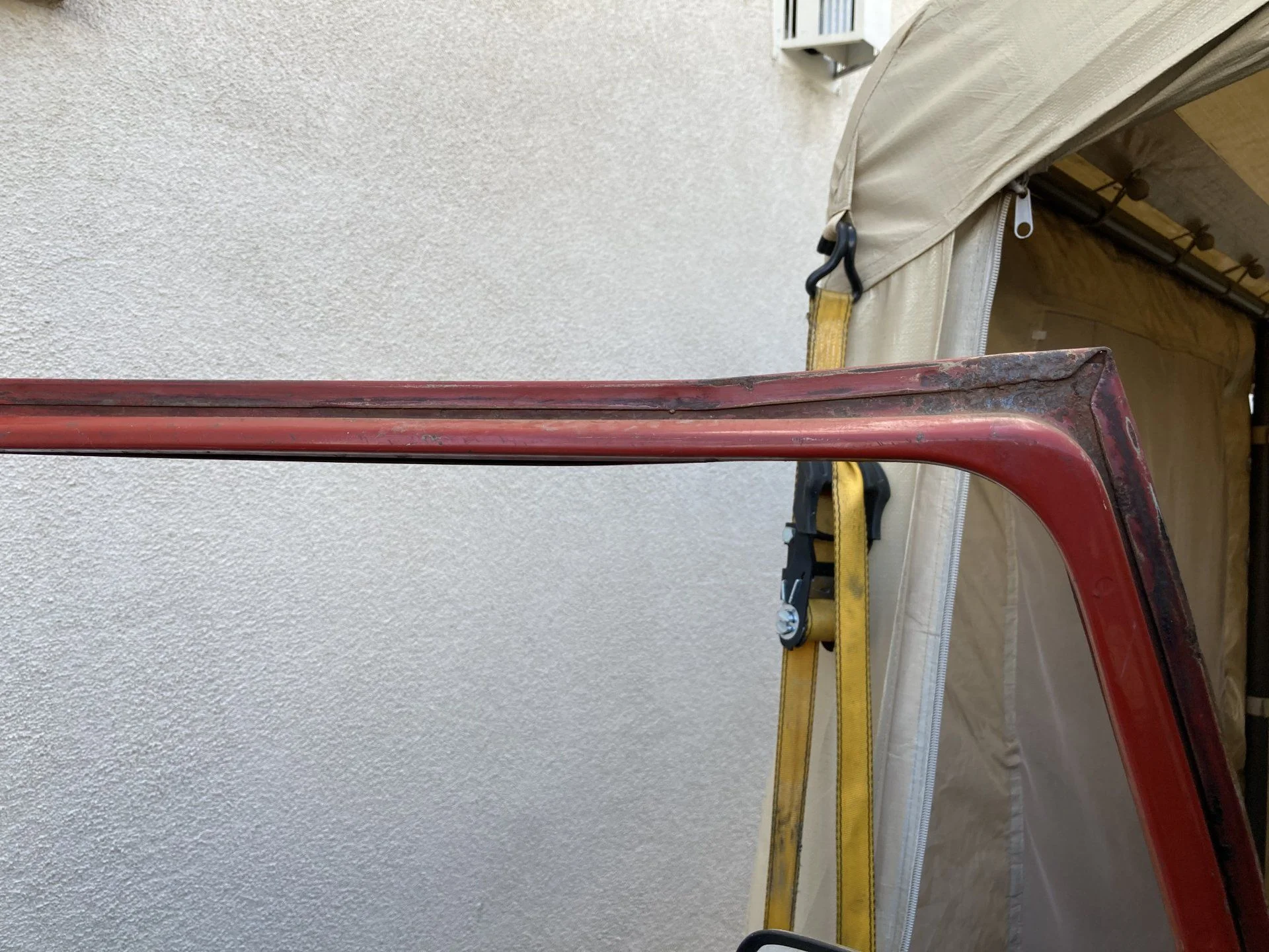

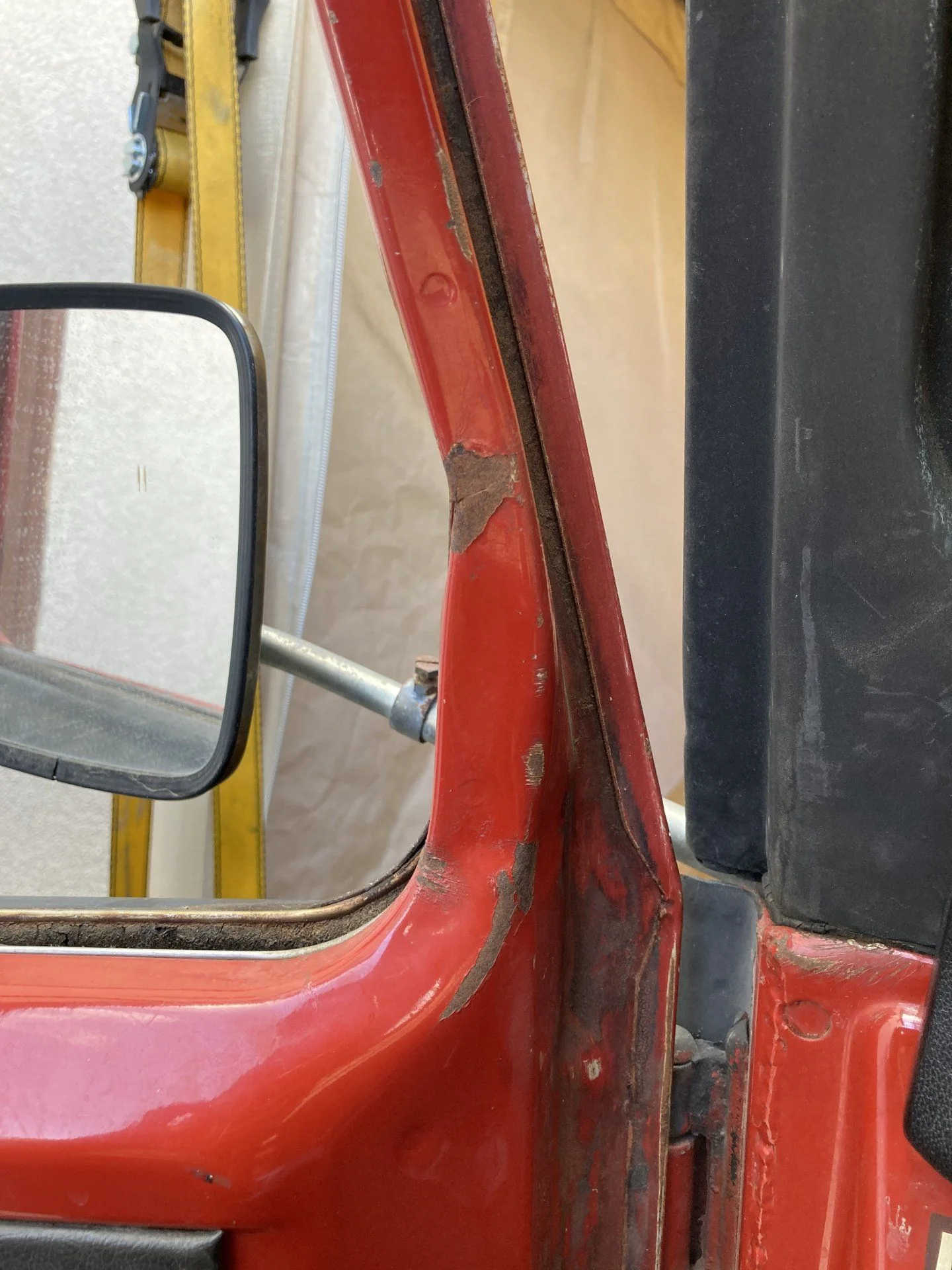

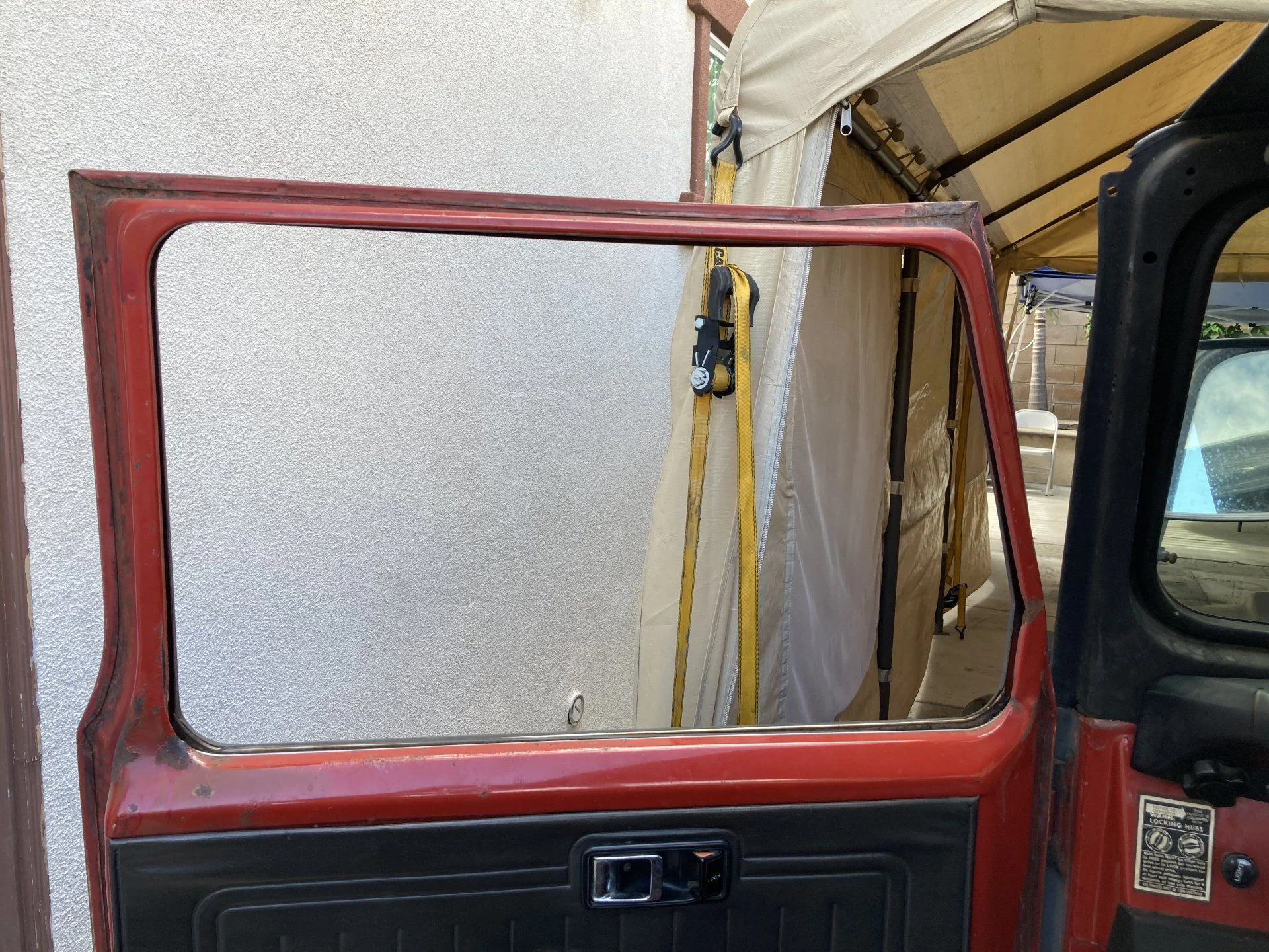

I have some damage on the window frames of my 1975 FJ40 doors along with the much needed rust repair at the bottom on the inside and outside. I’m wondering or seeking advice if these are worth repairing and if there is someone in the SoCal or Orange County Area that can do it?

I'd clean up the rust on most of it, weld that crack, bend a filler panel up to replace the area at the bottom, weld it in, and get to work with some high build primer and sanding to clean the rest of it up.

Thanks for the response. I will consider it. I just have to figure out the welding and time to do it. I’m glad there’s hope in the top potion of the doors. I just wasn’t sure if it was possible to weld back to the original position and fit to the Hard top when I get it back on the eventually. Which in my case will be a couple of years.
Cruiser Corps has the patch panels for the bottoms of the doors: Door Patch - Front Lower - FJ40 1975-1984
From the photos, I'd work with what's there for the rest of the door as opposed to patching in anything new.
Thanks again for the information, I’m going to have to really practice welding before I tackle doing those patches myself. I’ll have to search the threads on how to approach that kind of work and work up the courage to do it! :cool:

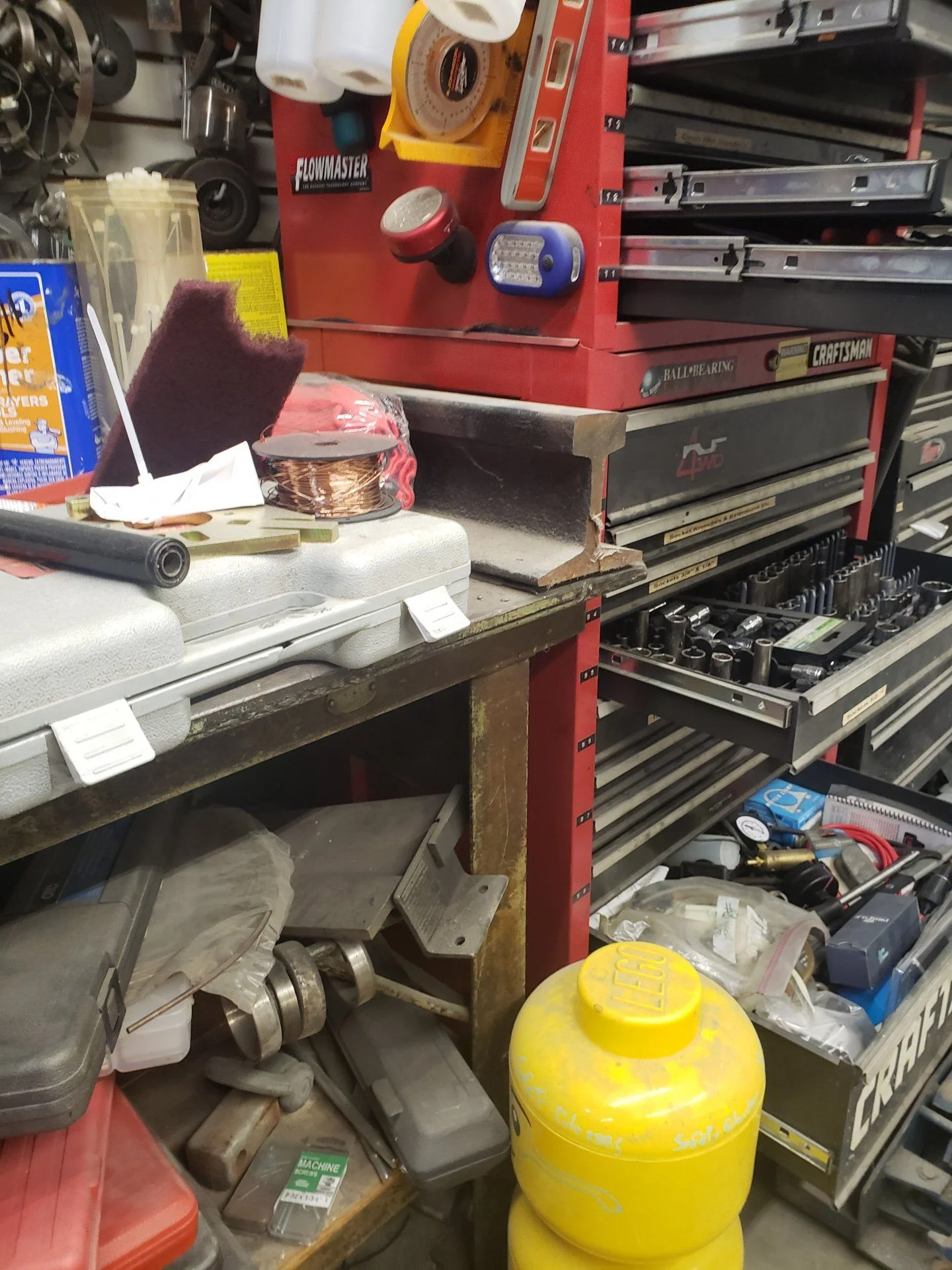

I really like that rail road tie idea as an anvil! That has to be one of the best auto body cheap tricks I’ve seen! 😂

only prob with a railroad tie piece is getting it home and cutting it. Took a long time to find a small piece to drag home
