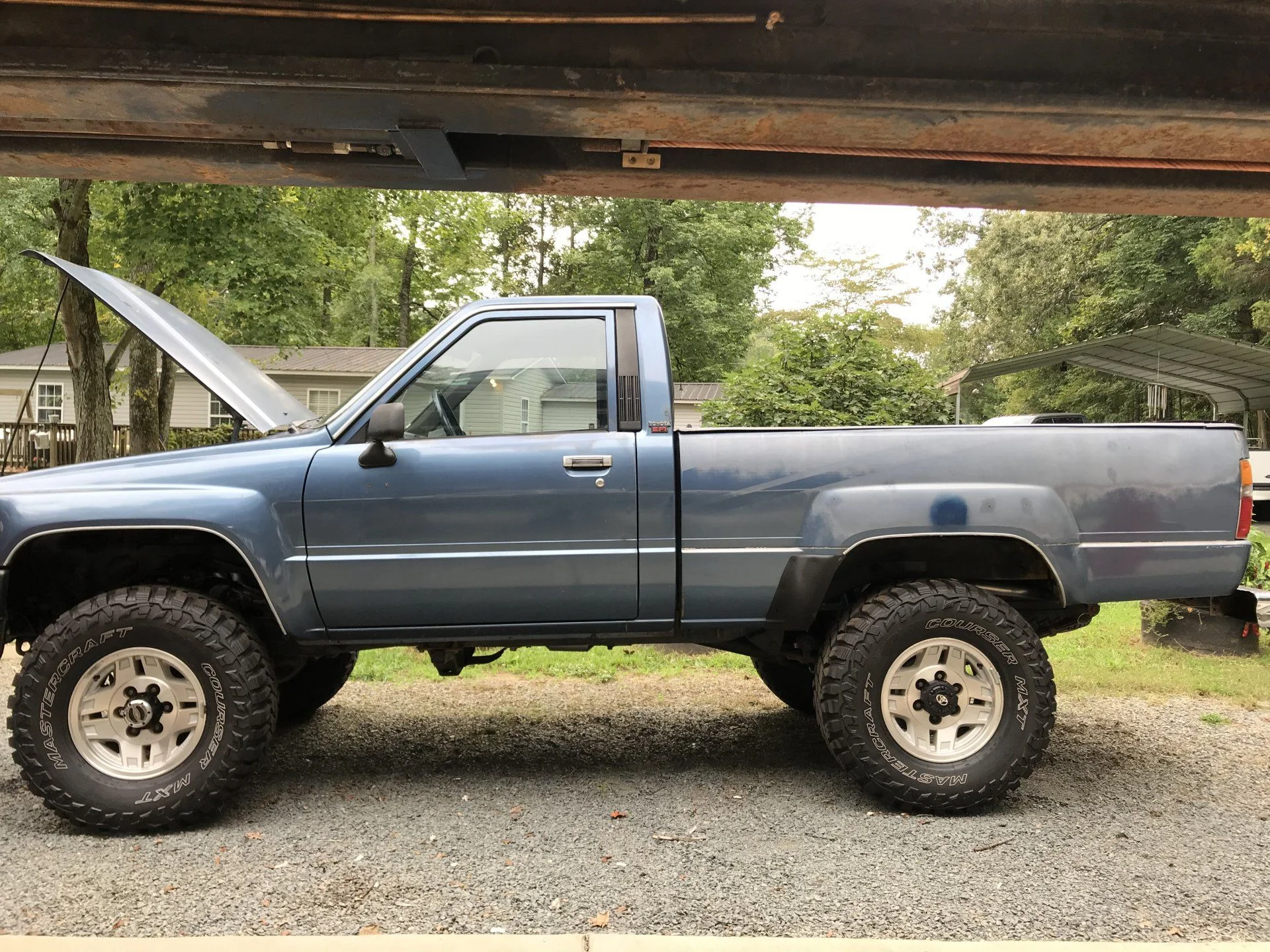

Noah,
I bought the truck with this set up so had to check to see what it was.
Curt
It appears that they are 8 backspace with 11.50 x 15 tires. There are no spacers or modifications that I can see to make this work. It does look like the torsion rods are cranked all the way up as it sits pretty high.

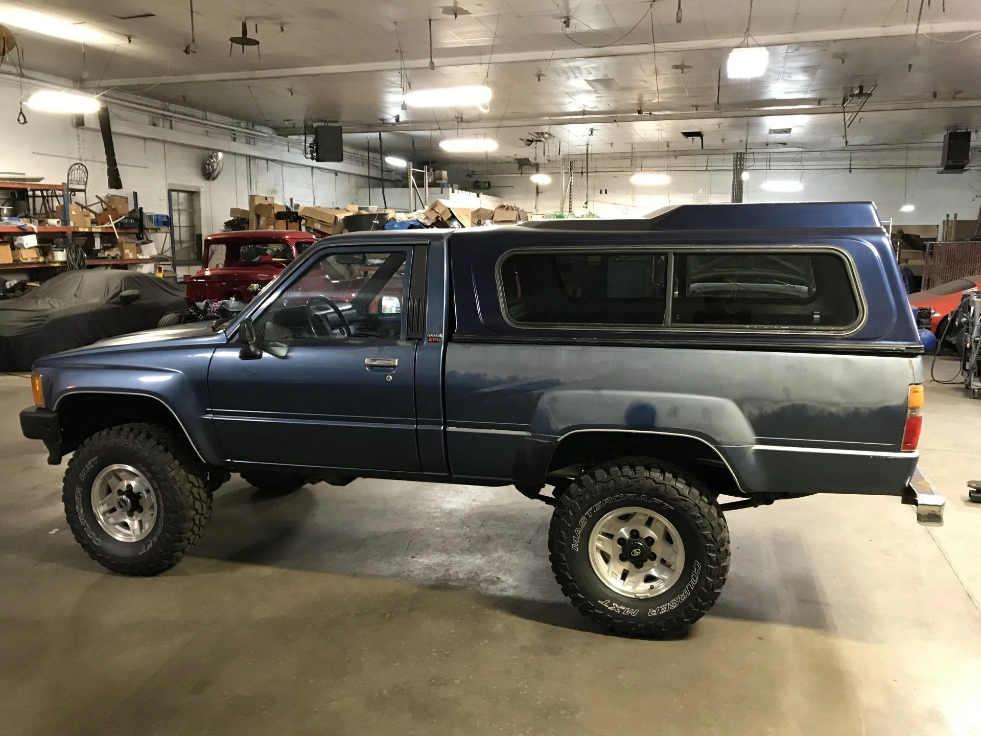

Curt
