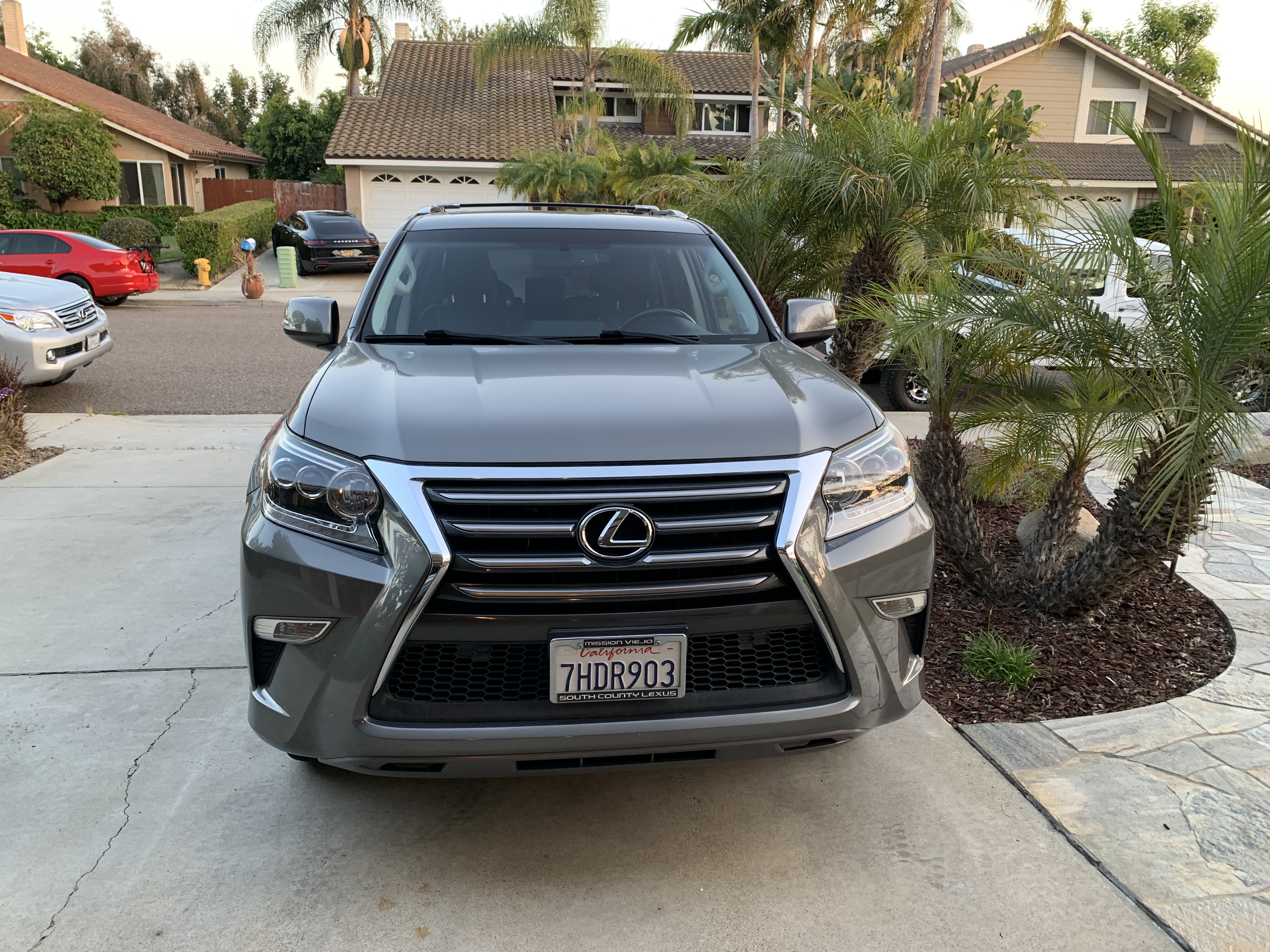

Not sure I'd call this a build, but we snagged a 2014 GX460 with super low miles for a '14 (78k) and gave it a little facelift.
Here it is the day we brought it home:
