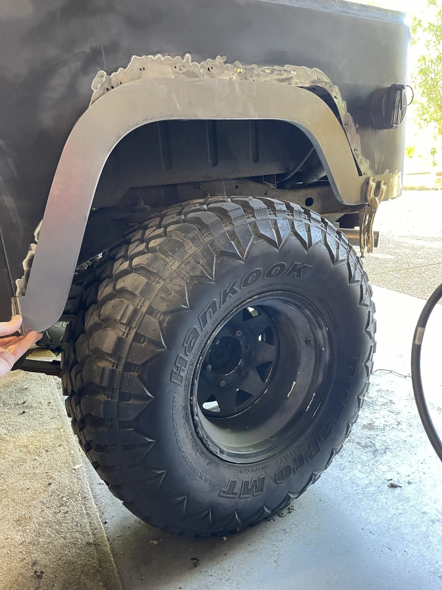

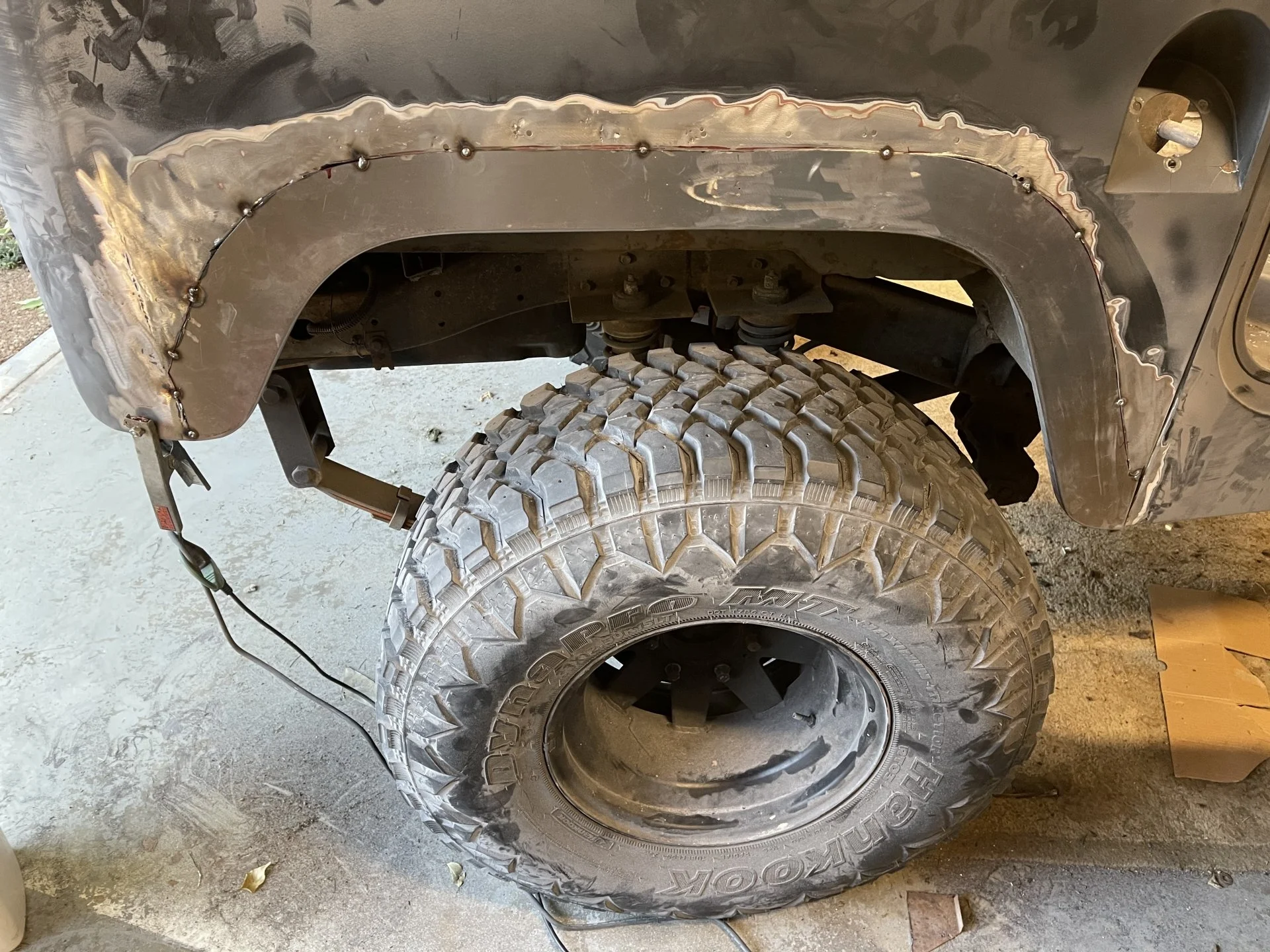

My wheel wells were trashed, so I decided to order the replacement rear pieces from real steel. They arrived after about 4 weeks, great quality stuff. Only issue... the PO saws all cuts were a little wide. I like the idea of having a little wider wheel well with the stock edge

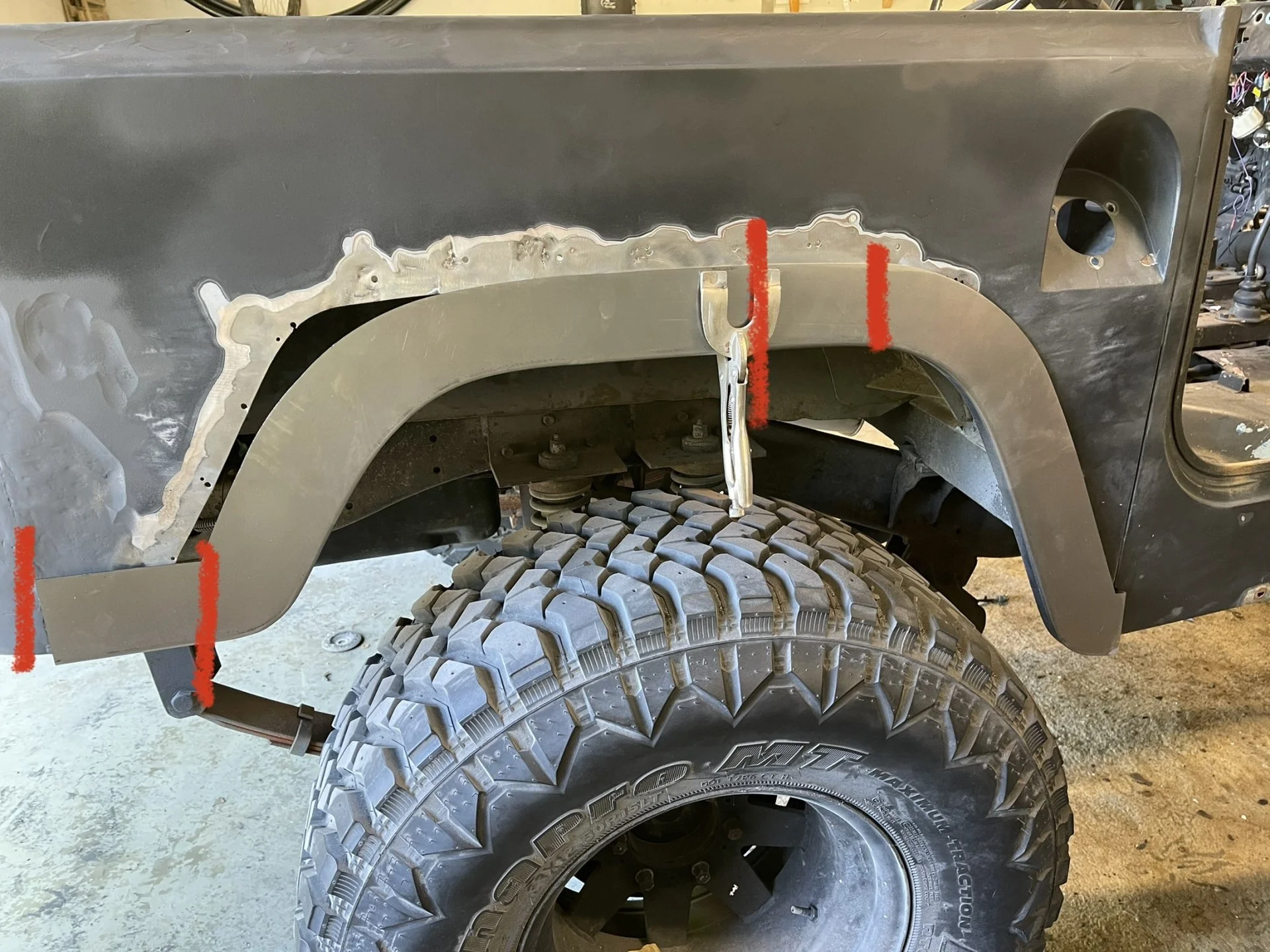

So what if I cut off the rear tab, and spice it into the center?

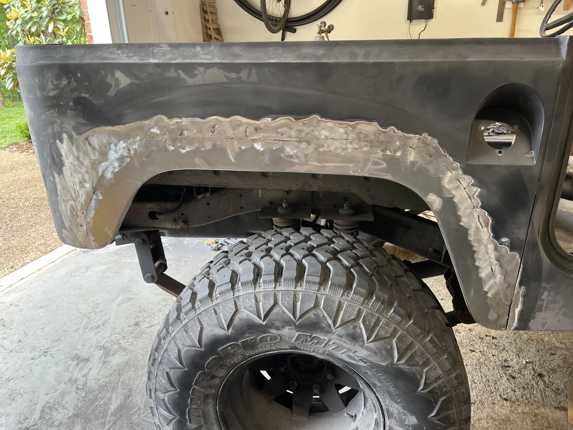

I gave it a go and super pleased with the results.

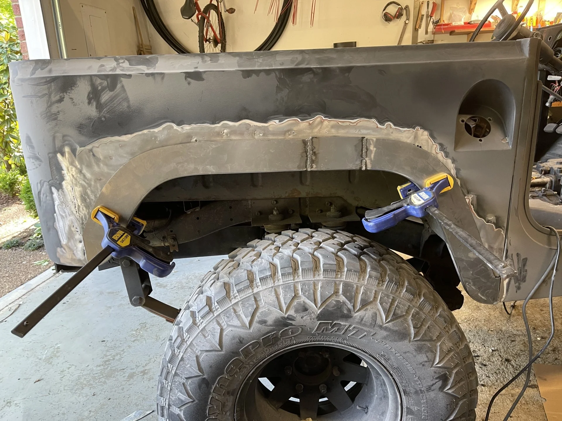

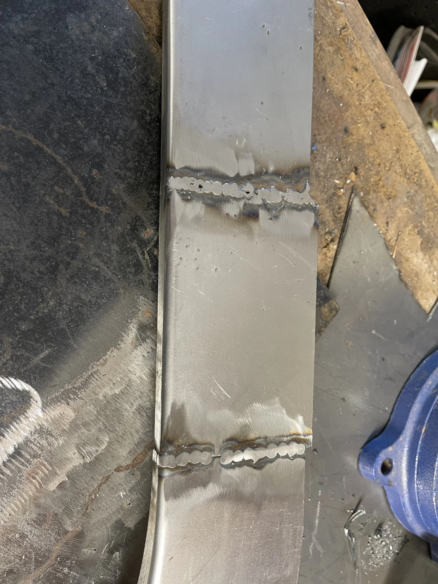

Splice roughed in. Aligned to about the same with on each side of the bend. And here we go.

That came out great!
