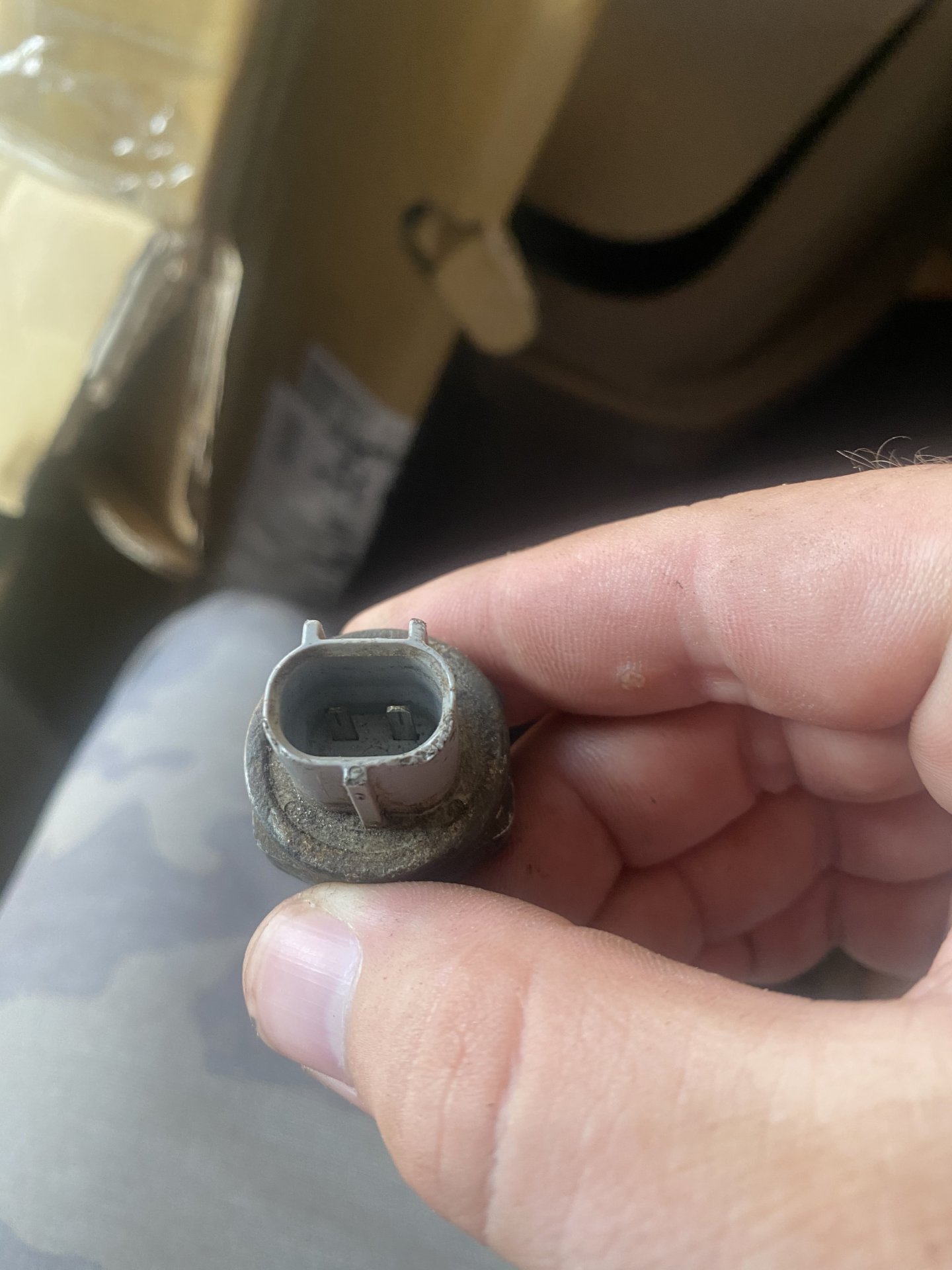

Why can’t I find this style diff sensor?
Jul 25, 2018
12
35
tampa fl
This the one I pulled off my 1993 t case. But the on I see available from Toyota and other part stores do not have the connector end. Any help would be much appreciated.
IIRC, There’s a Beck/Arnley direct replacement for like $12. I’ll try to dig up the part #.
This could be one of those few times a dealer parts desk is worth a shot.
It's not the fastest route and not a guarantee by any means, but at least if they order the wrong part and you can confirm that at the desk you shouldn't be out the money until the right part shows up.
Take them what you have, tell them what it is, and hope they pull someone from the back to take a looksee. lol (that's what it took in my sitch)
Its 84222-60081. I just went through this. Does anyone know the part number or where to get the harness side connector though? Mine is damaged also.
