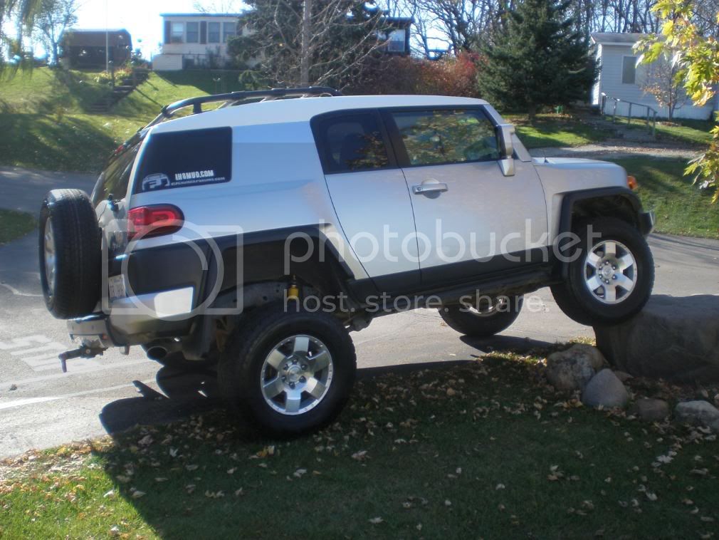

As far as a lift goes, I went with the Toytec lift. I put OME 885's on the front shocks with their 1/2 inch spacer (will upgrade to the OME units later). These are a little stiffer for a future ARB bumper and give great articulation. I have the Toytech custom springs in the rear with OME N71 shocks. The difference in the ride is noticeable!
