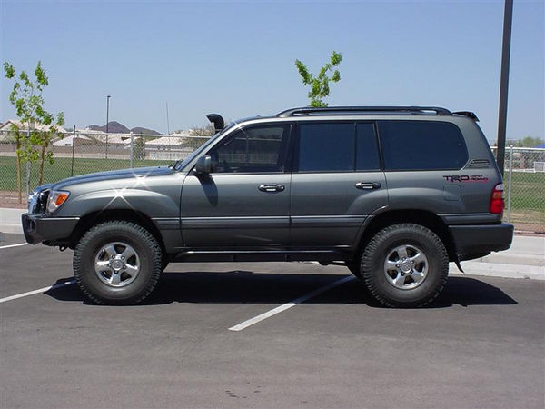

This pic:
2.75 front
865 rear with 20mm packers
315's with 315 spare
