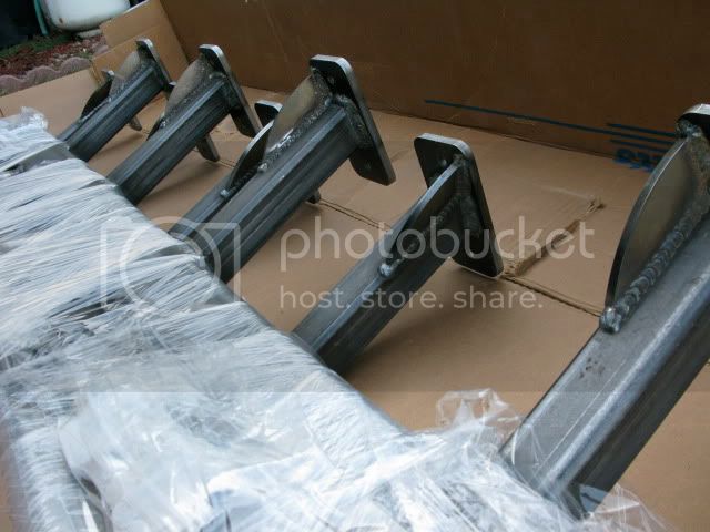

The White Knuckle Off Road sliders (heavy duty version) arrived the other day. The sliders were very well packaged and included the bolts, washers, parking brake cable relocation brackets, instructions, as well as stickers. At 110 pounds, the UPS man made a comment about the package being the heaviest of the day. =)
If I had to do it all over again, I'd get the same sliders, except I'd pay john to have his powder coater guy bead blast the sliders to cut out a bunch of manual labor in prepping them for the paint job.
Pics as promised:

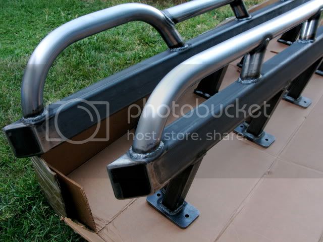

Upon opening the box:
Nice welds were staring right at me:
Plastic wrap removed:

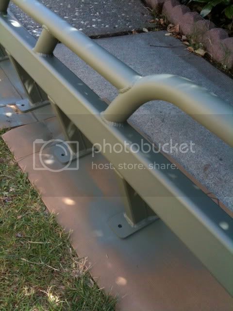

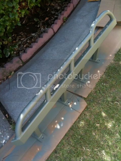

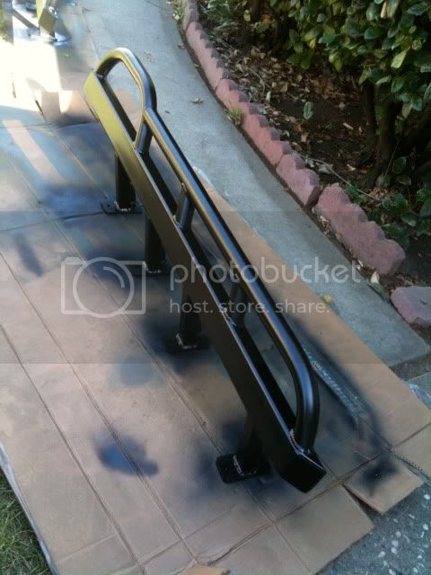

Few coats of Duplicolor self etching primer after a thorough cleaning with a wire brush, coarse scotch-brite pad, and a wipe down with acetone:
Another view of the primer coat:
Few coats of VHT Rollbar and Chassis Epoxy paint in semi-gloss black:

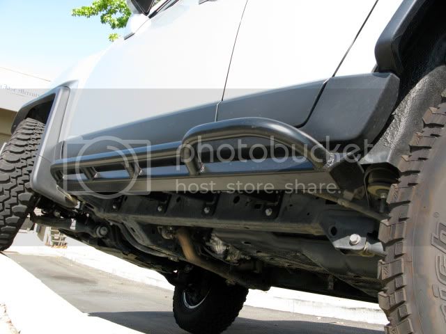

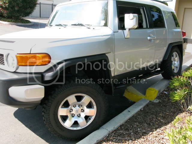

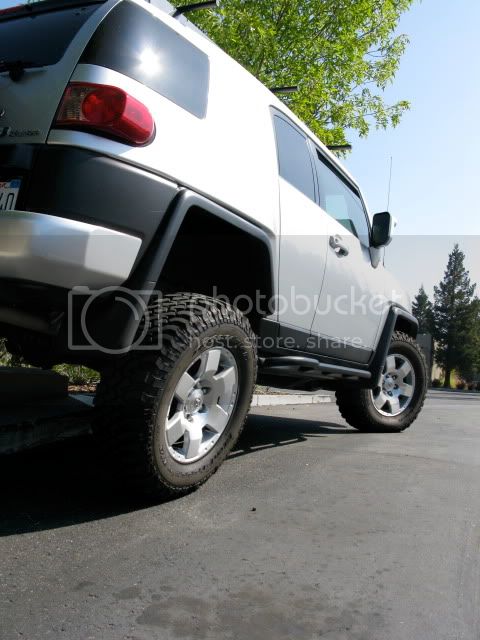

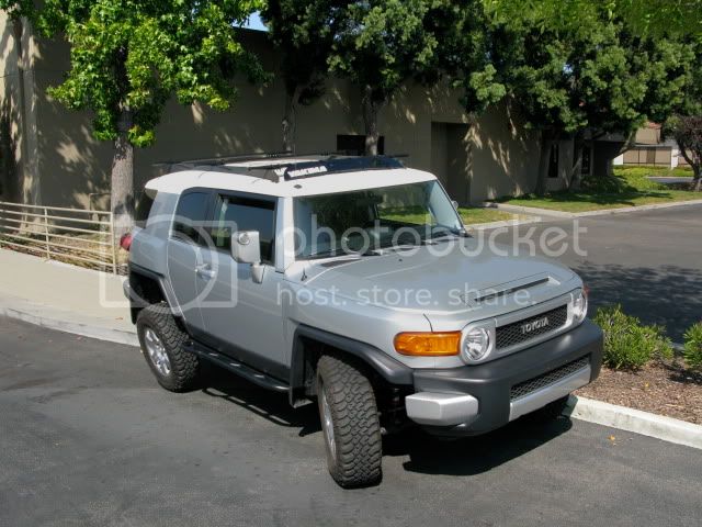

Bolted up!

The rock sliders look great, first I've seen from them. Nice kickout, angled and mounted heavy duty with double the mounting brackets.:)
