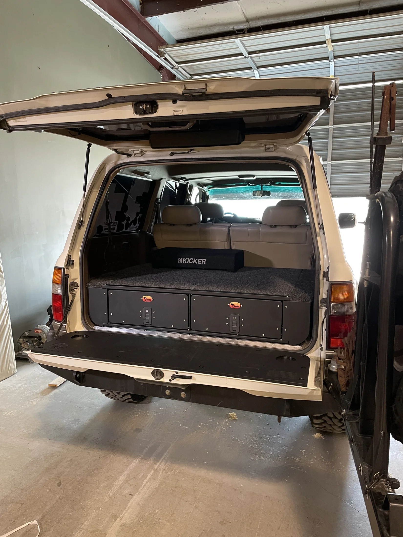

Depends on what your plans for the vehicle are. I’d love more bass in mine, but it was all a big compromise for me. I have ARB drawers, a semi-permanently mounted fridge, and frequently haul stuff in the back. There's a QPM full of electronics in the factory sub location. I opted for a Memphis powered 8" sub that wedges between the drawers and the 2nd row seat and still sounds decent.

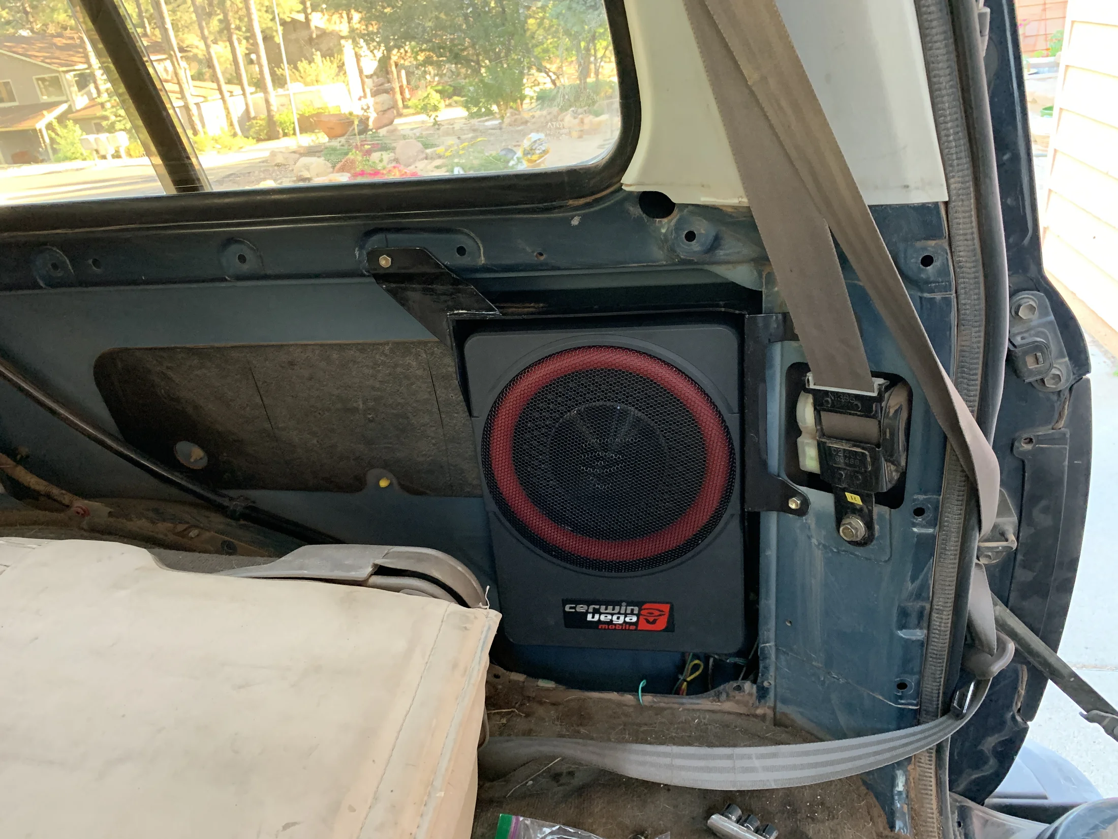

I put a sub in the side, where the old sub was on the LC. Lots of people do this. I made mine but a few sell brackets.
I’ve been very pleased with this set up. I was reluctant to do a fixed mount because I have so many different gear configurations in the back. This Kicker box is indestructible and hardly moves at all in rough trails. I can move it wherever I need it in the back depending on what I’m carrying. Very happy with the performance too.
I will say, for anyone going this route, my own similar install was significantly improved by getting some of that thick Thinsulate insulation from an overlander shop and stuffing that quarter panel full behind the panel and sub. It comes in a roll with a width rougly equal to the length of that panel, so I just cut off a piece roughly the right depth and stuffed it back there. It took a bit of patience to get it fitted all the way to the corners, but it killed all the rattles and made the sound significantly tighter. Don't worry about moisture, the stuff is intended for this sort of purpose and can't absorb water.
If I was doing this again or differently and not using a moveable box, I’d go the route like you and flagstaff did. That’s a good set up and takes up zero space.
Do you mind sharing where you had that bracket made? My sub bracket just broke and that looks awesome!
I got my bracket from some Prado Erick guy on fb. Kicker HS10 thumps too.
