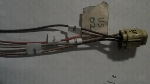

Here is the upstream (US) sensor

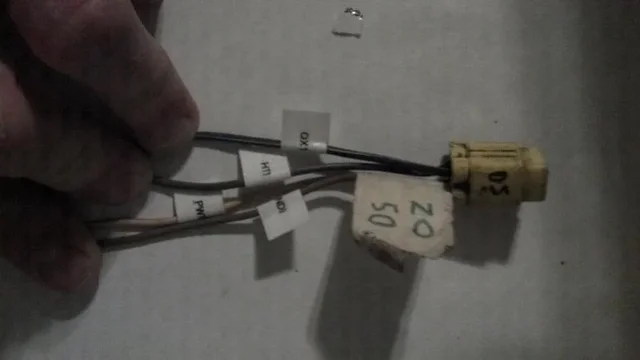

and the downstream (DS) one.

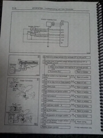

I wasn't sure which was which either, so I made labels...here is the troubleshoot for reference.

The labels are a little confusing because I made a couple modifications for my ease of reference. The wires labelled "E1(GRND)" are ground wires that correspond with the ECU terminal E1. The ones that are labeled "PWR" correspond with the ECU terminal +B.
An easy way to tell at either end (ECU or connector) is by wire color, because Toyota kept it simple:
OX1 = dk blue, 2x white stripe
OX2 = solid yellow
HT1 = solid gray
HT2 = solid orange
