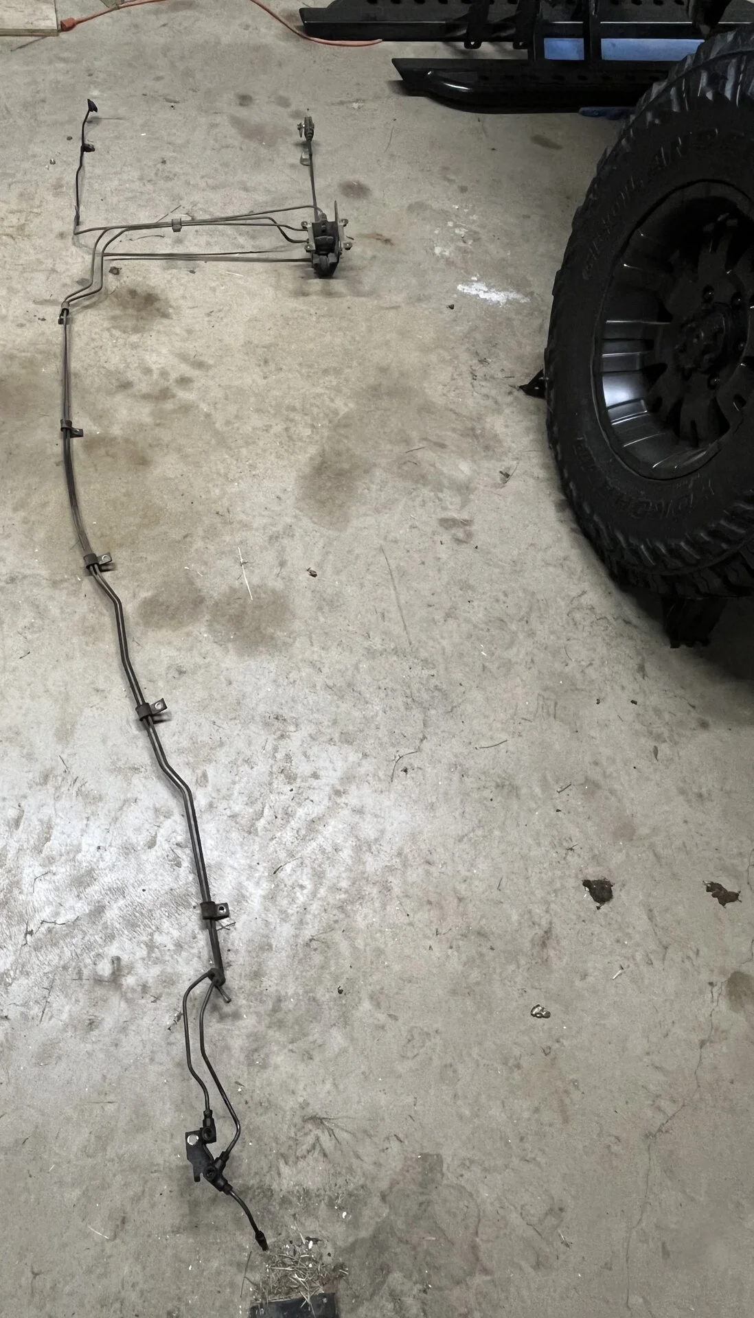

Hey everyone, looking to delete this monstrosity of brake line routing from my 62
for the simple 60 series proportioning valve. Can someone confirm for me which port on the master goes to front axle vs rear? I’m dealing 80 axles so this is a 80 booster and master. TIA!
Can't help you with the port location off the top of my head (you should post up in the 80 section for that) but what I can tell you is you should just be using a manually adjustable proportioning valve on the rear circuit. the 60 proportioning valve should only be used on vehicles with the stock 60 brakes.
