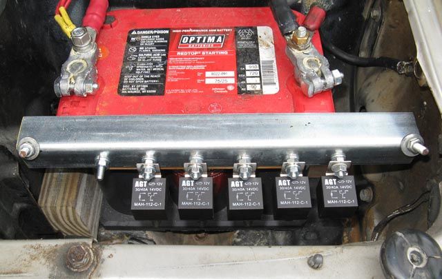

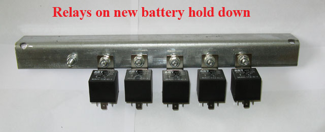

On the battery hold-down strap is one idea - depending on your battery size.
I epoxied a piece of 1/2" wood with a groove in it for the bolt heads to the back of the hold-down so that they do not rub against the battery.
I got the idea from a post by jcardona1 so cannot make any claims for originality.
