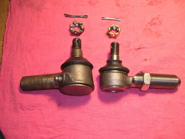

Here is a comparision of a Wagoneer TRE and an 80 TRE, I think the Waggy TRE is the same as a GMC? No?
attachment.php
BTW, I also have one of the ES2233L TRE's that I can't use any more.
