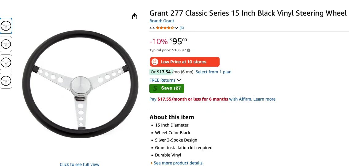

I'll prob use a grant like steering wheel. Am I crazy?

Obviously, my opinion only, but I think the Grant wheel looks, well... cheap.

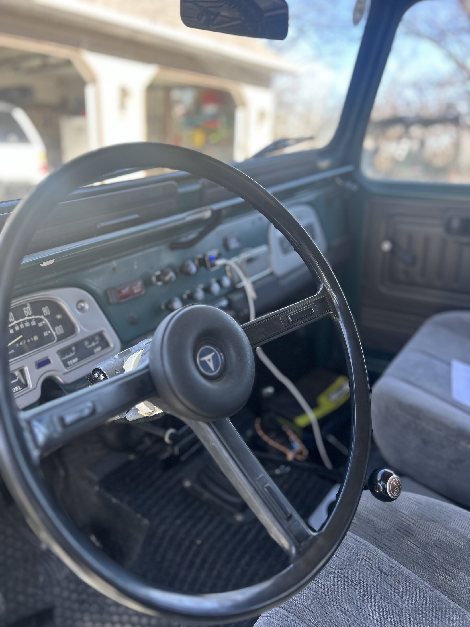

The original wheel is 46 years old and all 3 spokes had cracks at the hub. I did not have power steering before the 16" wheel provided more leverage to turn. With power steering and the size of the piston it will take a lot effort to turn the wheel so a smaller wheel will be fine but wont affect handlining.
I am tall the smaller wheel will give me more room.

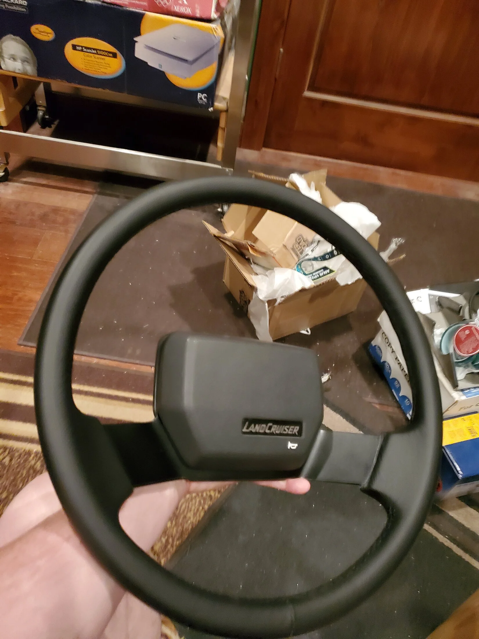

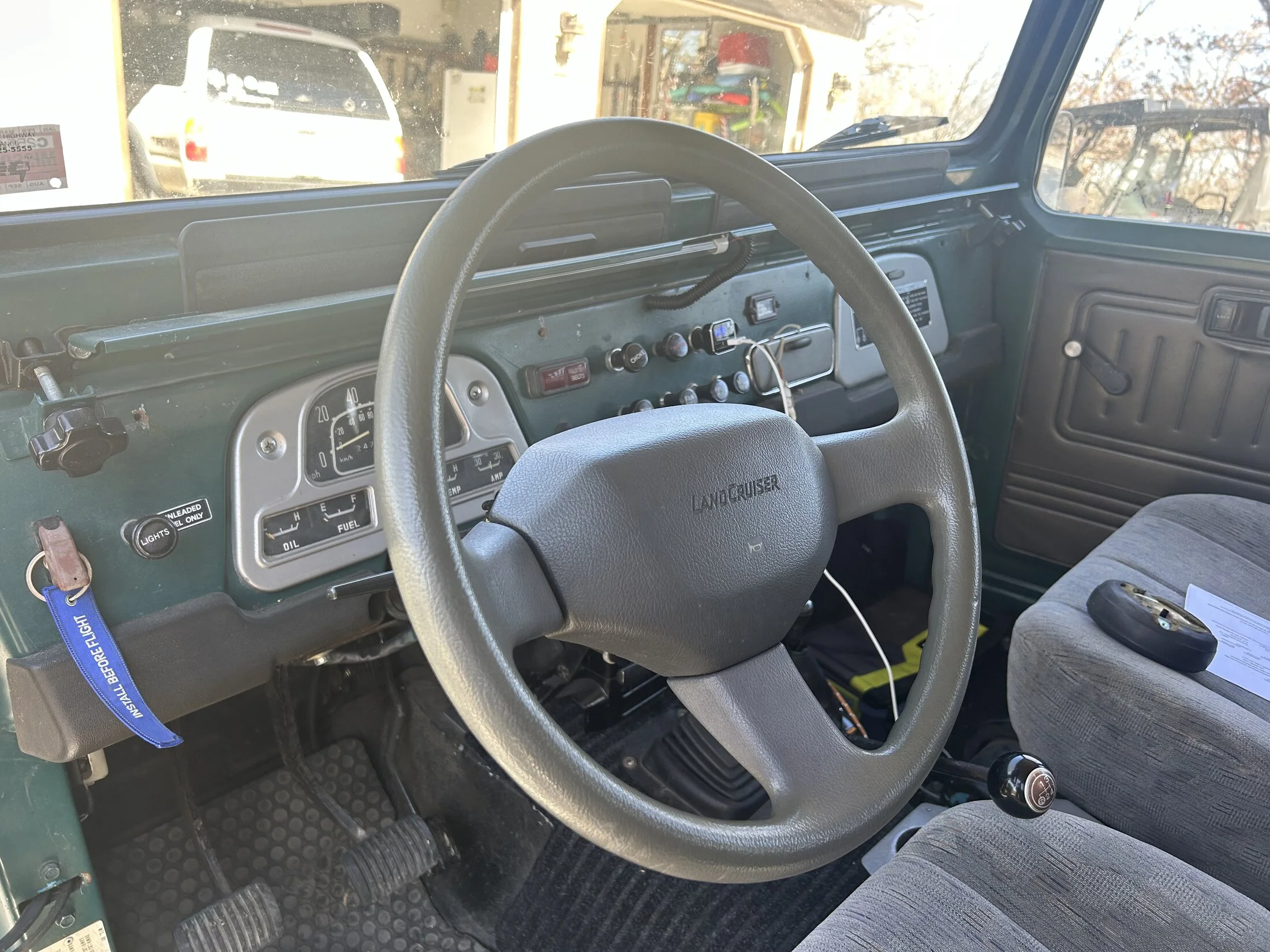

I found a FJ70 steering wheel for my FJ40 with FJ80/105 power steering upgrade that is smaller then the stock wheel it was outfitted with. View attachment 3924903

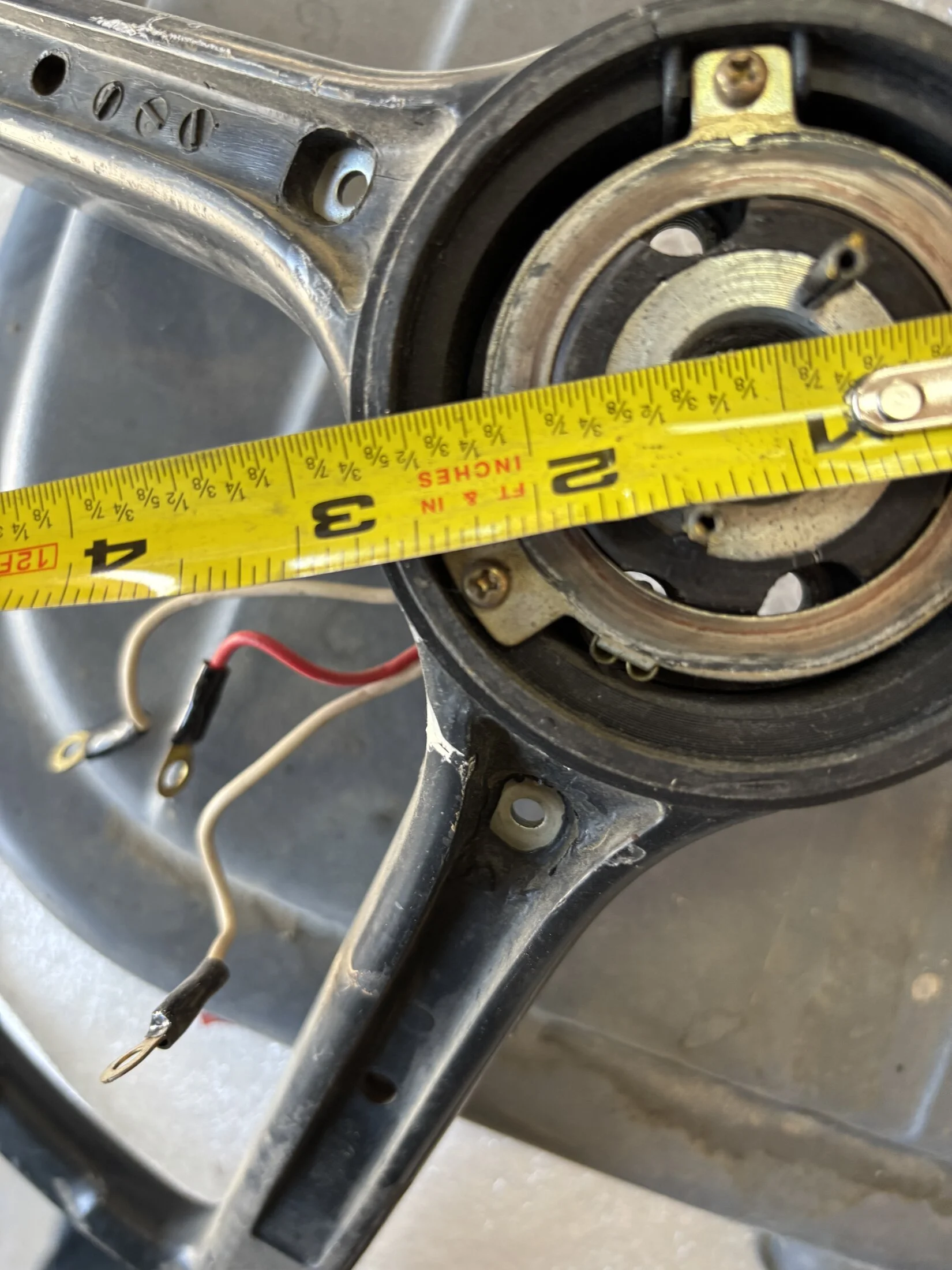

The back of the wheel has a contact ring that looks the same size as the one on the 40 wheel so that tab on the turn signal should match up. The 70 wheel should slip onto the splines and seat against the turn signal switch.

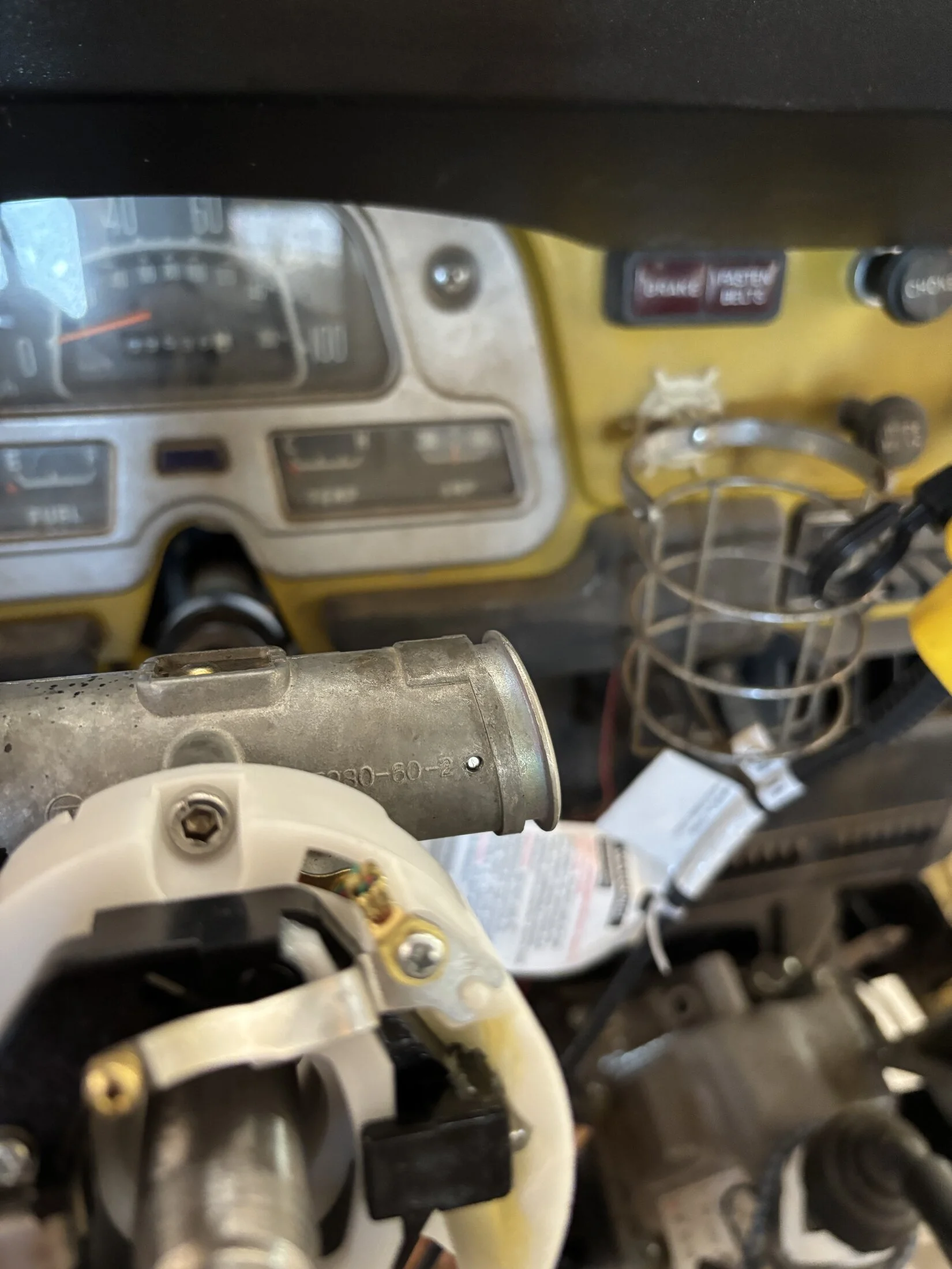

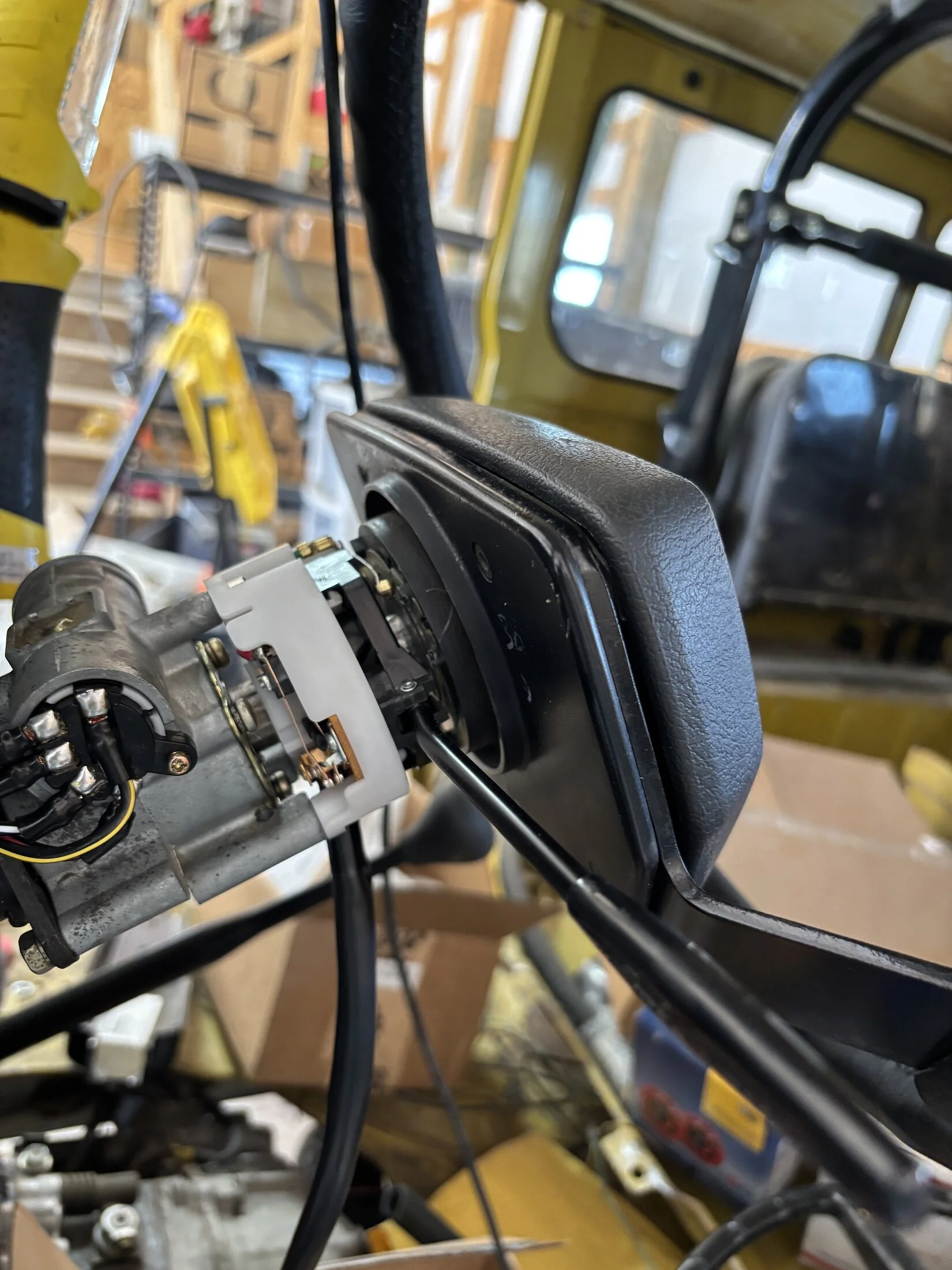

The switch had not been delivered before I left for GA and did not do a test fit with the old one.
Since the truck is 46 years old seemed like a good time to replace the switch before I put the wheel back on..
This is how I left it before I left it before I left for GA. Everything should go back together just fine.
Went to town to get shorter M5-.8 Allen head screws and installed the new turn signal/high beam switch. The 3/4" length were too long so replaced them with 5/8".
Measured both contact rings on the FJ40 wheel and the FJ70 wheel and they are exactly the same.
Looks like I will have to transfer the roll pins or what ever is needed to cancel the blinkers with the wheel.
Did a test fit with the FJ70 wheel and it dropped right onto the splines like the FJ40 wheel does, no adapters needed when using Land Cruiser steering wheels from different series. That was one reason to use a Land Cruiser wheel instead of after market because of the modularity between series.
