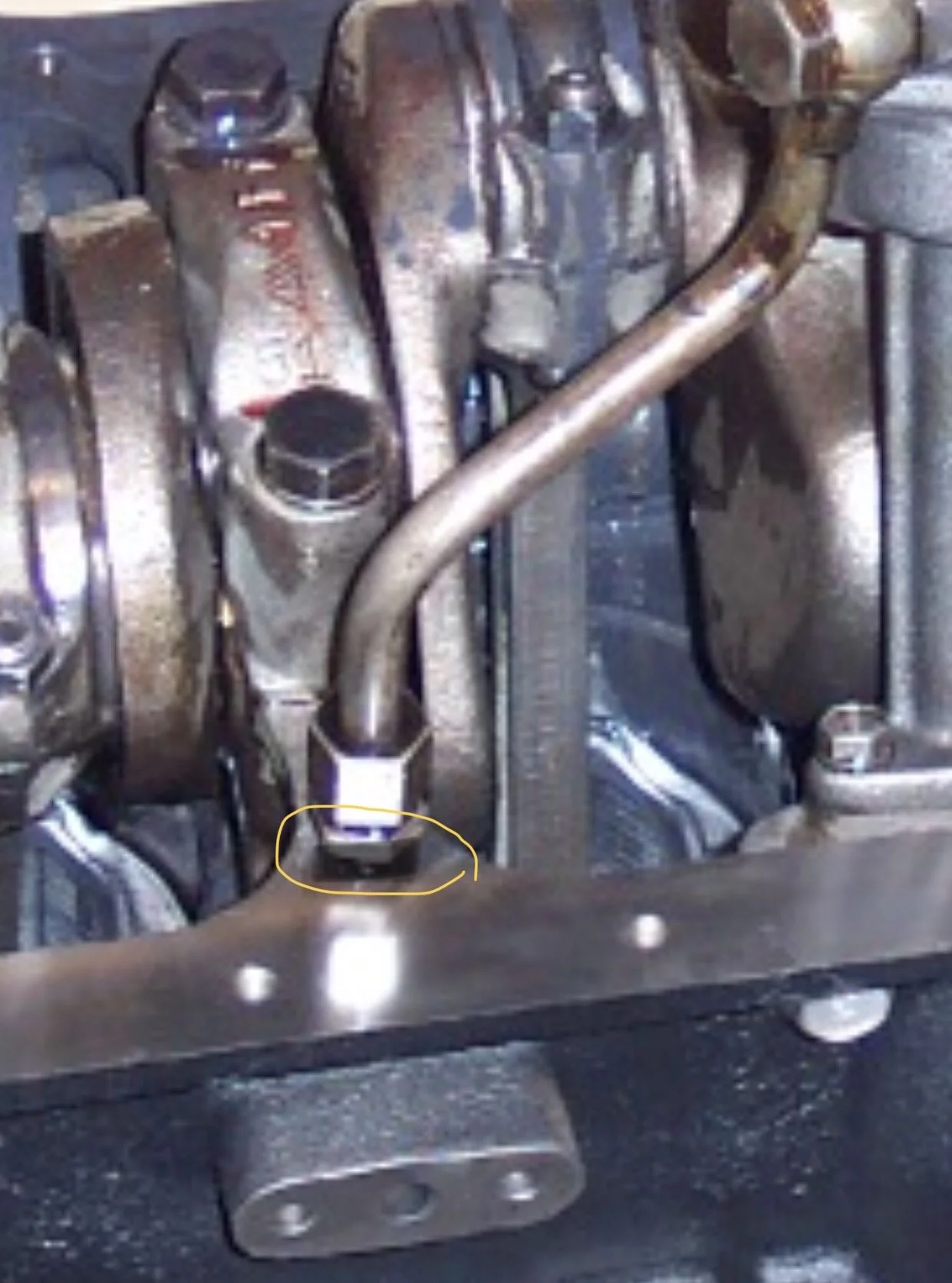

rebuilding my 2F. Went to put the oil pump on and I can’t find the fitting that threads into the block and the oil pump outlet tube..... I have not had any luck searching for it. Ay idea what the pn is or the fitting size or where to order one?
Here is a pic of the part I’m looking for (circled in yellow)

90404-16008 specimen

Interesting it's NLA. Part shows good from 3/69 thru end of the 4x series with F/2F engines. Amayama shows it available but been disappointed by them before. Part is probably available in the Middle East but should be easy to locate a used one. Look for someone parting out a F/2F engine.
