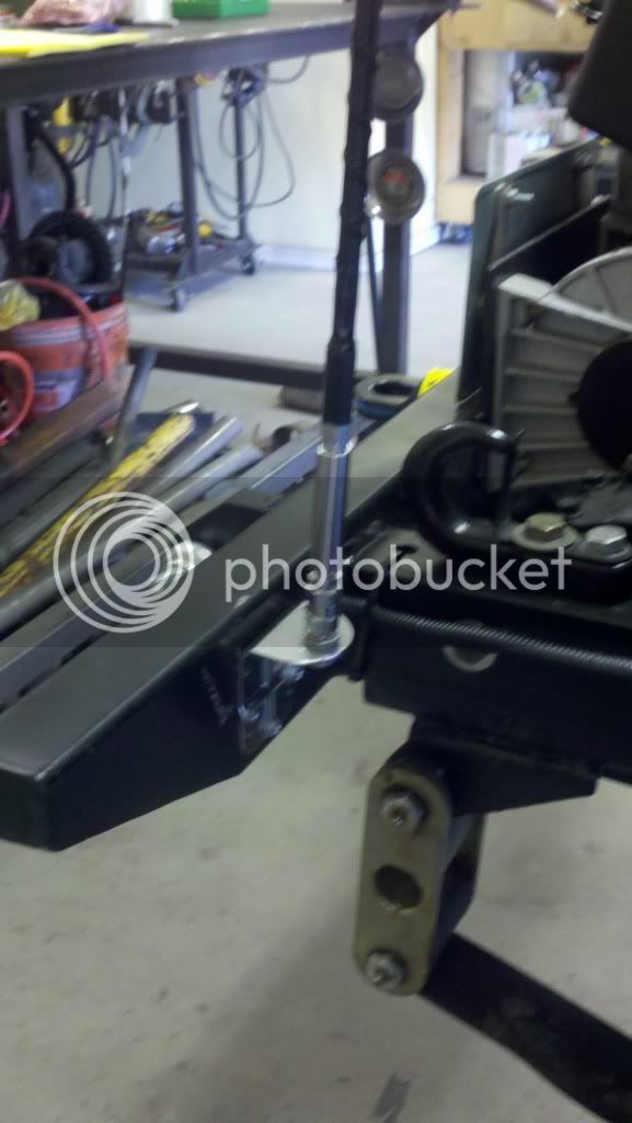

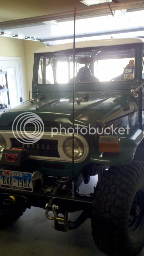

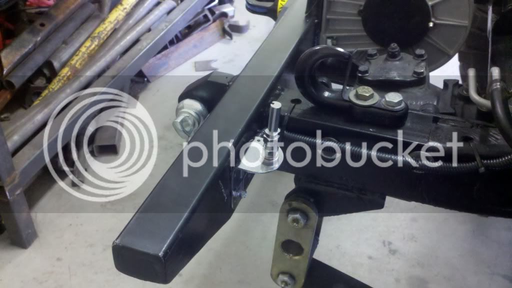

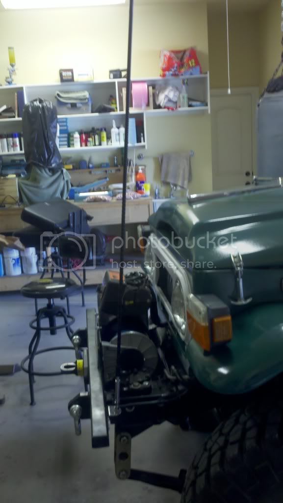

I had originally mounted my 4' firestik cb antenna on my rear bumper / tire carrier on the lower bumper part. It was grounded well but my SWR was crazy high. I finally gave up trying to tune it and took it to a local shop that I bought the stuff from. He told me I had too much reflective interference coming off of the body and that I couldn't mount the antenna on the back of the cruiser unless I moved it away from the body by 10" or more. I ended up having to move it to the inside of my front bumper. The only time I plan on using my CB is trail runs. I don't really like where it is mounted and I have a quick detach on it so I will just run my antenna when I'm trail running and take it off the rest of the time. I wanted to see where you guys mounted your CB antennas?

I took my cruiser yesterday to Clays Radio shop in your neck of the woods, Weatherford. I had about 10" above my roofline but he was saying that due to how close it was to the side of the hardtop (about 3"). I asked him if I could mount it on my jerry can carrier like you did and he said no, because it wouldn't ground properly. He swapped out my 4' firestick for a different model 4' firestik and was able to get the SWR to around 1.3 with it mounted on the front bumper. I just wish it was on the back.
